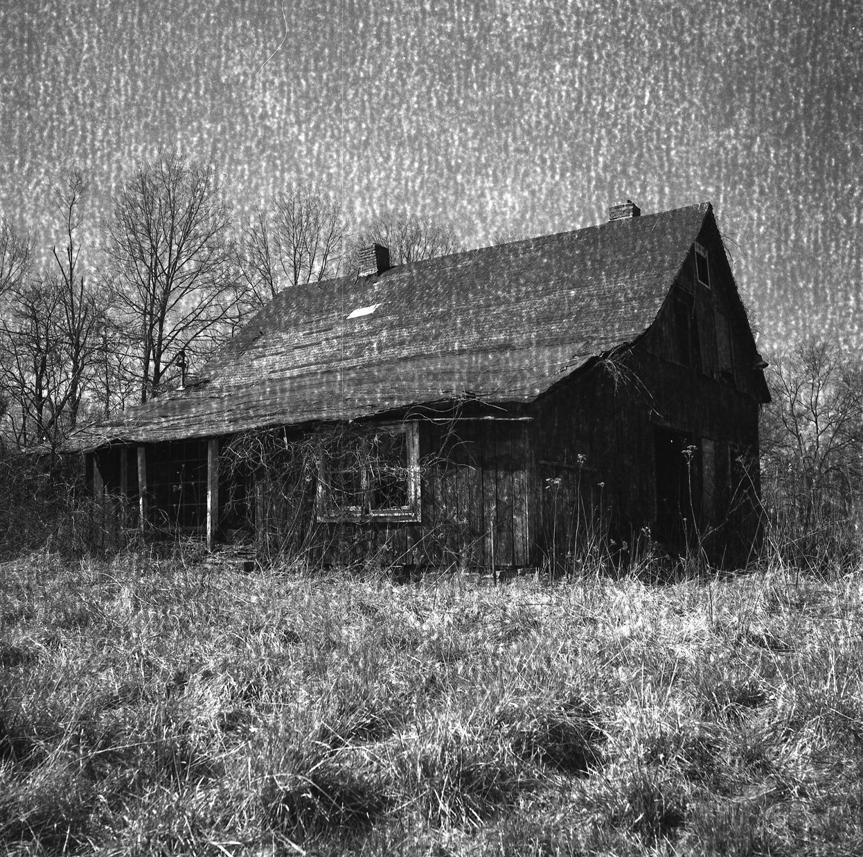

This was FP-4+ after only a couple years stored in my camera pelican case in a controlled environment . . .
Do you regard the pic of FP4+ in #37 as an example of poor latent image retention or is this an example of something else such as it having poor storage ability if left in the camera compared to other films?
Thanks
pentaxuser
Cases like Pelican contain foam padding that isn't entirely stable. In other words, the inside of the case is NOT a stable environment.
So what's the advice or rules about using Pelican in order to make it safe as a case and what other cased have the this kind of padding or is it all case with foam padding need to be avoided?
Thanks
pentaxuser

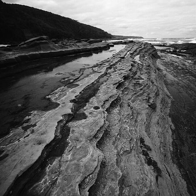

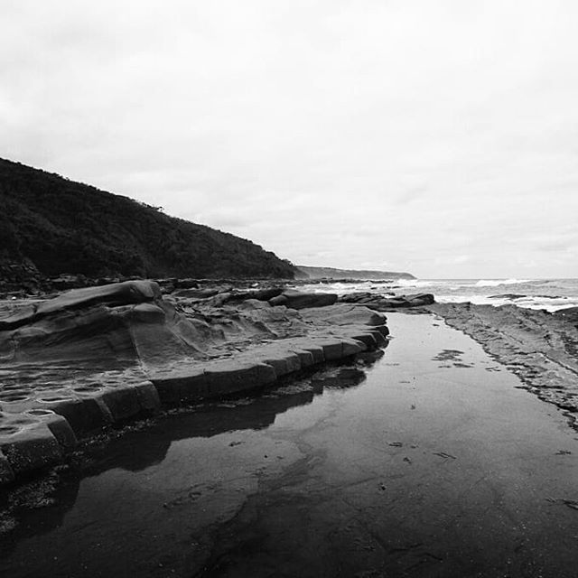

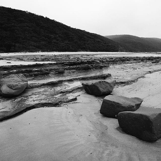

From a 2014 shoot with Pan-F...
One 35mm roll exposed on the day, processed next day with excellent results, printing and framing a few, three of which were sold.
Blanket Bay on a Cloudy Day I, II, III.
___________________________________
Canon EOS1N + EF17-40mm f3.5L

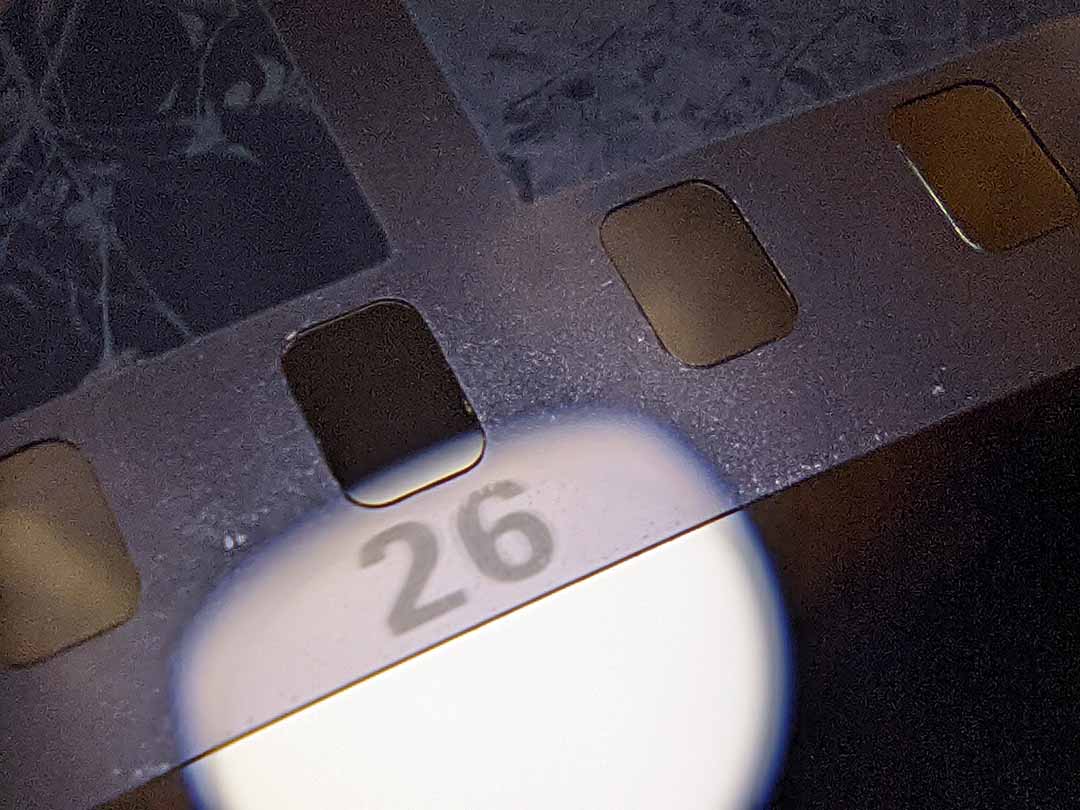

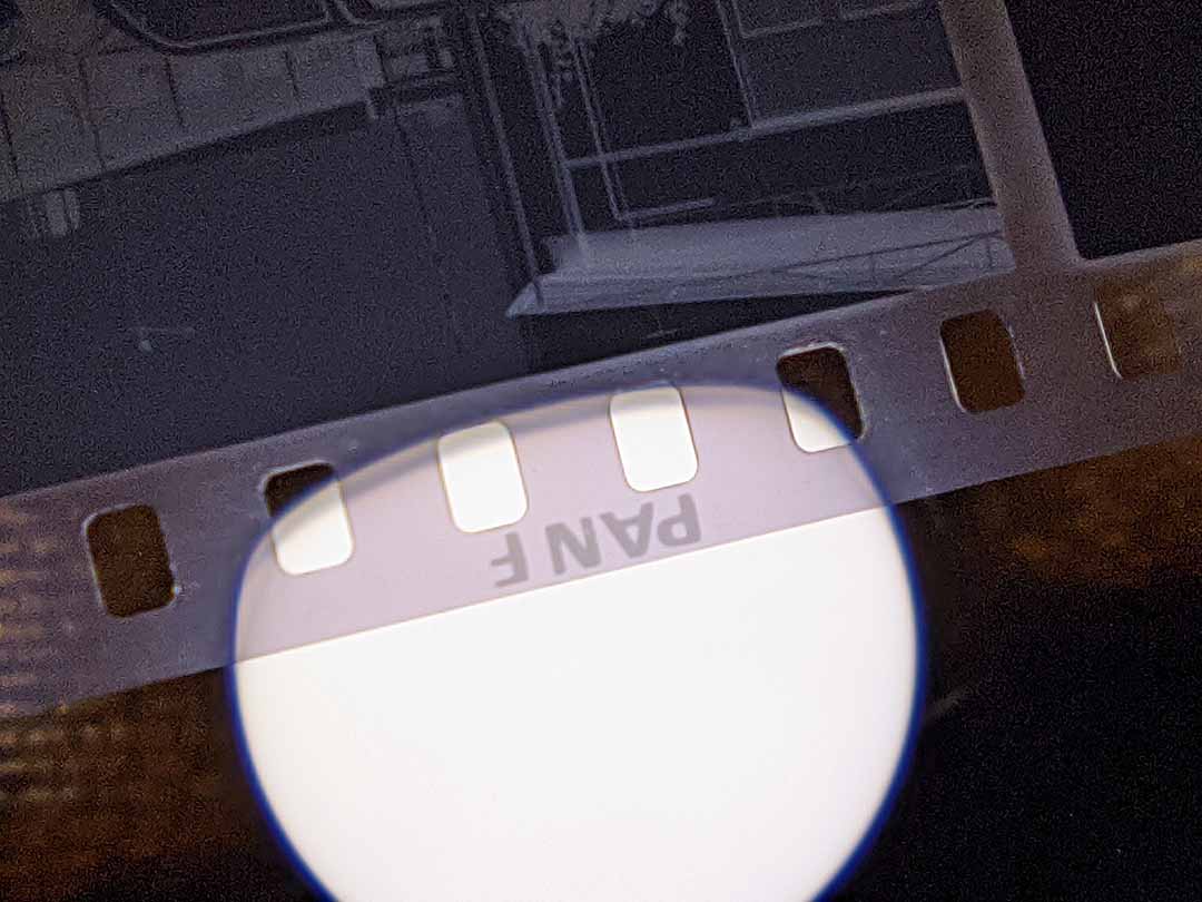

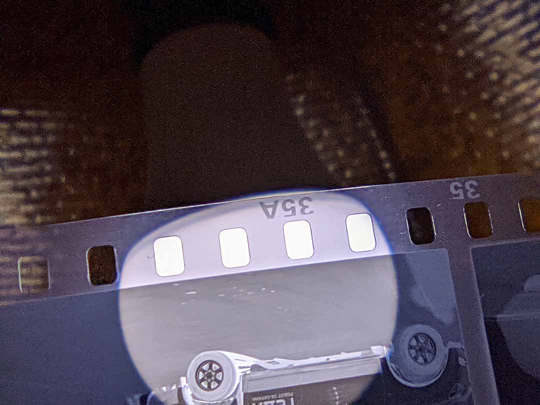

I found some older shots of the edge markings from my Pan F. It's 35mm, left in a bulk loader labeled 1992. Not refrigerated. I don't recall the developer, but development was definitely within normal times. That's why I wouldn't dismiss the latent image outright. Sure, it's faint and won't be great, but there's probably still something there to recover.
