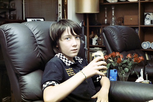

Even if the tread is old, I think this is an interesting topic. Since I had read once the Kodak AE31 paper and some C41 chemicals I tried this a while ago. My main reason for developing the Agfa film in black and white was that it is rather old and has strong red backing after developing due to aging.
As black and white negative I was impressed, nothing like the big grain as described often. A day later I took part of the film and reversed it with the C41 bleach, then re-developed by inspection (tray) under bright light in the usual steps.
Scans of the results below. I did not make RA4 prints of this yet, but looks ok. Not too much color correction on the scan was required.
original scan from the Afga C41 film developed in Foma Retrospecial developer
scan after bleach and normal C41 re-development under light
