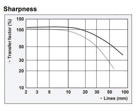

They aren't as good, for much the same reasons that transparencies aren't as capable as negatives - if the scanning/ inversion stages of the negs are done competently. If you're viewing the transparency as the final object, that's slightly different from scanning it in terms of the sharpness requirements etc. I personally quite like the tonality of some films processed as transparency in the Scala process (Delta 400 in 120), so I'm prepared to accept the lower sharpness and coarser granularity.
I've attached a very quickly edited/ superimposed representation of the official Agfa MTF curves' differences between what was essentially the same emulsion processed as a negative (Agfapan APX 100 - the black line) and as a transparency in an optimised process (Agfa Scala 200x - the grey line). The point that matters for getting really critically sharp images in reproduction is where the 50% MTF response is. The RMS grain of APX 100 was 9.0, of Scala 200x, 11.0 - enough difference to be noticeable.
