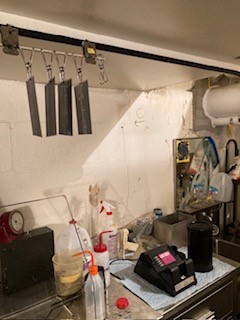

I just finished a bunch of 4x5 with my Unicolor Uniroller. I even tried out 4 sheets at once and survived...i had to improvise a thingy to use to keep film separated. D23 stock 7 min at 20C with TriX got it about N for shadows and N+1 in the sky. No issues with loading the tank, surge or drag. It's a nice workflow with some equipment overlap with 35mm small tank developing. I used a glass stirring rod with these stainless steel cloths pins (google it they are great) and out of the wash to hang. Never tried tray shuffle or green light inspection, but intend to try it out once I get a green light.

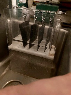

These hangers from Calumet work very well for extended development.

Interesting. Every attempt I made using the Kodak framed hangers had some risk of drag. Only the frameless hangers worked every time.
I'll have to get some of these to try it out.

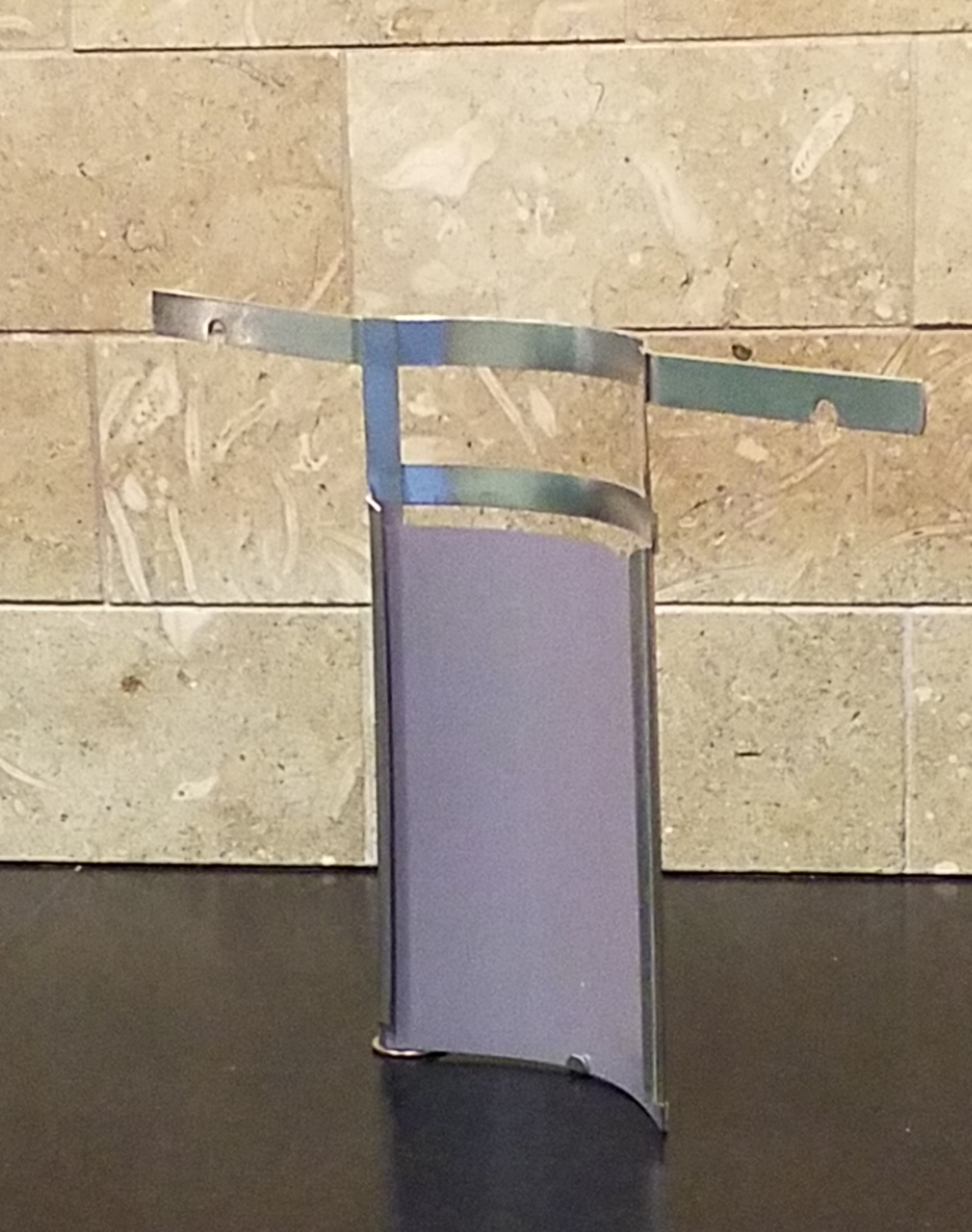

I eventually settled on a MOD-54 in a Paterson tank. I also have a SS Nikor tank, which I've never used.
I only load four sheets into the MOD-54 reel. With more practice I could probably load six, but don't want to spend the time or risk scratching negatives.
I also want to try the Jobo 2509n reel, but haven't gotten around to it yet.
