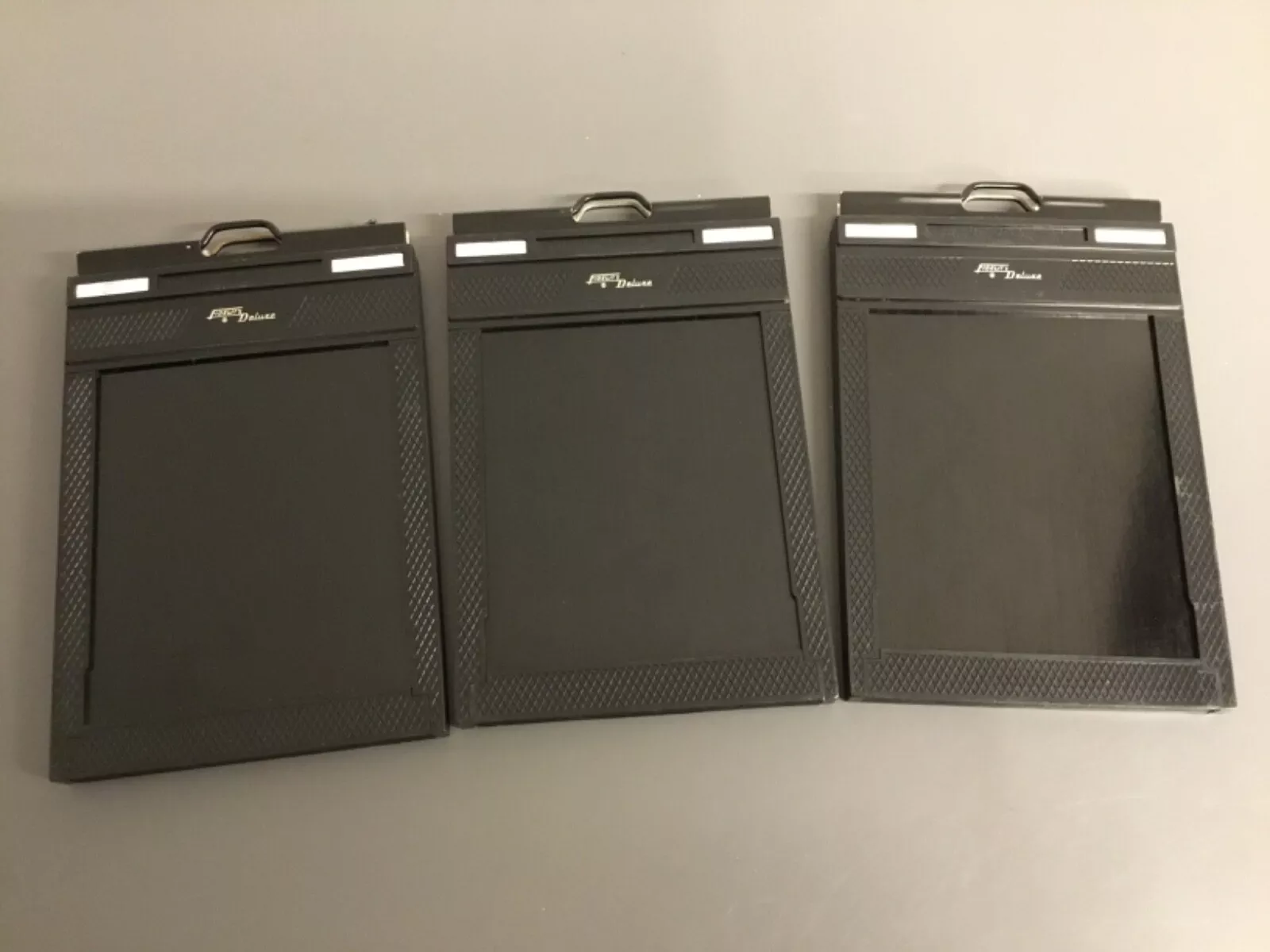

I just spotted AND bought on EBAY ( Church Charity ) these three FiDELITY De luxe holders.......look brand new to me.....£25 post free ($31 to US readers.
Bargain or what🤣
