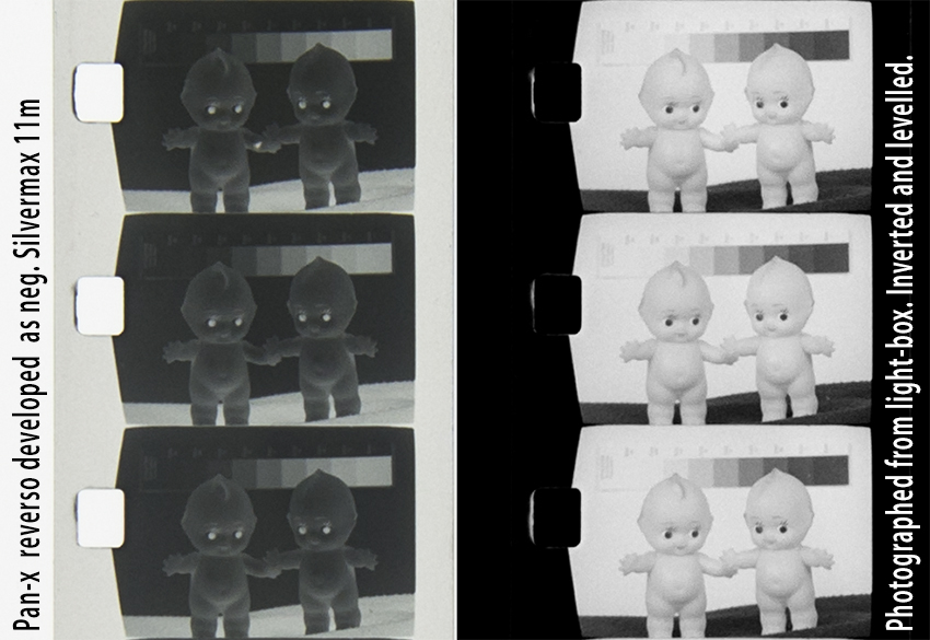

Proof is in the pudding. Pan-x reverso at 100ASA. Silvermax dev. 11m. Photographed crudely from the lightbox and inverted, levelled.
Note. Weirdly, one test strip I ran through is opaque but the image just visible on the emulsion. Could that be an anti-halation layer? Not clear what happened with that one.

I have a bunch of small pre-exposed strips of pan-x from a while back, so I used one of those. I hunched it would be the same dev time as the 35mm silvermax.

As I said I have one strip that from a canister mis-named 'pan-x', that is solid. I re-fixed it as I thought it had not cleared but it made no difference. I have scanned and intensified the dark image on it. I now see that is from a piece of Foma Super 8. So, lesson is that the anti-halation layer on Foma will prevent its use as a negative.
I'm going to scan the Pan-X properly later to get an better image from it.
