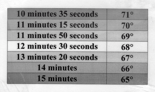

What is your own time/temperature chart, and how did you arrive at it?
This is what I use and the original is taken from a magnified area from a time/temperature chart in an Ilford manual, followed by experimentation by me to determin these times for FP4 in D76 at 1:1
