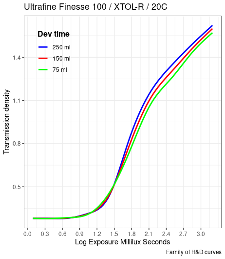

I tested XTOL with regard to the least amount of developer, going from 500 ml all the way to 75 ml of XTOL stock, trying to see what impact the changing amount of developer made. I processed a roll of 36 exposure film, with each frame exposed for Zone VIII. I found a small, but consistent drop in overall contrast when the amount of developer was less than 250ml. Here's a link to that post. Personally, I settled on 250 ml being the least amount of conventional developer, such as XTOL and D-76 that I would use per roll.

I have enjoyed cliveh's photographs posted in the gallery. So the question that comes to my mind is how would a change to an increased amount of developer in his process affect his photographs?
Good question! Likely, no difference at all. Any difference in contrast. as a function of developer quantity, would have been subtle and, likely, compensated for during the scanning process.
As far as temperature is concerned, I do remember testing D-76 in 27 or 28C and got an increase in B+F density. I am going to have to re-test it, as others have found no increase in fog, as in this thread.
I would be very surprised to see similar results with D-76 and X-Tol - the manufacturer's capacity numbers are quite different for those two developers.
And of course a Zone VIII exposure for every frame is a lot different than what might be considered a "typical" roll.
