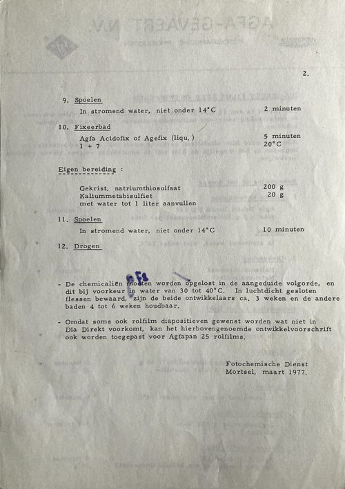

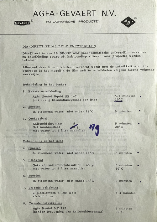

@pkr1979: In my limited experience trying to reversal process TMax 400, I found it difficult to get good results without Thiocyanate in the first developer. However, you might want to take a look at "Commercially Available First Developer Containing Hydroquinone" in this Agfa patent which uses a development accelerator but no halide solvent. pH ~10.2.
Agfa advised to add "Kaliumthiocyanaat" (I don't know the correct name in English) to Neutol liquid (the same as Ilford's PQ universal?) as the first developer in their Dia-Direct process.
I add in appendix the original document, dating from 1977, I got from AGFA long time ago. This was the basis for the process I used to reversal process ILFORD DELTA film which gave very good results (as you can see here: http://www.photoeil.be/books/dieter-roth.html).
The documents are in Flemish/Dutch, please do forgive me not to be able to translate these...

The Agfa formulae above uses Agfa Neutol NE which will be quite close to PQ Universal. Neutol WA is almost identical to the Ilford ID-78 concentrate I mix, which is itself a minor variation of ID062.{Q Universal.
The crucial difference being the presence of a supposed development accelerator in the Agfa formula. Agfa first developer uses PEG which according to @Lachlan Young is the development accelerator that aids in clearing the highlights without needing a halide solvent.
TMax 400 is a difficult film to reverse without a halide solvent like thiocyanate, at least at box speed, no matter what first developer is used. I would use HP5+ any day over Tmax 400 for reversal.

PEG isn't 'supposed' - it's a known development accelerator (Ron/ PE described it explicitly as such) - along with a list of other polyglycols - and the Agfa Scala patent disclosed first developer seems to be very low solvent and engineered to actively prevent development inhibition (very low solvency, no phenidones, MQ balance & pH all point to this - note too that the use of Metol in the 1990s vis-a-vis the recommendation of Neutol (which is PQ) in the 1970s tallies with the emergence of the understanding of the role the Phenidones can play in development inhibition) - and the specific choice of sequestrants may also play a role. It was/ is capable of dealing with TMY-II and Delta 400 without issues & with what seems to be proper speed utilisation/ Dmax. With Thiocyanate or high levels (50g/L+) of sulphite you may well end up fighting a battle between getting sufficient access to the silver & sufficient density before the inhibitory byproducts & silver solvency of these components kicks in - with a low solvency first developer & a gelatin swelling development accelerator, you may have more of a chance for getting good reversals with emulsions that are intended to be more solvency sensitive (to enhance sharpness, control density etc in negative processes).

Commercial developers get reformulated. Neutol NE didn't contain PEG back in 1977. PEG is used in developers to aid longevity, as it helps prevent oxidation of developing agents in concentrates, but it's long been known that Glycols can be beneficial, Agfa discovered before WWII that one long chain Glycol added to Rodinal as a wetting agent had a surprising effect as a developer accelerant. It's in a Patent, which I have referenced here in the past many years ago
Sometimes these Glycols are very weak developing agents in their own right, before WWII both Ilford and Kodak used a very low level of Pyrogallol in their commercial MQ replenished deep tank developers, technically it was an oxygen scavenger.
