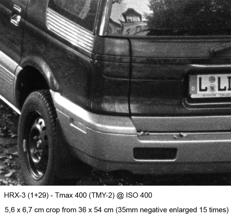

I would classify HRX-III as a first of all sharpness orientated developer in combination with very fine but not finest grain. I developed a test strip of Tmax 400 in HRX-3 two days ago and compared it with negatives of the same scene developed in Perceptol stock and in A49 stock.
I revise my statement. While checking my test I found that I had accidentally taken a negative developed in HRX-3 that was shot at ISO 800. After printing the right HRX-3 negative exposed with ISO 400 I´m absolutely with Ralph: HRX-3 produces the finest grain that is possible at least with Tmax 400. In graininess HRX-3 is the same excellent as A49 and Perceptol are. The accidentally printed ISO 800 negative was considerable grainier and led me to the wrong conclusions.

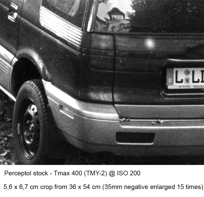

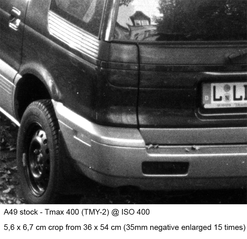

Here are three scans from prints I made from Tmax 400 (TMY-2) negatives developed in Perceptol stock, HRX-3 (1+29) and A49 stock. I enlarged the 35 mm negatives 15 times. So the size of the full prints would be 36 x 54 cm (about 14 x 21 inches). The scans show crops from the 36 x 54 cm format with a size 5,6 x 6,7 cm.

I am liking the perceptol... Never tried it with anything over 100 ISO. Might have to give it another go. But if I have to go below 200 with tri-x maybe not.
