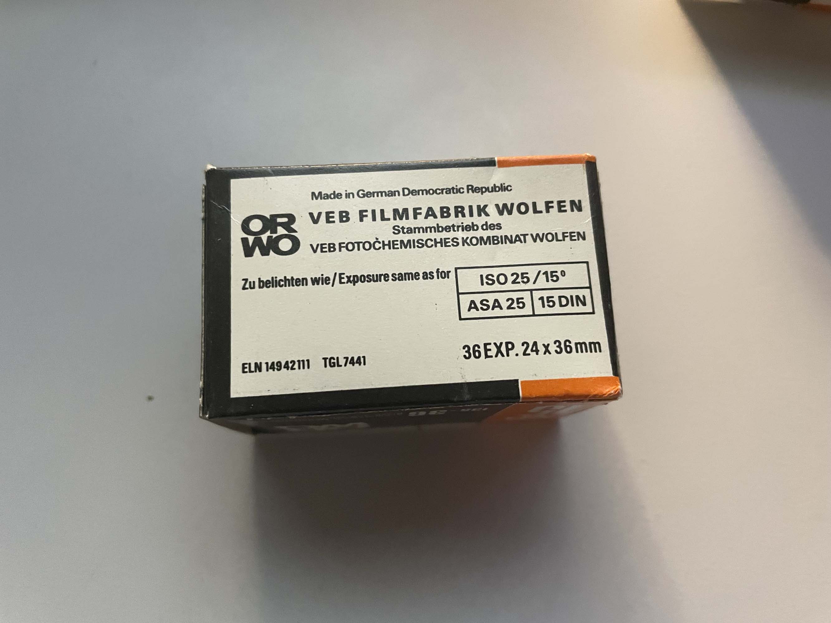

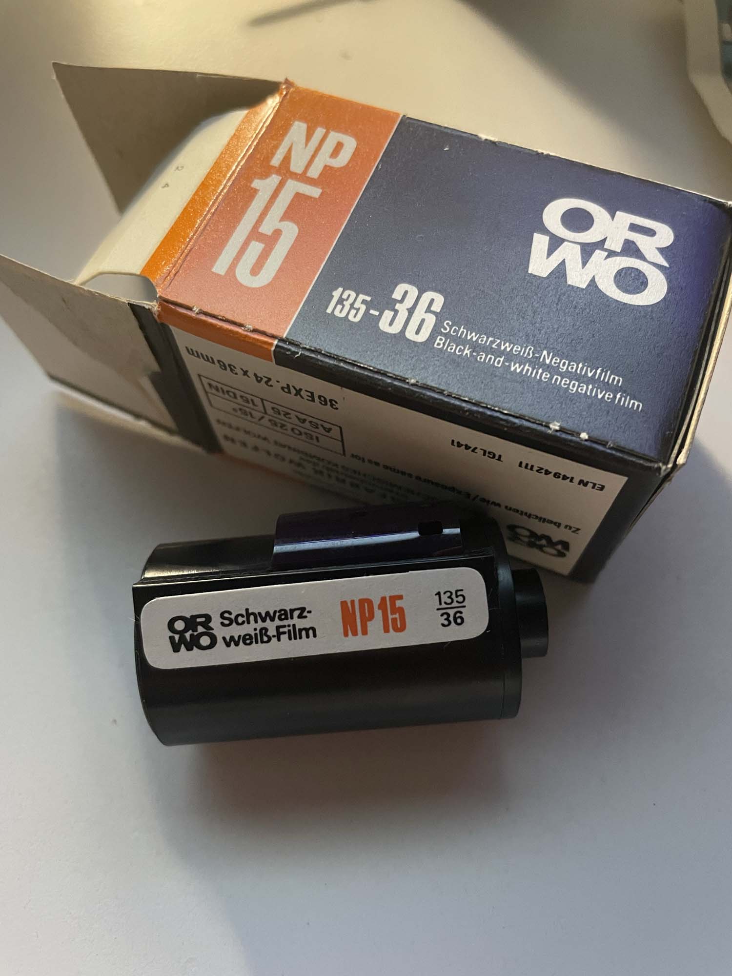

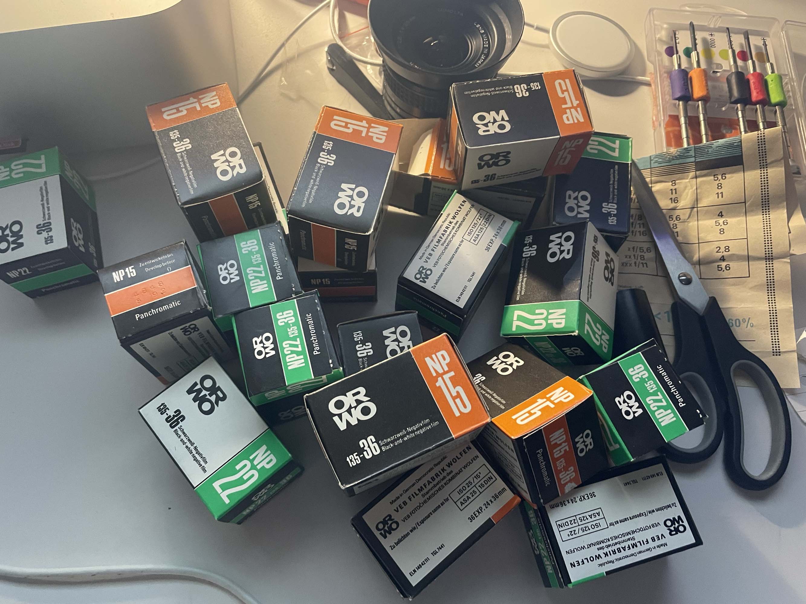

Hello people,
I bought 10 rolls of expired Orwo np22 / ISO 125 and 10 rolls Orwo np15 / ISO 25.
If I'm correct there is no official datasheet for the Adox XT-3 developer right? Should I use the official XTOL datasheet as reference? On the XT-3 package says only 100 ISO devtime 5-6 minutes. Kinda lost on this one, not sure how I should approach or calculate the development time. help appreciated. I saw its panchromatic film which I never shot, looks interesting.
Will shoot a test roll tomorrow, I also have some HC110 left if that helps, but I really wanted to get the fine grain from the XT3.
Thanks.
