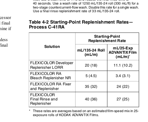

I ran into this chart, but I can't even read it. Does anyone know how to read this?
The figures in parentheses are mL/meter of 35mm film. Most of the big processing companies, trim and splice many, many rolls of film end to end. This is put on a large reel, like movie film for protection and run through continuously, thus the meter figures. Dig around a bit into some other Kodak literature, somewhere they list by 80 sq. Inches which is equal to 36exp, 120, or 8x10 sheet.

So I did the math and it looks like they are talking about 8 rolls here? (After I did math I got 8.8582625) So almost 9 rolls.
So do you think I can just use that to calculate how much solution to replenish? What is the number not in parentheses? That's the amount of needed replenisher in ml right?
But can you please explain the full graph? So I can make sure I'm reading it right. Because I'm not sure.
You can ignore the column on the right. Advantix was an APS film. The number in front/outside of the parenthesis is the volume (in mL) per 24 exposure roll of 35mm film. The number inside the parenthesis is the volume (in mL) per meter of film.
Since you are likely to develop 36 exposure rolls multiply the first number by 1.5. So 30mL of developer replenisher LORR per 135/36 roll of film. But this table 4-2 is for a particular minilab process.
Instead, I'd rather look at table 2-4 in document z131. This will more likely apply to you. It gives you replenishment volumes per roll of film for various types of film. Personally I use (used, I have to restart my colour development after nearly two years break) this table:
There is a group that contains Portra 160 and Gold 200 in the heading. I use that for slower films (ISO 100 & 200). 26.1mL per roll of 135/36. 36.8mL for a roll of 120 film.
The group below (last) I use for 400 and faster films. 33.1mL per roll of 135/36. 37.8 mL per roll of 120 film.
All volumes for LORR type developer. I have the normal Flexicolor developer (non LORR) for example. Table 2-4 has the number for this one as well.

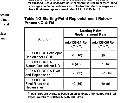

So I made this chart, changed the second column to 36mm
Is this correct? I know I'm bombarding you. Sorry
Yes, that is correct. But as I said in my previous post, I don't think this table really applies to your machine. It doesn't work like a minilab at all.
If this is correct I'm confused. Because I heard fixer and final rinse last a LONG time and can be used plenty of times over and over. Is this not true?
The replenishment rate for fixer in your table could work. C41 fixer is quite efficient, I believe. As a comparism: I started using a simple neutral fixer, which I can buy here in 5L units (Rollei brand) for b/w development. And based on a conservative 16 rolls 135/36 per litre of fixer I've started using a replenishment regime of 60mL per roll now. That is not C41, but b/w chemistry. As I just said, the C41 fixer is is possibly a bit better than the b/w fixer. On the other hand, colour film does require more fixing that b/w.
The table that I use (Rack-and-Tank) is showing 66mL Flexicolor fixer per roll of film. Again I recommend using this table to be on the safe side.

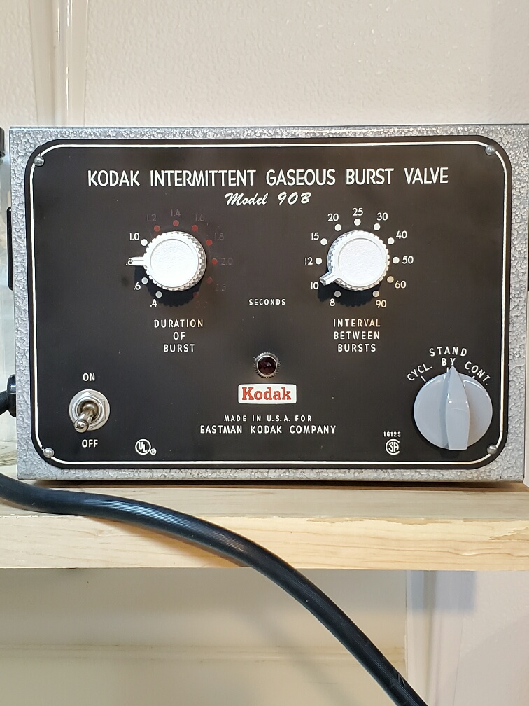

This is the cutting edge of 1960's technology :smile:. This is a timer that actuates a solenoid valve. The valve is connected to a nitrogen tank with a two stage regulator when the valve is energized it let's a burst of gas, from the regulator, through the valve, into a hose that's connected to a gas distribution manifold, at the bottom of a 3 1/2 gallon stainless steel rack. So for color you have several 3 1/2 gallon tanks, fitted into a water jacket that is temperature regulated. For reel film you would lower a rack that would hold 30 reels into the developer tank, every 10 seconds (or whatever interval you set) there would be a vigorous burst of gas that was the agitation. These tanks would take 8x10, 5x7, 4x5 film hangers or print baskets for color paper. As you moved the rack from solution to solution, you would turn a valve that would substitute compressed air for nitrogen, to save money. The bleach air required the air to be damp, to prevent crystals from clogging the gas orifices. All this in open tanks in total darkness, older processes that took forever. Fun!
I'm just setting up a smaller one for fun. 2 gallon tank 7 8x10 hangers

Now, your device is a bit special. The tank is standing still in operation and it seems that there is tubing going in for pumping liquids in and out. Perhaps it is possible to rig something to purge the tank with nitrogen while operating. It might not be worth the trouble, though. It all depends on the economy of replenishment vs. single use. I.e. make new solution from replenisher and starter, process an appropriate number of rolls and then discard, repeat.
There is a user here, Adrian, I think. He seems to operate a commercial service using a Jobo. I read he is not replenishing but using fresh developer for each tank with four rolls in it. I guess it is commercially feasible.
For developer I'm a bit scared to replenish blind, even has a hobby user. I managed to do RA4 prints from my films, so it generally worked. But I can't vouch for the quality. Judging colour is not that easy. I will feel better when I can see if I'm drifting off too much and in which direction. Also in future I will use a Patterson tank. It is like my Jobo tank, but instead of inversion I can use a little stick (that comes with the tank) to rotate the inside back and forth. The spiral will rotate completely immersed in developer and will not draw in (much) air. Also the tank will be stationary in the water bath all the time, which will be better for keeping temp.
For bleach I'm using Fuji minilab chemistry, which I got cheap on ebay. I guess someone had old stock around and bleach doesn't really go bad on its own. I have an aquarium air pump with sinter to bubble air through for reoxygenation before use. And since I bought the temperature control device from Cinestill (a sous vide cooking device really) I'm using the stirrer to draw air in while heating it up. I use mine for a while and then discard and mix new, because I don't have the right dilution and rate for replenishment.
For Flexicolor I'd replenish as in table 3-2 and bubble enough air through in between runs. A lot easier than keeping developer alive.
For fixer just follow the replenishment rate in table 3-2. Fixer can oxidise slowly, but with enough turnover and hence replenishment I see no problem. C41 fixer is neutral and not as prone to crashing out sulfur when unused for a long time. That would be a nightmare in your machine. So if you ever offer b/w services as well, I'd still use a neutral fixer, perhaps even the Flexicolor one. Just in case. Z131 also describes how to test for bleach and fix quality using test strips.
So in a nutshell: For bleach and fix following the table blindly might just work fine. I'd keep an eye on bleach and fix quality. That can be done with test strips and a colour densitometer, at least until you know if it is working stable. For developer in a commercial environment I wouldn't use replenishment without having a system to monitor. Follow the table but test and correct when needed.
