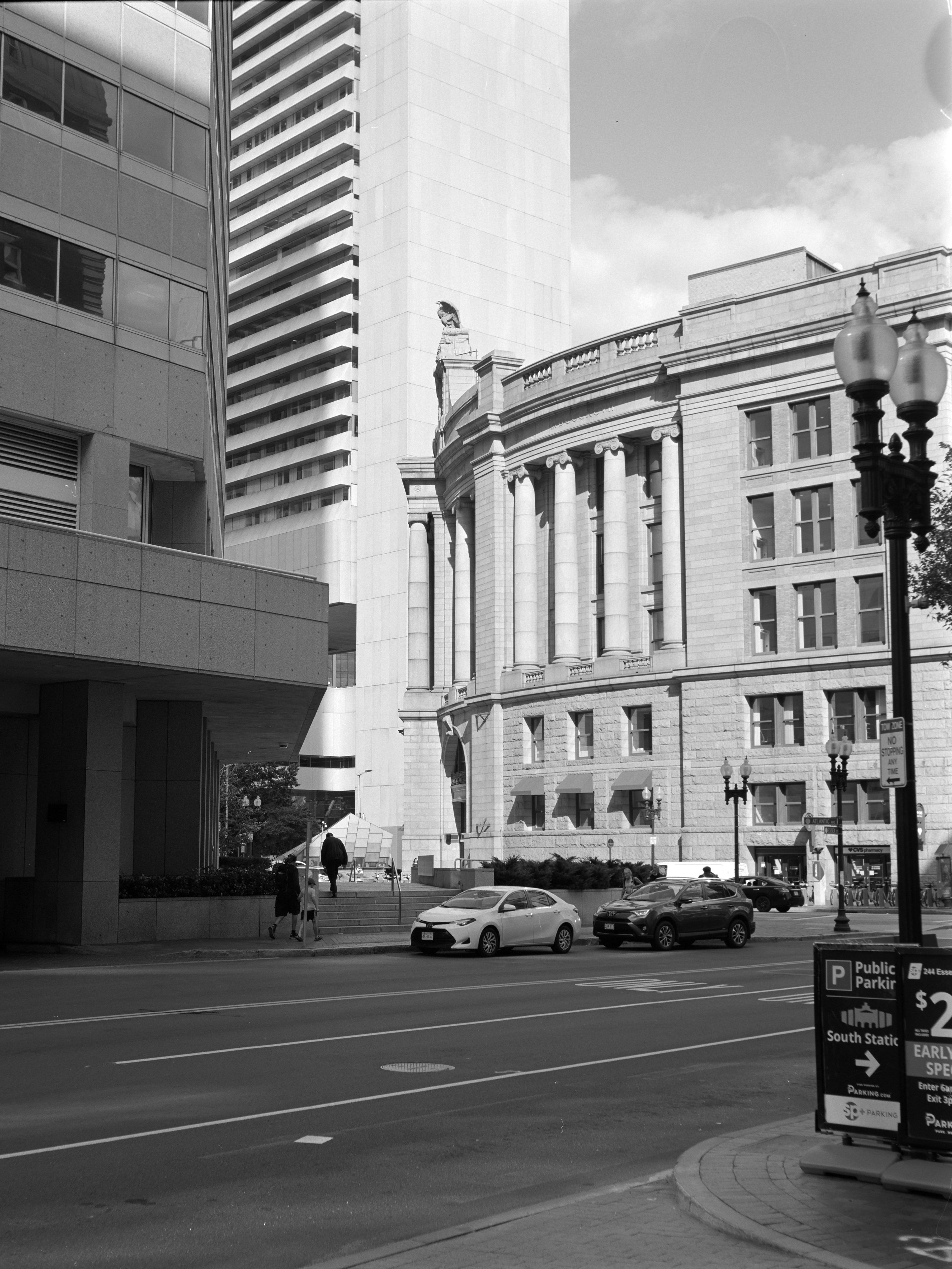

...back to the matter at hand, I've had great results with TMY-2, but still struggle with getting the acutance from TMX that I'd like to see.
Whereas TMY-2 is great in anything once dialled in, with TMX I started with XTol stock, 1:1, and replenished, and more recently FX-39, Perceptol 1:3, and Pyrocat HD.
Although TMX looks great in those developers and has superb detail resolution, I can't get the same apparent sharpness from TMX as I can (easily) from TMY-2 in either 35mm or 120.
(And optics shoulder be an issue: Zeiss glass on 35mm and 120, and Rodagon N's on the enlarger with a glass carrier.)
Any other thoughts?
Take a look at the MTF curves. As Bob Shanebrook has stated above, there are trade-offs involved. Ilford Delta 100 may be a bit sharper than TMX, but there are costs elsewhere.
You could try something like Ilfosol 3 with TMX and see if that helps a bit - however (and counter-intuitively for those permanently welded to the rather out-of-date thinking that more dilution=more sharpness), it really needs to be used at 1+9. PQ developers of the right design, with a carbonate buffer and using powerful organic restrainers like Phenylmercaptotetrazole can be quite a bit sharper than MQ.
TMX looks sharp enough to me.
I think the whole TMX lacks acutance stuff is another of those not quite reality things that seems to have originated early on and became established oral tradition by sheer repetition. It probably had at least something to do with fineness of grain. As we know the subjective impression of “sharpness” is influenced by a number of things.
TMX is plenty sharp - though it's maybe a little less so than Delta 100 or TMY-II's eye-grabbingly high responses in the low frequency range - but I think that trade-off gives TMX its incredibly fine, clean granularity (and it has a very long 100+% MTF response, with all that means for image content transmission) which confounds the (often inherently error ridden) oral tradition about granularity and sharpness.
