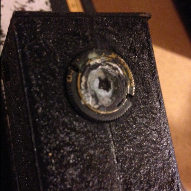

So, how does this thing work? Negatives all ready to go. One note is that the bottom aperture on the little arm seems awfully crusty. I didn't want to start scraping until I knew how it's supposed to look.

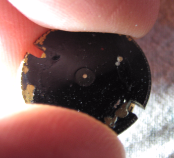

So the bottom aperture, what I was calling the field mirror, is a circular piece of glass mirror painted black on the silver downward facing side (glass side is up). There is a tiny hole in the silvering.
It's removable, there are a couple notches for a spanner.
Once you get it out, you could clean the glass side but I wouldn't mess with the silver side because it is such a tiny hole. I experimented with an ordinary piece of mirror glass where I tried to scrape a similar hole and all I got was something that looked scratchy. So you can see by my picture that the mirror may be covered with speckles, but you can still easily judge when the center patch matches the sample.

Oh that's ugly.
Sorry I was hoping for better.

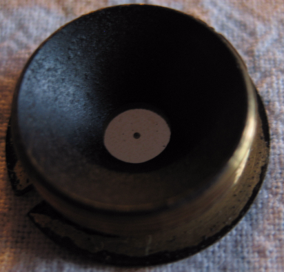

So the "entire view" gets light from the bulb without going through the sample. Light takes the long way around the back, up and then to the front without going through any film. The sample sits on the opal target and a very tiny hole in the middle of the bottom aperture (the ugly thing you show)... lets light through the sample. When the densitometer is dialed to 3.0 the center spot should be very bright and the background dim. (so a 3.0 sample would be dark and both the foreground and background would be equally dark) When it's dialed to 0.0 then the background and spot should be medium intensity because the light has to go about 12 inches either way. Dialed in between such as 1.0 center spot should be brighter than background without a sample. And of course with a 1.0 sample the spot would match the background.
This is what that mirror should look like (top view)

Bottom view
What the heck did you buy? From the photos you've posted should be really accurate and reproducible!

ParkerSmithPhoto got a different one in fair shape with that field mirror in crusty unknown condition. I'm hoping it's just a flake of paint over the hole that can be picked off with Scotch tape on a toothpick.
And don't scrape - just the center dot needs to be open from below. Once you reveal that opening (if it's not incorrigible) - I'd just cover up the rest with a black paint like model paint.
My friend Seth helped me out with the spanners and it appears the entire mirror surface has corroded away. The black is pretty much gone on the other side, too. I have some small plastic mirrors around the house somewhere and I thought I might try drilling a tiny hole in one of them and seeing if that works. I know the glass adds a little density but it can't be too much.

I took an ordinary piece of glass mirror and with an X-Acto blade I scraped a bit with the blade nearly flat to the glass. Then with about 30 seconds of making repetitive short circular strokes I was able to make a reasonable field mirror with a clear hole in the middle. It's really not critical for it to be 1/50" same as the original. It's just nice to have a small circle. It's not even critical to have a perfect shape.
