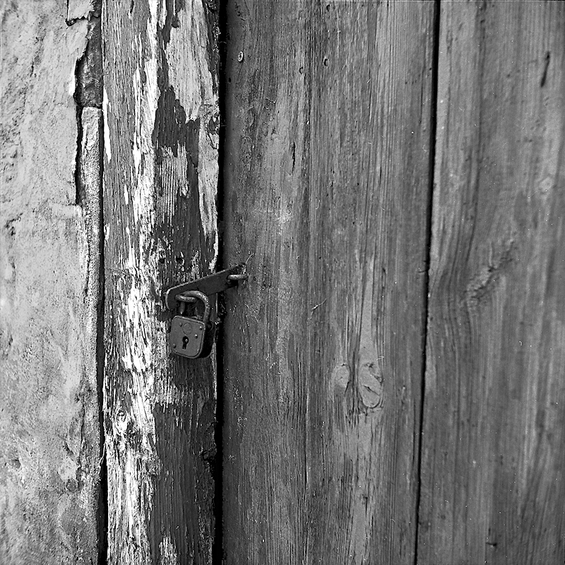

I developed some XP-2 Super in Ultrafin 1+20 last year. It was 120, shot a 70 year old Ikoflex, in snowy and foggy conditions. I metered for 200. The bright part were slightly overexposed, but the shadows were nice. Given enough film and time, I probably would have worked up a system to use it in B$W chemicals.
This was shot Feb 2012, and developed for 13.5 minutes in Ultrafin 1+20. Sorry about my scanning skills, or lack thereof.
