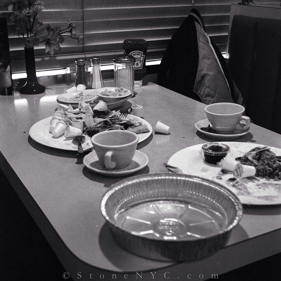

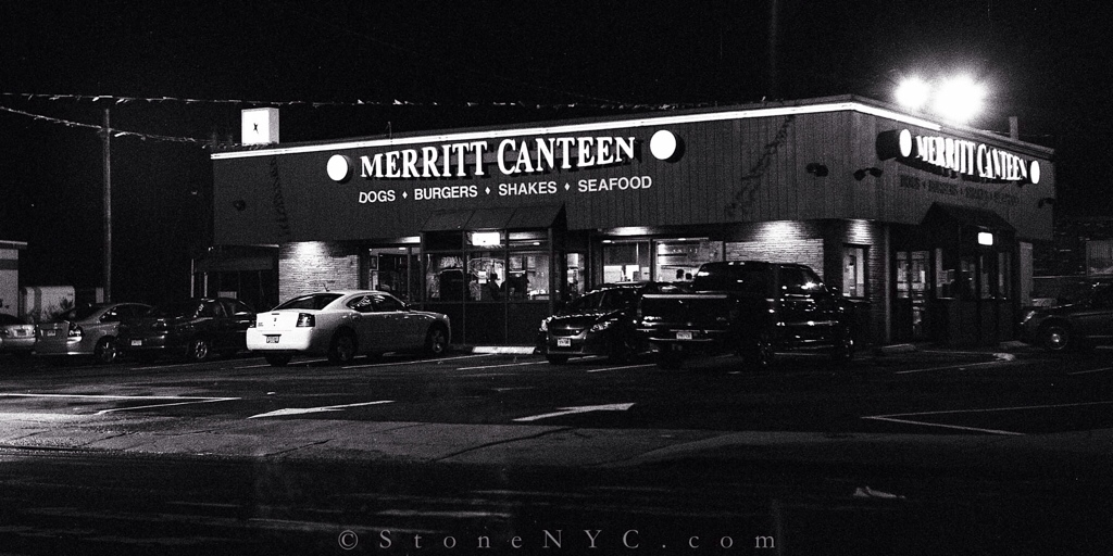

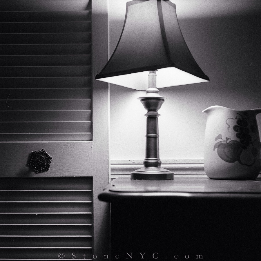

You've seen them on the HP5+ at 3200 thread ... But here... You know I back my stuff up.
Dim diner light
Dark corner with bright lantern
Night exposure hand held
Censored - sunset light

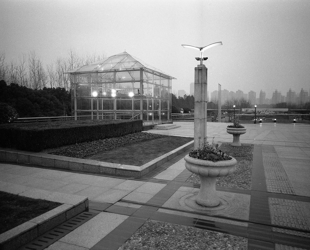

OK, here are my examples. Delta 3200, shot at ISO 1600, developed in D-76 stock solution for 9.5 minutes.
