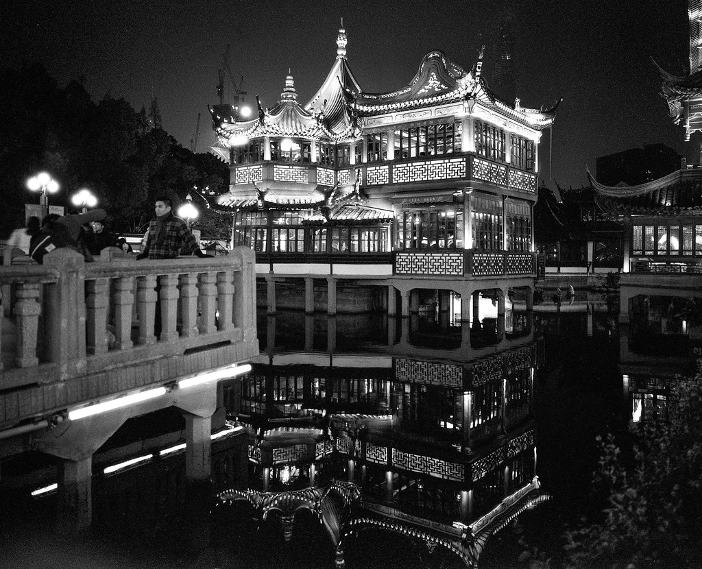

When you shoot at night, it's as though the film's low contrast comes into its own, and scenes such as the one posted by Ratty Mouse is like hand in glove for this film without doing much of anything to the normal times posted by Ilford.

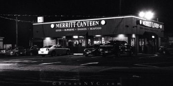

Talk is cheap. Let's see some examples!! :smile:
You've seen them on the HP5+ at 3200 thread ... But here... You know I back my stuff up.
Dim diner light
Dark corner with bright lantern
Night exposure hand held
Censored - sunset light
