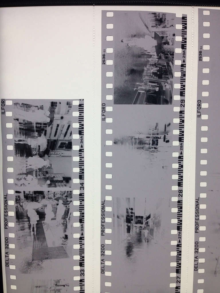

Well, it turns out I didn't fire a singe shot at the dinner. So much for that. Instead I tried it out in the rain at night @6400 developed for 12800 in Microphen. The negatives still came out really thin.
Of course they came out thin, they were underexposed by several stops, still you've compensated the lack of exposure by prolonged development with which you've managed to gain enough contrast so that the blacks look good. I would say the film came out pretty well.:wink:

none of these are worth printing really. I usually do a quick scan to see which I like and then decide if I print. I just can't judge negatives that well yet.
