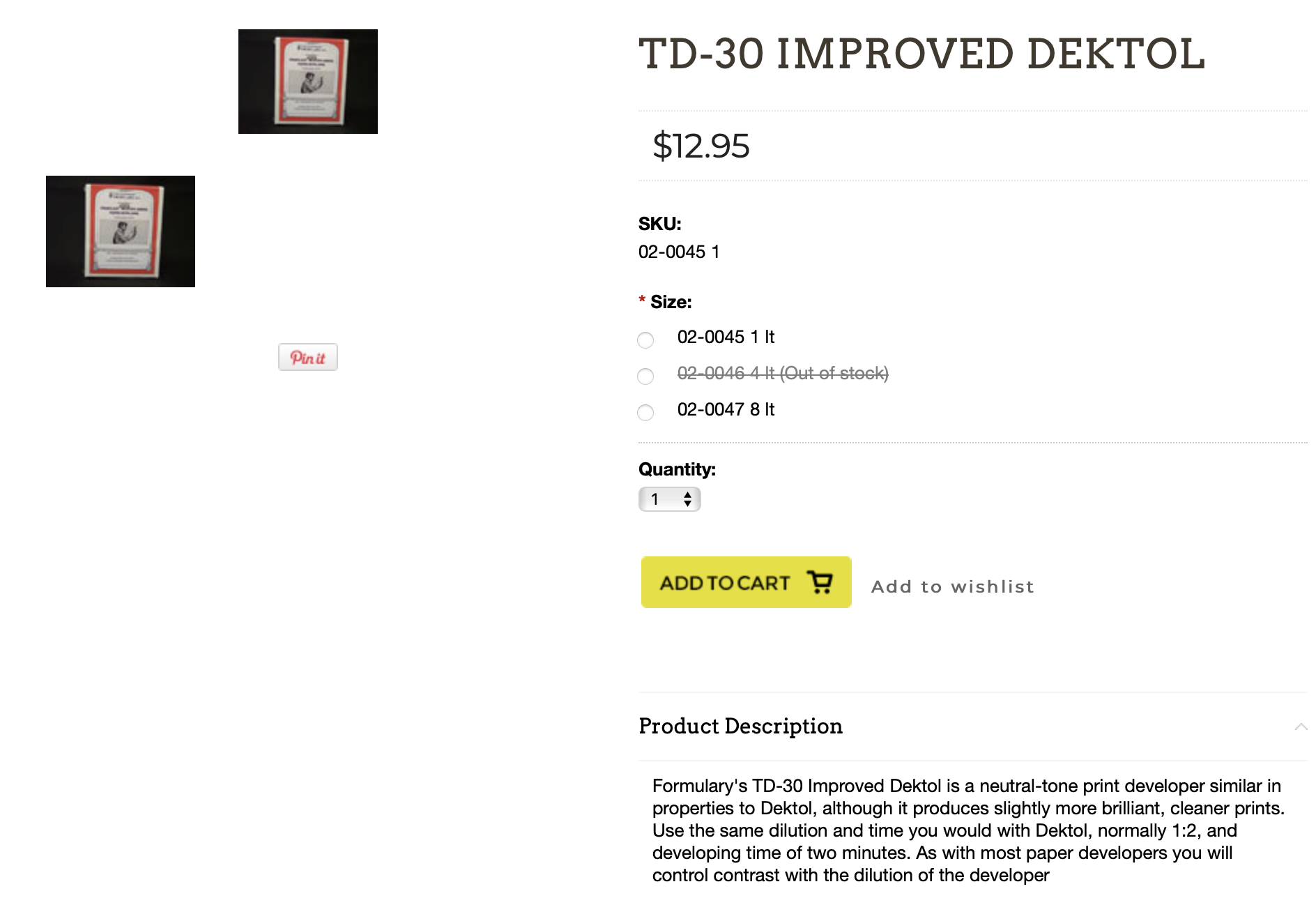

Has anyone here tried Photographer's Formulary TD-30 Improved Dektol?
"Dektol" is a proprietary formula, not sure how anyone can improve it since the formula is unpublished. You can improve Dektol or any paper developer by tinkering with the chemistry. Add potassium bromide to cut fog and warm the print color, add Benzotriazole to cut fog and cool the print color, add a little sodium carbonate to make "snappier" prints. The description of TD-30 actually sounds a lot like the "blurb" for the old Zone VI paper developer (which was "just" D-72).
