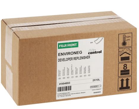

Local supply varies massively across the planet, but I'd be surprised if you couldn't beat this price by a mile. Around here, 10l of Fuji C41 replenisher (which makes 12.5l of developer) costs something like €60. That's the smallest minilab quantity you can buy.
Kits of 500ml, 1000ml etc. are of course relatively speaking far more expensive. If you're cost sensitive, those kits aren't the best choice.

It was the low prices of Fuji C-41 chemicals that encouraged me to give up experimenting with my own C-41 developer.
In Poland, 10 liters of Fuji Hunt C-41 developer costs 177 PLN, and this price includes 23% VAT (we have one of the highest VAT rates in Europe). 177 PLN is equivalent to 41.60 EUR. I also had to buy a 1 liter starter for 90 PLN (21.20 EUR incl VAT), but this starter will probably be enough for about 66 liters of working solution. This chemical is manufactured in Belgium. Poland is many kilometers away, and I am sure, shipping the chemical isn't cheap. I don't understand why in the Netherlands, Belgium's direct neighbor, is so much more expensive. I understand that a Dutch seller has to make money, but the wholesaler where I bought it in Poland also makes money. And Polish sellers really do not spare their customers.
