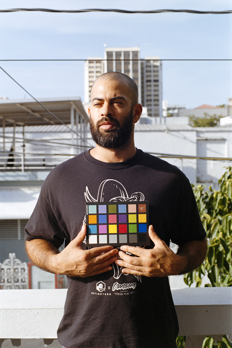

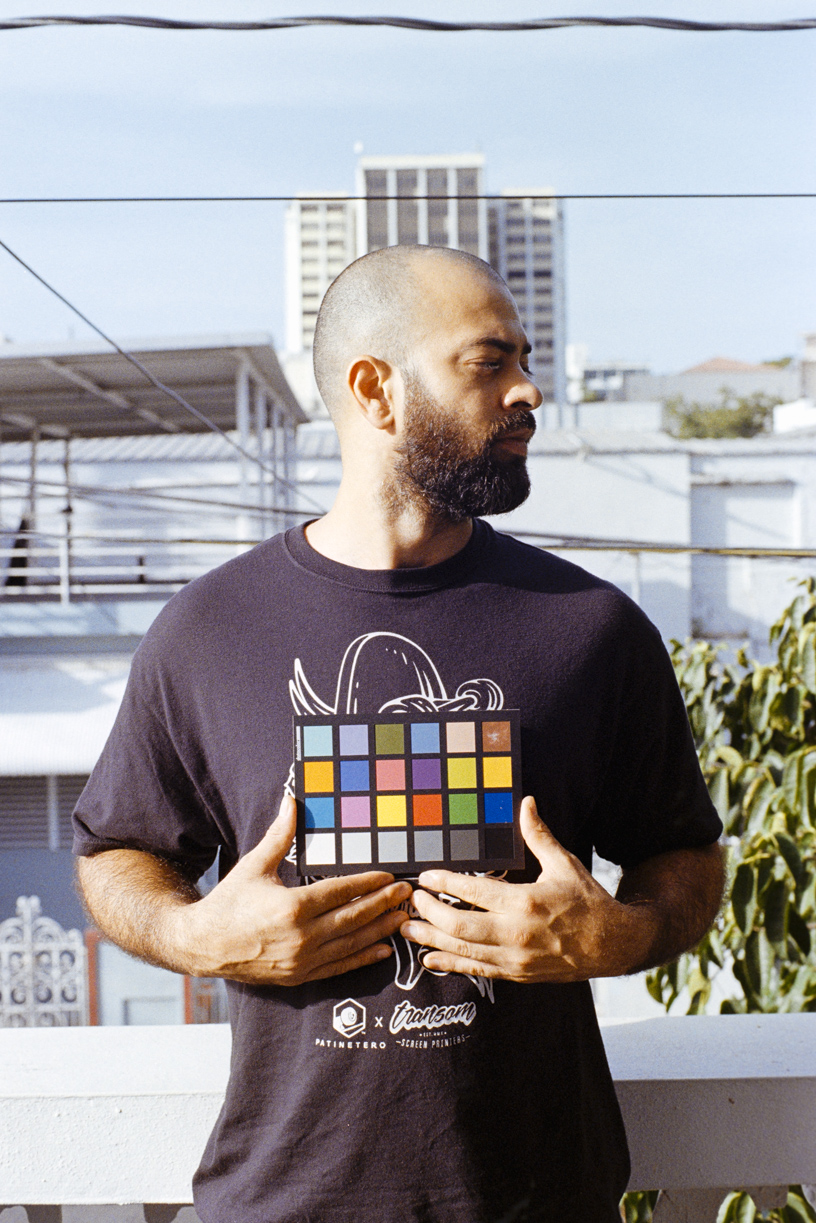

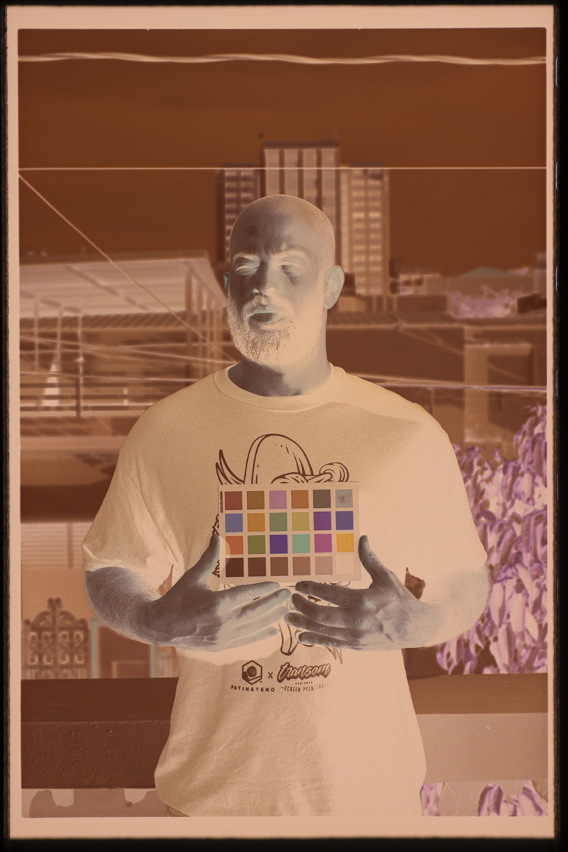

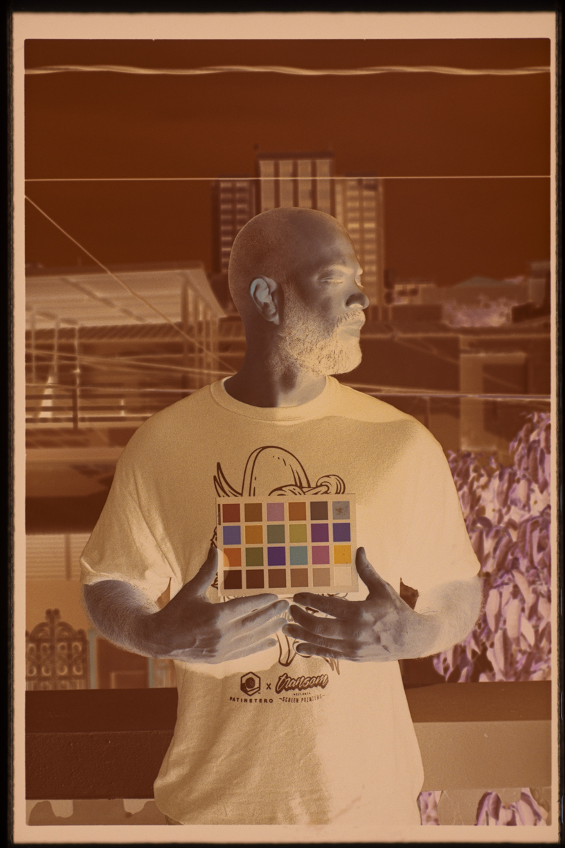

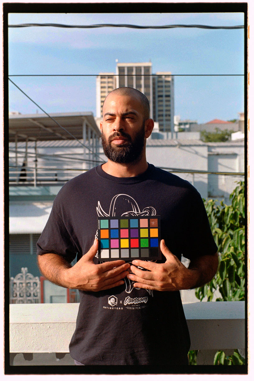

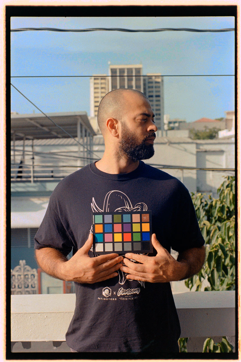

Update:
I mixed a new batch of homebrew c-41 (same recipe/method) and compared it more qualitatively with test negatives from kit c-41 developer. This version is certainly better, but the deficiencies are still obvious in the same ways. I am wondering if perhaps my CD-4 is slightly oxidized and perhaps another .1g or so would push it closer to par with the kit chemicals. Both developers are testing at pH 10.2 with my meter.
I should note that the "control" kit developer was not fresh. It has had 18 rolls run through 1.5L and "replenished" with itself at a rate of 30ml/roll. This replenishment method is insufficient to bring the developer back to original strength, but I've already discussed this somewhat haphazard method on another thread so not much need to go into it further here. This developer should still give a decent control for the purpose of this test. I will re-test in fresh when new developer arrives and judge the differences, which I am also curious to see.
Scene was shot in warm evening light at f8 with Kodak Color Plus film metered off a gray card. We can see in the color chart that the reds and greens are still under-saturated, and the film base is more yellow. The HB negatives are also thicker, despite receiving 15 seconds less time in the soup. So the developer is more active and yet not fully penetrating all the dye layers...?
I can't rule out weighing errors entirely, but since RPC was comfortable rounding measurements of a few of the ingredients in his formula, I don't think the .03g inaccuracy my scale sometimes exhibits would create such a strong variance. Except maybe in the tiny amount of sodium sulfite? Could +.03g restrict the developer to this degree?
***FYI Conversions were done in NLP with no edits applied/auto white balance. Not a 100% accurate method because the algorithm compensates for irregularities, but perhaps koraks con help us out with a more precise conversion to really see what's going on.

I've been eagerly awaiting the results of your tests in the new bath. Honestly, it's much better than before. I have one suggestion: I see you're scanning with a Nikon D810 digital camera in the ADOBE RGB color space. I saw this information in the EXIF data after downloading the photos to my computer. From what I understand, NLP strongly recommends that the files be in the sRGB color space. This can also affect the accuracy of the negative-to-positive conversion.
Using Photoshop, I converted the color space of your JPG files to sRGB. Then I saved them as TIFFs and inverted them using the free Photoshop plugin Grain2Pixel. I didn't make any color corrections at all. See my conversion results attached. They look slightly different than yours in NLP.
Wow, I'm amazed I have never seen this guideline. What an oversight. I will adjust my settings and see what difference it makes. Thanks for the tip.
I'm seeing a strong yellow color anomaly in the sky of your conversion of the HB. The information looks like it's clipping, maybe an export quality issue? I don't see it in the negative.
Overall, I'm not surprised the different conversion methods produce varied results. Aside from that nasty yellow streak...

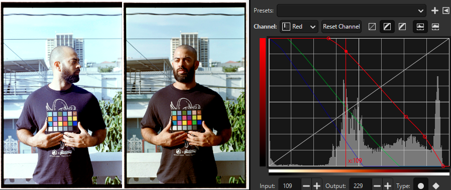

Yes, you're right, the "home brew" has a yellow tint in the sky (especially in the clouds). As I mentioned, I didn't make any color corrections. Only the Grain2Pixel plugin had to make adjustments. I worked on a compressed JPG file - this also introduces additional variables... But my subjective opinion leads me to think that I like my conversion of your photo developed in HB the most. Of course, this is just my humble and very subjective opinion. 😇
Also, remember that web browsers don't handle Adobe RGB color reproduction very well. The standard online is sRGB if you publish your photos. Always convert to sRGB because people view photos on different monitors, and besides, as I mentioned, browsers sometimes go crazy with a wide gamut. Even with a decent, calibrated monitor, everyone sees colors differently (if they are in a color space other than sRGB). And this is important if you want to see other people's color assessments of your photos.

The HB photo appears to have a light yellow tint across the entire image. Color Plus being a very "warm" emulsion shot in very warm light could add to this effect across both images. A factor to consider. I'm most concerned about the strong yellow blotch in the sky, and confused as to why it would appear in your conversion and not mine. Probably not an artifact of compression since it does not appear your kit chem conversion. The other differences in the conversions are mostly density and saturation, but that streak is more objective. It's either present or it's not...I am inspecting the negative closely and do not see any discoloration that would correlate with how it appears in your conversion. Strange.
Only way to discern this is with a manual conversion.

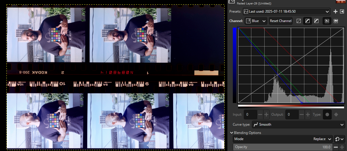

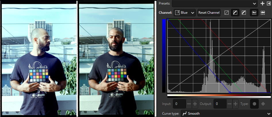

This would start with photographic both negatives side by side in the same shot. Only then a meaningful comparison can be made. Something like this:
Assuming that the negatives were indeed photographed with the same exposure settings (ASSUMPTION!!!!!), a qualitative comparison would come out like this:
That's a very quick & dirty inversion, straight linear with no intention to make things look good. It's just the same linear curve adjustment applied to both images. Again, ASSUMING the negatives were photographed in the same way, it's clear that the one on the left has more density and thus ends up much lighter. It also seems to lean towards cyan more so than the one on the right. Again IF this is representative, we can take from it that the problem is definitely not a lack of activity in the homebrew chemistry - in fact, it's the exact opposite: the homebrew chemistry seems to have been more active.
Then again, if the photos of the negative featured an aspect of auto-exposure that would have spoiled the broth, all bets are off.
I'd also like to focus your attention on this issue here: I've tried to color balance the KIT shot to something similar that you got from NLP, and applied the same curve adjustment to the other negative:
I hope this drives home the point that you CANNOT use NLP conversions as a basis for comparison. Don't ever, ever try to do that, because you're going to get lost in the woods with no chance of recovery. Such a comparison is totally meaningless; as you can see, tools like NLP give a creative spin on an image that may be pleasing, but any consistency goes out of the window.
Not 'slightly', they look totally different and your conversions also don't allow for a consistent comparison.
It's fine to experiment with different ways of negative inversion/color balancing for final output, but when trying to troubleshoot a color process, please be very careful.

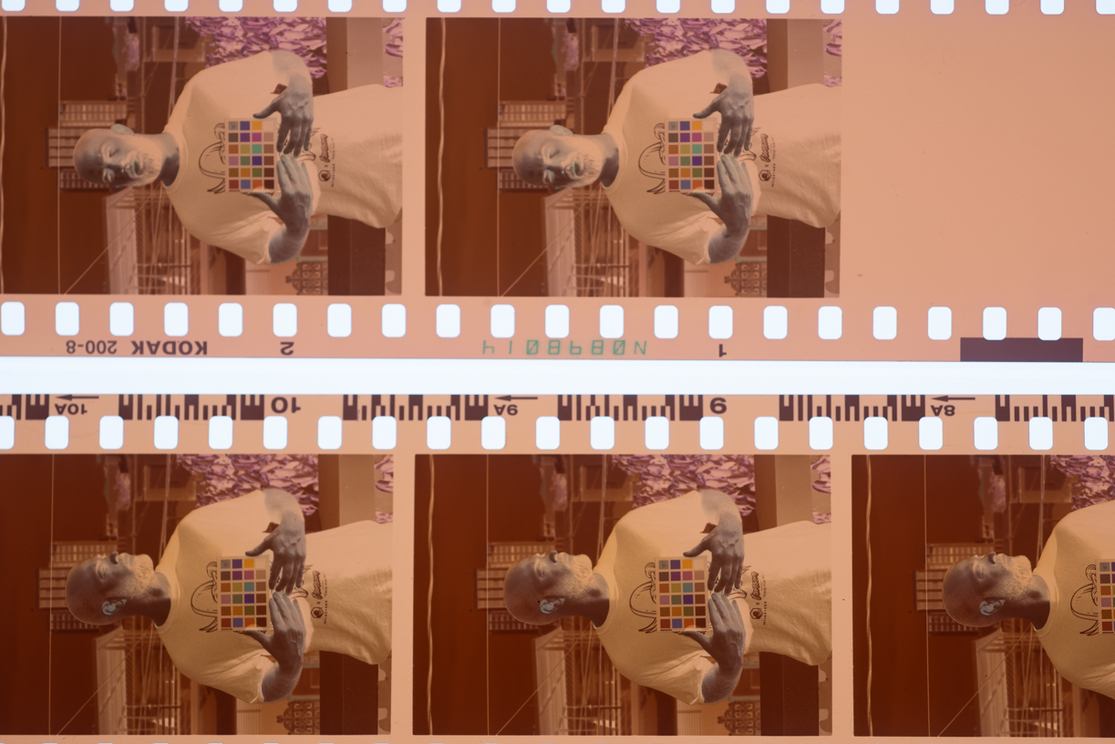

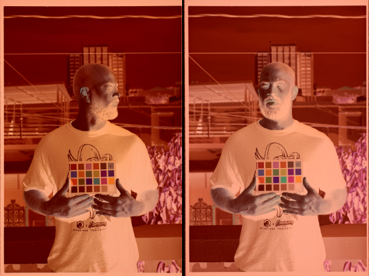

@originalwinslow can you please photograph these two negatives in the same shot on a light table and post the result? Only then can we start with the comparison. The above is just an illustration of everything that can (and in fact, does) go wrong in the digital part.
I should have included this from the start, here is a side by side (shot/exported in SRGB).

Yes, the reference images were shot on manual settings in the span of about 10 seconds to reduce the chance of any fluctuations in the natural light (cloud passing etc). They should all be almost EXACTLY the same exposure, as much as is possible outside of a studio lighting scenario.
Ah, thanks; I meant the photos of the negatives though, but the 'scene as shot' conditions are definitely relevant, too. Thanks for the follow-up on that one as well!
NLP is used here as a basic reference for those who may also use the tool
It's not useful in that capacity. Sorry about the chastising; I know I've been very firm in my admonitions in this respect - deliberately so, although please don't take it personally.
That being said, the difference in the red saturation/hue is similarly visible in your manual conversion vs the NLP interpretation.
Yeah, but as you can see, in reality, NLP twists a couple of things into entirely random directions that really don't help in troubleshooting the chemistry.
Thanks so much; it's really interesting - have a look at this:
This is a bit crude, but the principle here is to see what the qualitative differences are. The pattern we saw before still holds, but the density difference seems to be much less than in the earlier version posted, so it really does emphasize how important it is to photograph/scan the strips side by side. One caveat is that the photo was a little underexposed; the blue channel clips esp. on the bottom strip.
So overall the balance of the bottom strip is decidedly more cyan and more blue. The top strip is more red and more yellow. What's also interesting is that the top strip has a higher base density and this moreover seems to be uneven as well. There's a dark blueish grey band running along the center of the top strip; the edges look cleaner. This may be an artifact of the digital capture of the negatives (some flare), but it's something I'd have a closer look at if I were you to determine if there's perhaps indeed higher base density in the center of the top strip. If so, exhausted bleach and/or fix may play a role in this. Which would still not explain the color balance difference.
I don't have any other or better explanations yet than what we have discussed before, although your recent example does seem to suggest that the problem was not a fluke. There's a consistent difference between your commercial chemistry and the DIY approach. The question is still which one's the right one. Given what you said about the commercial stuff being reused + replenished, there's a very good chance that your DIY chemistry is actually performing closer to spec at this point.
If someone is strong in their convictions it's oftentimes for a reason, no offense taken.
Both are possible. The fixer was close to exhausted in that dev but still within acceptable range. My scanning setup is also not *perfect* with flaring. Something else to dial in.
***EDIT I just realized that I have negatively affected the comparison with a bad scan. I don't know why this didn't occur to me before. I did not scan the side by side in an entirely dark environment, and the strong ambient light in the room certainly affected the output. The other scans were done properly, but it is likely hard to critically judge color with the ambient light affecting color balance etc. Both negative strips have the same ambient light falling on them so judging differences between the two is still valid, but judging overall color balance is likely out the window. Regardless, the final conclusion probably stays the same.
That explains a lot; good catch! And yes, it influences the outcome, but doesn't change it fundamentally.

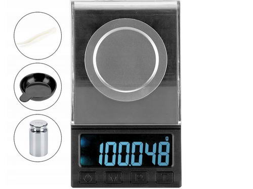

Probably prudent to just buy a more expensive scale and eliminate any measurement errors as a possibility.
Scales, which resolve 1mg, are not "more expensive". You will need such a scale anyway, so you can accurately measure the iodide. I use two scales, one, which goes up to 20g in 1mg increments, and one which goes up to 500g in 10mg increments. Both were really really cheap (read: less than US$20) and last for many years.
This is one of the issues with well reputed but old resources: they make a big fuss about things which are non-issues today. "You need an expensive scale which can measure fractions of a gram" LOL. "You need an expensive densitometer, ideally one for color" LOL. "Here are five recipes, which will cover your dark room needs" LOL. I am a proud analog photographer, but this doesn't prevent me from using a scanner plus software, cheap electronic scales, spread sheets to calculate and verify ingredient lists, and the internet.

As @Rudeofus indicated, a precision scale is dirt cheap. I assume you already have one. If not...well, get one.
They're typically marketed for weighing gold and jewelry. I always have a distinct feeling they're mostly aimed at the market of green, crumbly, sticky 'gold' with a decidedly pungent smell.
As @Rudeofus wrote, cheap jewelry scales work well, but look for products priced around $20, not $5.
The cheapest ones are the worst junk, and buying them is a waste of money.
Take a look at this scale, for example:
It's sold literally everywhere. Price: $5-6 USD. Sellers claim the scale's accuracy is 0.01g. I have two of these scales: one purchased in 2015 and the other recently. This scale, purchased in 2015, is slightly more accurate, but its actual accuracy is still 0.5g. Don't buy it.
Similar situation with this garbage:
It looks a bit more professional, but it's suitable for people measuring food weight while dieting.
These scales may be branded with different "manufacturer" logos, but they're still the same crappy scale produced in the same factory.
But the scale I bought for about $20 has started to meet my expectations.
The seller states the scale's accuracy is 0.001 g.
The scale can be calibrated. A calibration weight is included. Actual accuracy is 0.01 g, and the results are repeatable. 0.01 g is perfectly sufficient.
If you want to use potassium iodide, I wouldn't try to measure 1.2 mg (0.0012 g) with a scale. It's better to dissolve 1g of potassium iodide in 1000ml of distilled water and then use an insulin syringe.
This aqueous solution is quite stable if stored in a dark glass bottle (ideally wrapped in aluminum foil) in the refrigerator. It lasts about a year.

My scale is in the $25 range resolving down to .01g but my concern was whether it is able to accurately detect very low-weight measurements. It seems from the reaction here that this piece of equipment should be ok. I will still try displacement measurement to see if there is a difference. It's easy enough to mix 50g of SS in 500ml of distilled water and add ~38ml of this solution.
This would inhibit dye formation so I'd expect lower gamma. You got the opposite.
If the sulfite only affects the gamma of the image rather than the development progression of individual dye layers then maybe I am falsely attributing its function and therefore the potential result of an erroneously high sulfite mix. I noticed you posted this in Large Format Photography forum some years ago.
"Adding more sulfite is not a good idea as it inhibits dye formation and hence influences color balance. What's more, this will likely happen differently in higher and lower layers of the emulsion, so color balance will become a veritable mess."
Is this not a potential cause you previously mentioned? An incomplete formation of the lower (magenta/cyan) dye layers?
Any film scanner, even the really awful cheap ones, is a color densitometer. I use vuescan and with the right key presses it shows me density of every image patch my mouse cursor just hovers over. I strongly assume, that vuescan is by far not the only software which can do this.
I sold my old V500 flatbed to a friend very recently and noticed that, while I showed him how it worked, there was a densitometer feature within the Epson Scan software that I had previously ignored. I wasn't sure about the accuracy of this tool. I might have to buy it back from him to have access to this.
In our case this means: we process roll after roll after roll, and if we detect a reproducible image defect over multiple dev runs, only then do we make attempts to fix them.
Two batches may be insufficient to call it reproducible, but the same deficiencies presented themselves in both.
If you have two sort of matching samples, then you do have something to work with. Make sure, that the necessary corrections are larger than the deviation between these samples. If your samples have more variation than their average deviates from the target, then try to make the process more consistent rather than changing the composition. It's a lengthy process, but the good thing is, that you can still fix all the way points in post processing, so you don't really lose images.
Makes sense. If the variation between two batches made from the same recipe is significant then it would be impossible to attribute changes to an adjustment of the formula. This would be the case between my v1 and v2, as the differences were significant even though they exhibited similar deficiencies. If my v3 batch is consistent with v2 I will have a baseline to adjust from.
Just don't forget to do the test with fresh, factory-made C41 developer.
You're overlooking one very obvious issue: the image in a C41 negative is entirely made up of dyes. If there would have been too much sulfite, you'd see insufficient image density in one way or another. That doesn't happen. Overall, contrast on your DIY negatives is too high. So too much sulfite cannot be the cause of that. There's still the possibility that you have two problems going on at the same time of course. I can see how this might be the case if e.g. your scale is just very inaccurate. This can happen if they get very dirty inside, but in that case the calibration would likely fail, too, and you generally see odd fluctuations if you just leave the scale untouched; instead of a stable value, it will generally show erratic and changing values. Have you noticed anything along these lines? That's about the best I can come up with in terms of a systematic problem, other than pH measurement issues.
Also, can you post a photo of the dry chemicals? It's kind of hard/impossible to exclude any identification/labeling issues this way, but if there's a gross problem somewhere, it might be visible. Photos of bottles/jars/labels and especially of the powders/granules/etc itself, please.
