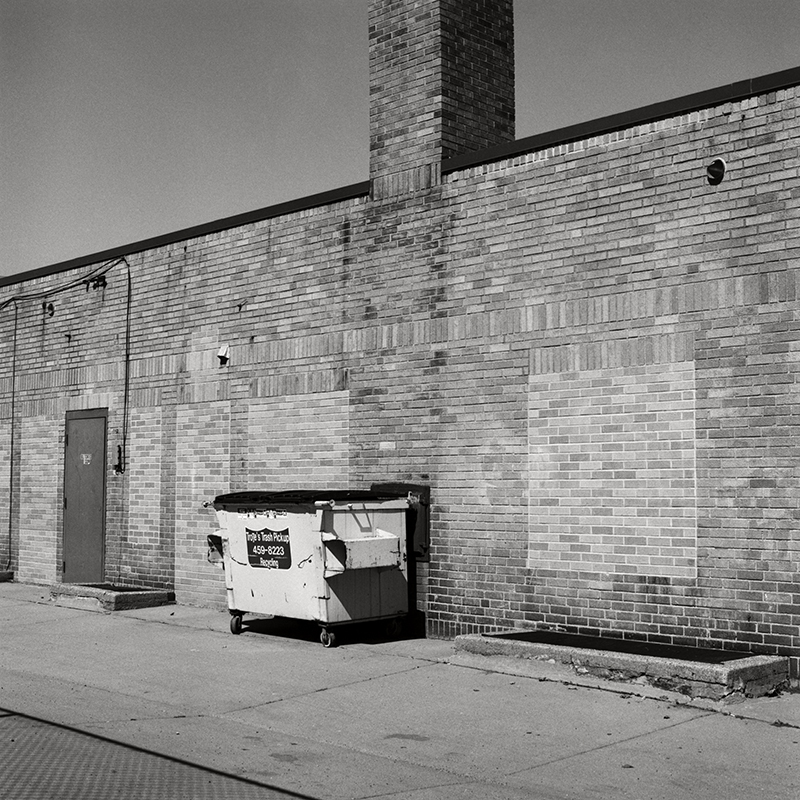

I was out walking with my camera the other day, and I ran a couple of rolls of Fortepan film through the camera. The example below is Fortepan 200, which I had to expose at EI 60 to get any shadow detail at all, in direct sunlight, at about 2PM in the US Midwest.
We can use that as an example instead.

Look at that sky in your photograph -- what a shade of grey. Unfiltered?
If that's unfiltered then the sky held up really well. I'd guess a No.8 light yellow filter as I know what Mid-west 2:00 pm sunlight is like, but if I'm wrong on the filter then this developer is special. JohnW
I did not use any filter. Just a shade, and paying careful attention to where the sun was.
That's pretty good then. If you down-rated to EI 60 then I'd say this developer holds the upper zones very well and doesn't let them go blank. I do know the angle you shoot at does make some difference, but I'd say this combo works very well indeed. Except for the speed loss of course. Michael R says it isn't special and he might be right, but it is different that's for sure. JohnW

If you think about my particular example, you can see from the shadows that the sun is from slightly behind me, and this wall is facing South, so the sun is also slightly to the West (afternoon). The lens is pointing basically to the bluest sky you can find mid day, and the brick wall is a light yellow color.
To me the way I aligned myself and how the light fell has a lot more to do with the results than the developer. Has I carried a yellow filter the effect would have been stronger, due to the scene containing mostly yellow, blue, and gray area. In retrospect it would have been exciting to see what that would have brought.
