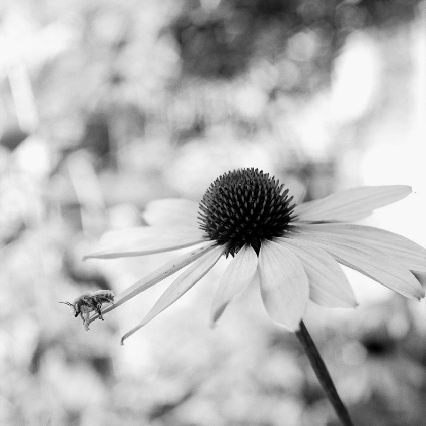

While I haven't done any direct comparison to other developers, attached is an example of those wonderful highlights. The mid-tones are wonderfully detailed, full of contrast, while the shadows are deep and still sort of anchor the image. Maybe not the best example, but I was shooting and testing a fair bit.
This was shot on 120 Neopan 400, and EI 250 incident metering. Wish I would have given it a tad bit more, and held back development 10%.

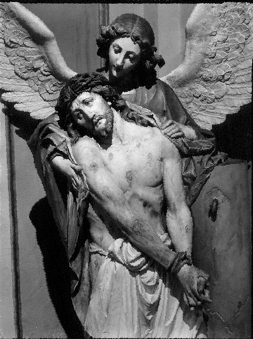

What I've always liked about it are the rich grays.

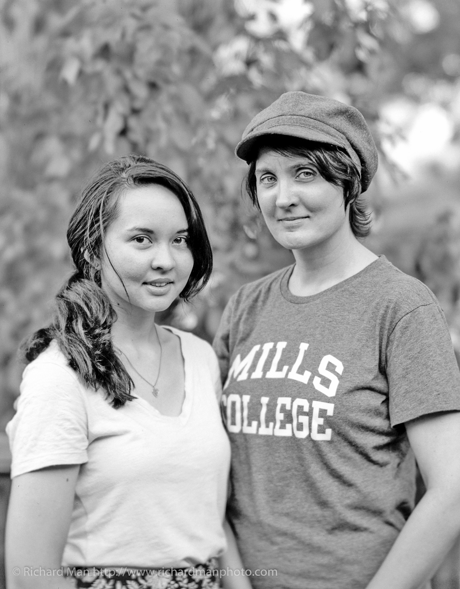

777 seems to be especially well suited to portraiture, for sure.
Looks like yoiu dropped some shadows out, not sure if it's intentional or not. I've noticed that 777 requires tons of exposure. Otherwise nice example.

*click slide click* check again? 3 seconds work on Lightroom....
Sorry, are you referring to me? What do I need to do? Attached image is what I could do in Photoshop with respect to bringing up shadows. Not saying any of it is wrong to drop some shadows. Just that you did...
Hair on the side of the girl's face.

Whoa! Do you have a calibrated monitor?! I do, and my prints match my monitor's. Your photoshopped is way too bright!
Or do you just use a standard Mac monitor?!
I wasn't trying to make it look nice, and I am fully aware it's way too bright.
Was only looking at the shadows, and the shadows only. I brought up the values in the shadows to max to confirm that some of the shadows were missing, and that was not to prove anything wrong about your photograph (your photograph is nice!), only to support my findings that this developer needs film with quite a bit more exposure than just about any other developer I have tried. That's all.
I use a Mac Book Pro with retina display. Don't know if it's calibrated or not. Not something I care too much about.
I see what you're talking about Tom. Under the hat bill and the young lady on the left has less or no texture to her hair on the right side near her cheek and forehead. Do you have to down-rate your film more than one stop with this stuff? JohnW
That's exactly what I mean, John.

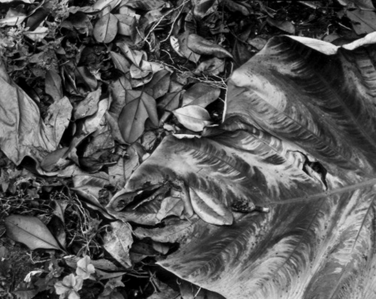

The attached picture was taken with my old uncoated Dagor and developed in 777. I rated TMY at 200 and placed the deepest shadows in the interior of the chapel on Zone IV, so according to Adams I'm really rating it at 100. Even so, had I used a contrastier lens, such as my Red Dot Artar, I think I would've lost detail in the interior. The actual print has more contrast than this and the interior is much darker. It was lightened by the publisher (which ruins it, actually, especially the cliff walls which really glow in the flesh) but it demonstrates my point. When in doubt, give it more light. I was in no danger of blowing any highlights in this photo.
Great point! When I use my Leica Summitar lens, which is softer in contrast than my more modern lenses, I can usually uprate my film a little bit. That's one of the things I really like about that lens, which makes it almost as fast as a more modern 50mm f/1.4. :smile:
I actually haven't used that lens since I started with 777. Should give me back some of the speed I sacrificed.
I've also noticed about 777 that it does manage the highlights very very well, does not block them up, while also not looking compressed. It's pretty sweet.
Heh, the point is those shadow areas are IN THE SHADE. One can bring up the shadow any number of degrees, and in this particular case, it would not matter if Xtol is used!!! So using that (my) image as an example of 777 shadow behavior is incorrect, IMHO.
