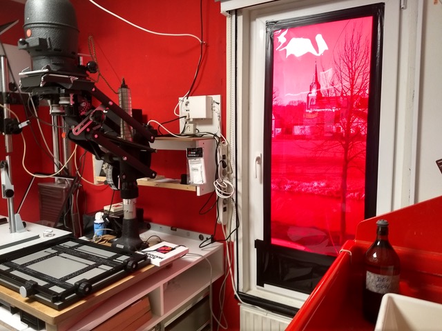

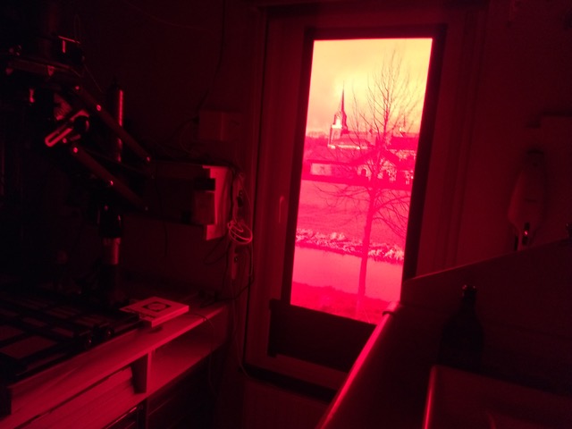

What a great experience, being able to do (B&W) darkroom printing while watching the view in front of my house during daytime, people passing by, birds in the canal and field, etc.. I did put a black curtain next to the enlarger today since I found that with bright sunshine outside, there was (minimal) fogging after exposing my RC paper during 5 minutes to this light.

Awesome! What kind of coating is that, and where did you get it? I have a small window that this would be perfect for!!

Great - where did you get this? I've been looking all over (in Europe at least) for something similar.
Hi Patrick, thanks for pointing at Ulano Rubylith! I see they have distributors spread over the world, though not in my country. This may be very helpful for others on this forum. The price is similar to what I paid. Who knows, maybe it is actually the same stuff.
I have already applied 2 layers, for the reason you mention. But still, a 50x120cm window at 70cm distance from my enlargers baseboard with bright sunlight outside was a bit too much. On a cloudy day it would be no problem but on a very sunny day it's better to shield off direct light from the window to the enlarger at such a short distance.

As a point of curiosity, for practical purposes: how durable is Rubylith for direct sunlight exposure?
My darkroom is a West-facing basement multi-purpose hobby room, with a single window that I've been covering with a blanket for daytime photo use, and uncovering for general use.
The window gets some early-day shading from a big Maple tree during Summer, but otherwise gets direct sunlight all afternoon, year round.
Would rubylith stand up to daily full sun exposure, or would it fade, crack, fail over time?
Rubylith is graphic arts masking film, a gel layer of sorts on mylar backing. It is made so the soft gel layer can be cut with an Xacto type knife and parts of the gel layer peeled away for masking. My experience is that is does not age well exposed to heat, the gel drying out and separating from the backing. I also don't think a large, bright light source such a window getting direct sunlight would be very safe with even 2 layers of Rubylith.
