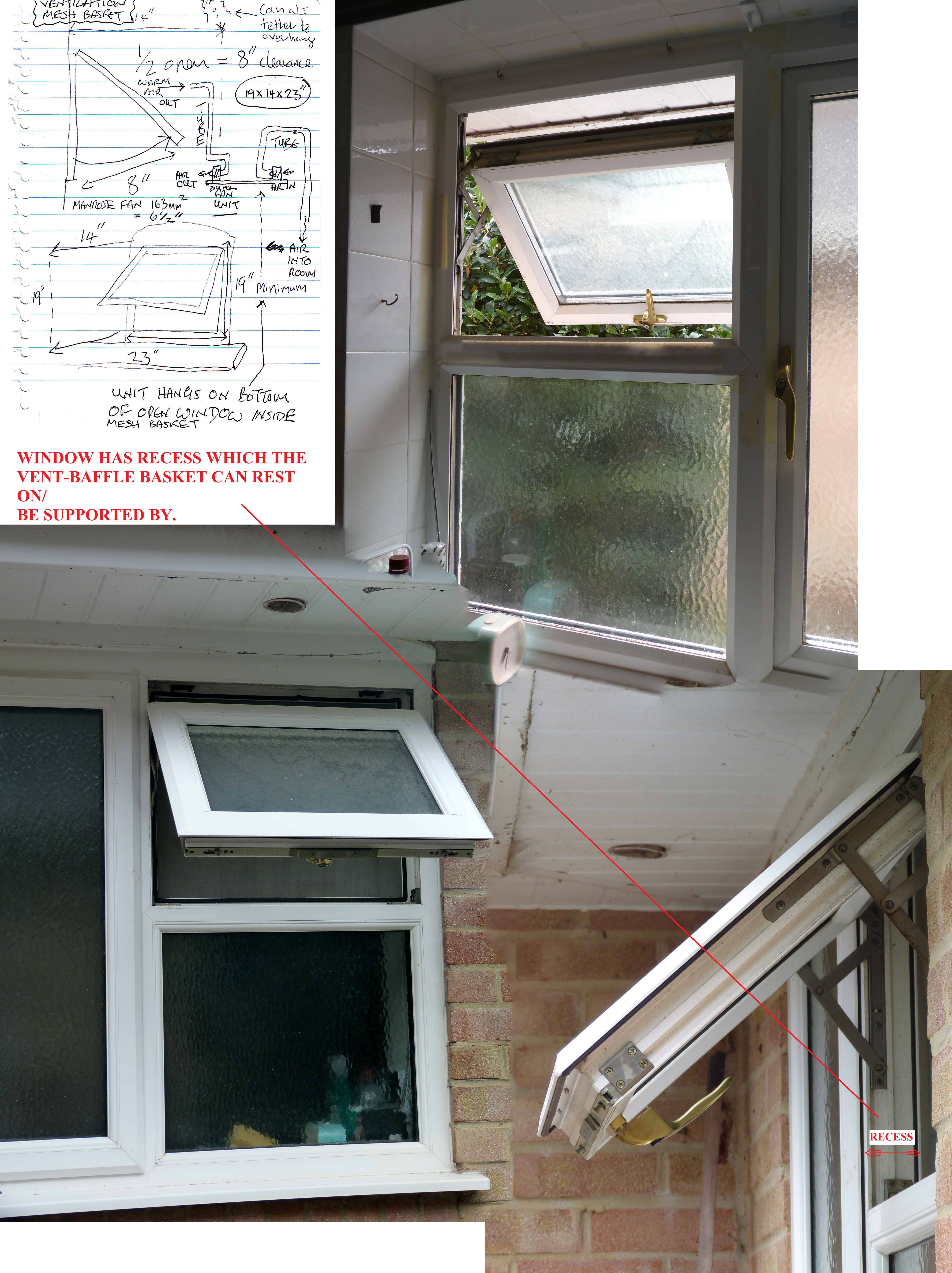

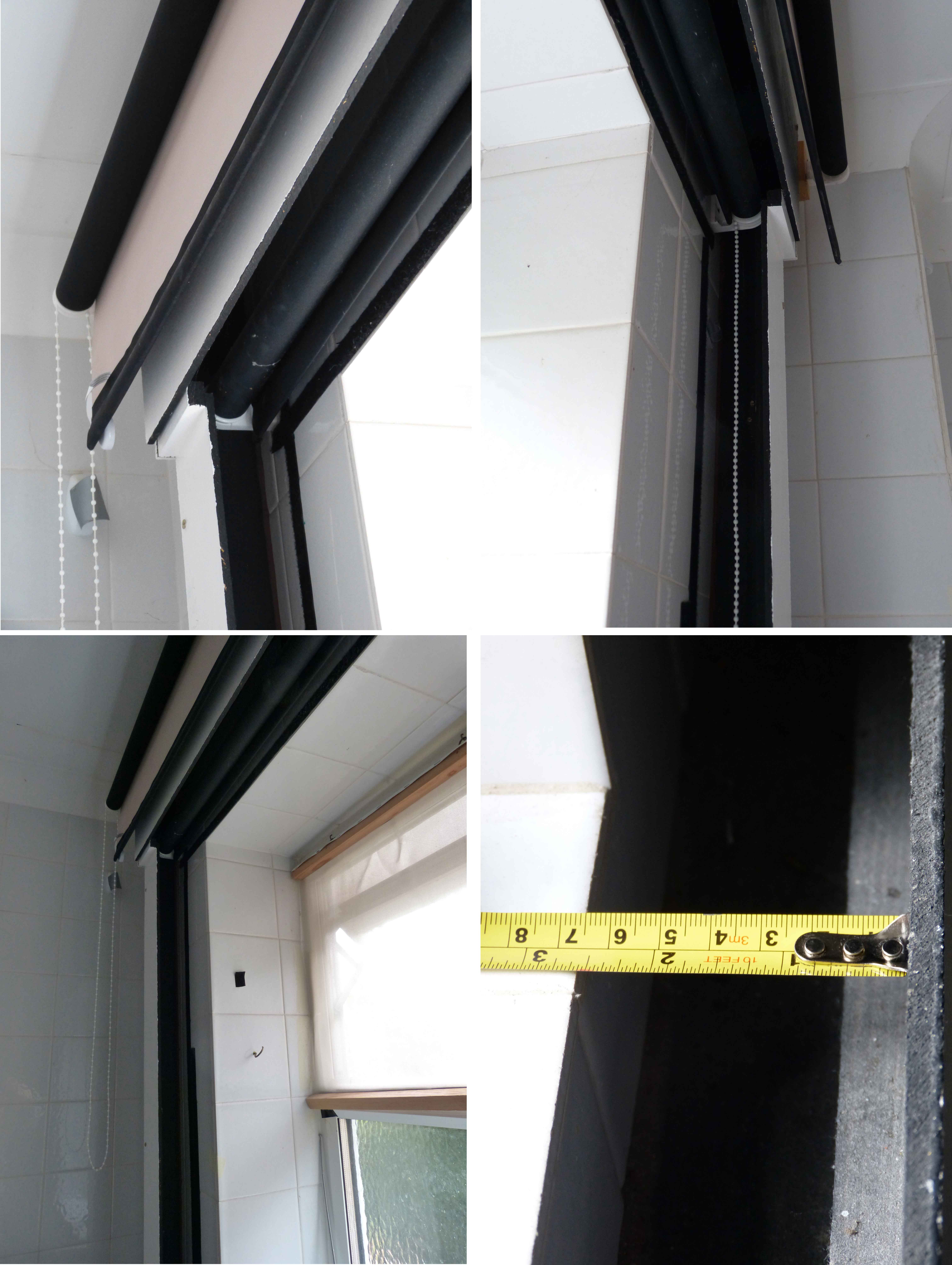

Here is the story so far - in pictures.
Here's the rough plan plus actual vent window, you will see that it has a deep recess, that is going to be very useful, because the fan unit will rest on it.
Secondly the light-proof blinds already in position plus light-trap guttering. The huge challenge here will be to coax piping into the guttering to facilitate air taken in, and extracted from the darkroom. It will be literally a tight fit, but I think I can do it.
