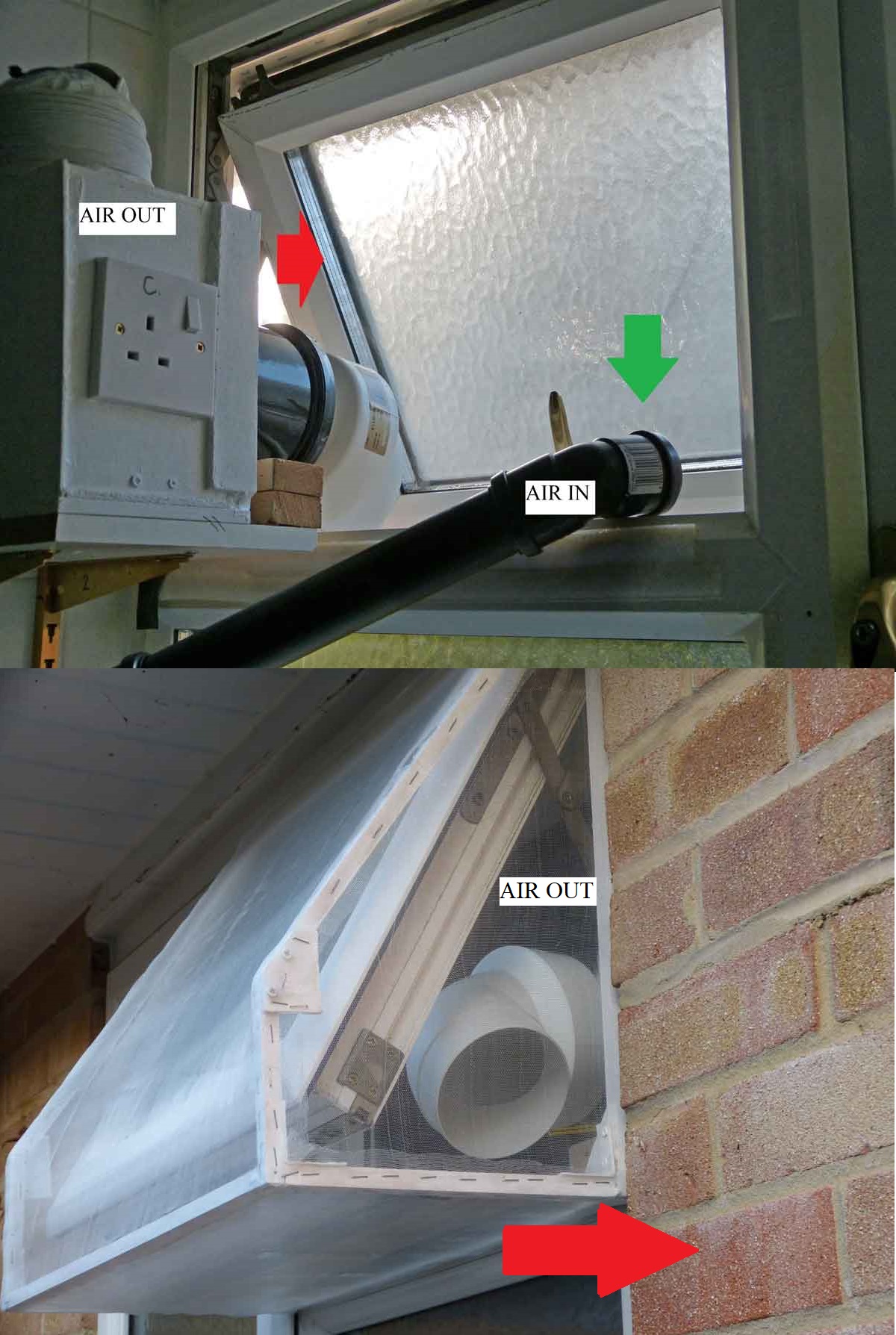

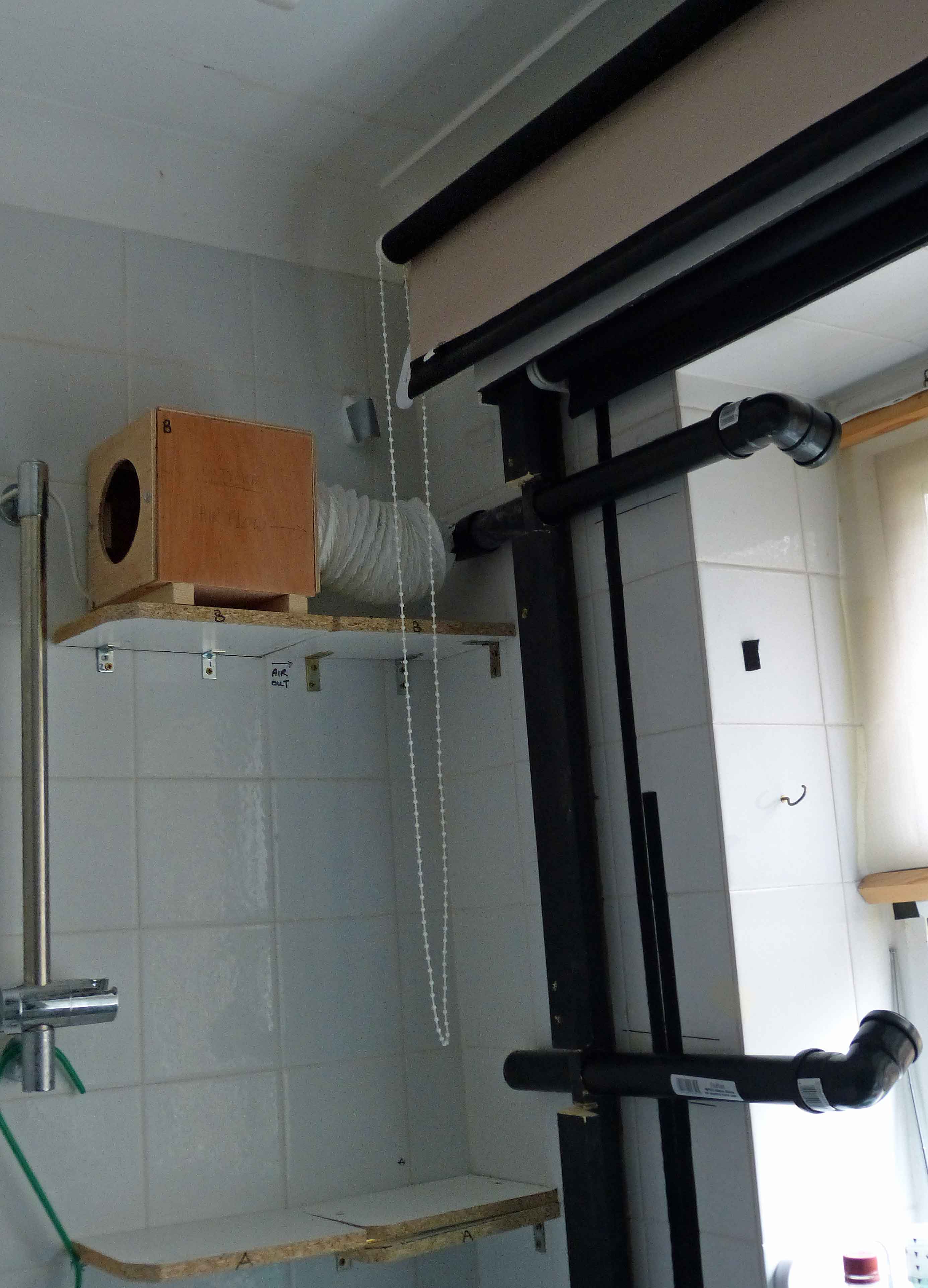

Yes, I will construct a double fan unit to lodge in the upper vent window, allowing it to open. The vent has a deep recess on which the fan unit can rest. Advantage of deep double glazed units, in this case.
First of all, I have to construct the outer baffle 'box' of mesh, which will enclose the open vent window, plus fan unit. When that is in place, I can then construct the fan unit to sit inside it.
The whole thing is hooked & clipped in place, all of it, & can be removed to storage, when not in use.
It will be a step-by-step project, to get it up & running.
Mega DIY.

Had to drill two loop holes through the light-trap frame for the 40mm pipes, one for air in, one for air out. Pipe extensions will reach up into the open vent window space, beyond which will be a mesh 'basket', keeping insects out of the pipes & darkroom. The pipes will also have medium-weave, mesh baffles in them, against insects & so forth.
The wooden box has an extractor fan inside it.

up & running.
The double blind unit cannot stop all daylight seeping in, between the woodwork, I'd have to go round all the inner guttering with sealant, probably impossible - or would take years of 'hit-n-miss'. This restricts me to developing prints at night - not a problem really.

Are the light trap boxes necessary with the black tubing having two 90° bends anyway? Especially if you only deal with paper and can do film stuff without ventilation?

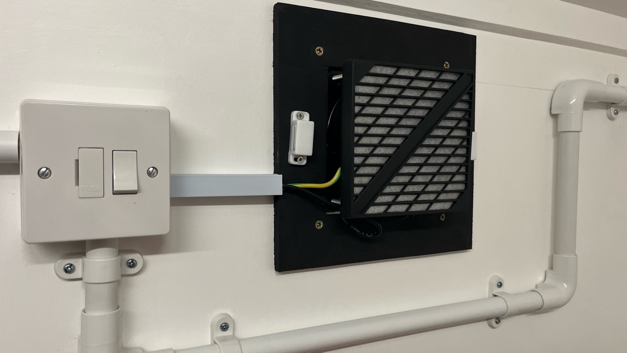

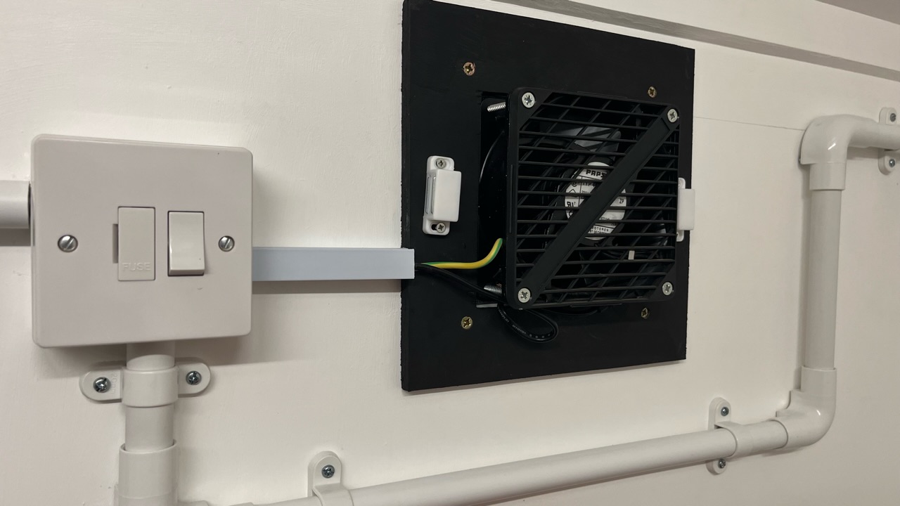

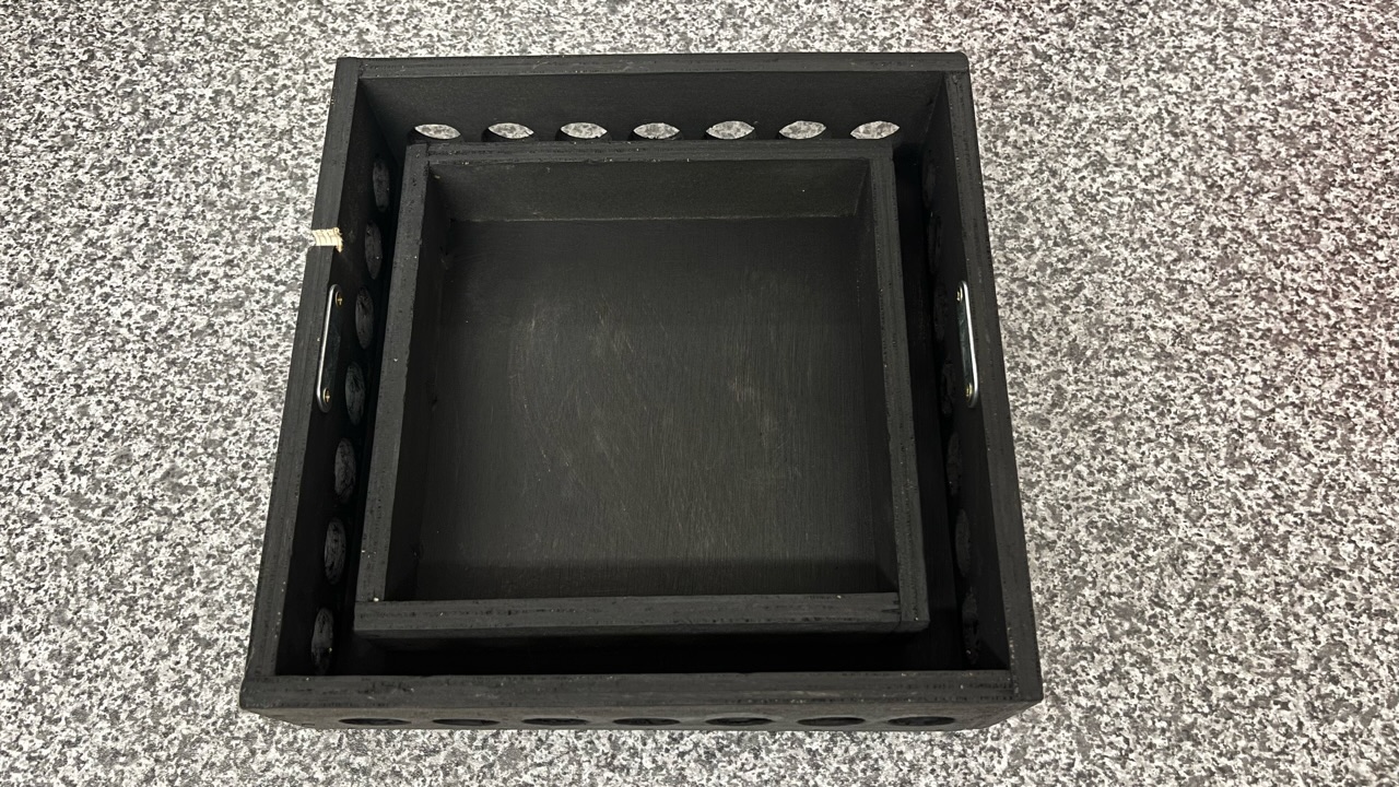

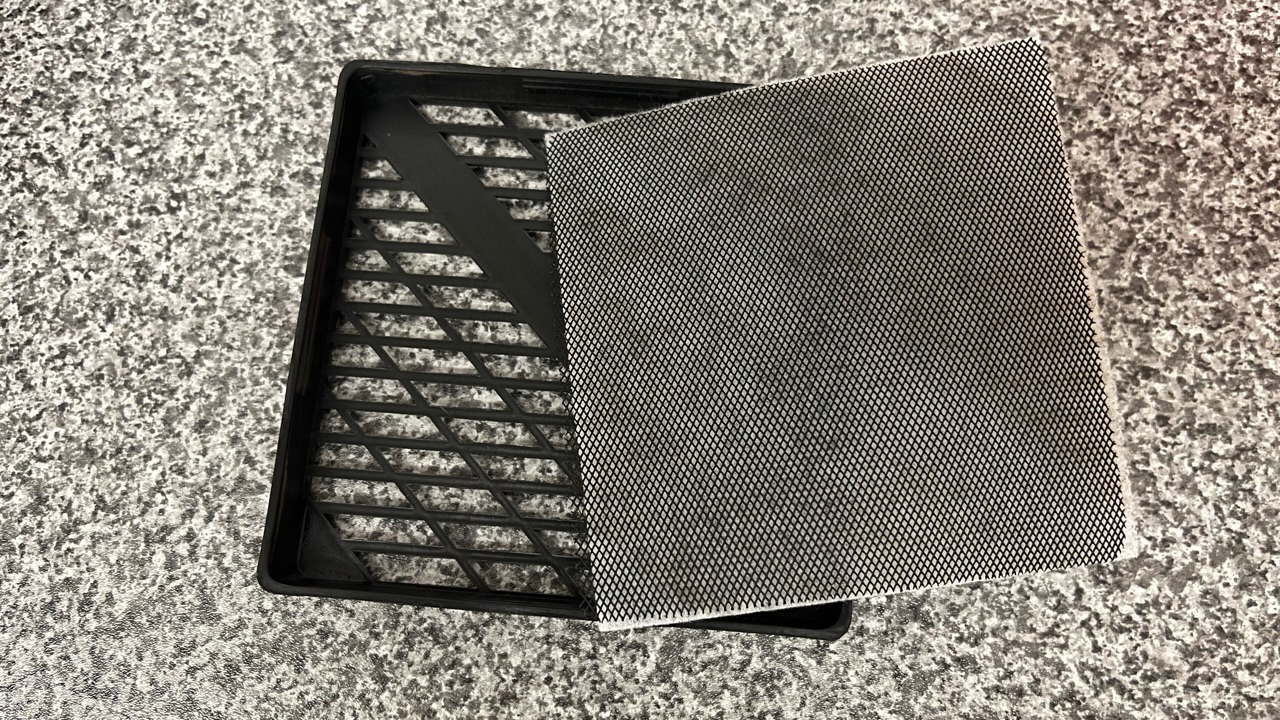

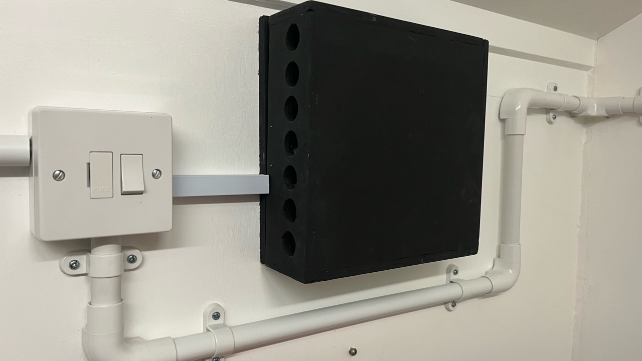

Looks very neat. Do you not get a lot of noise in those narrow pipes? My pipes are the full 10cm and direct through the wall (no bends). Light trapping is done by covers over the fans, attached by magnets. I realise this won’t help you, @kr236rk, since you can’t bore holes in the wall, but I’ll post some pics here in case it helps someone else.
The light seeps in around the edges of the wooden guttering, it does not come down the tubing. I could seal all round the guttering, but what's the point? There's enough blackout for me to handle reversal film for re-exposure to an electric light, & safely back into the developing tank again, if I need to do that in daylight hours.

The fans are pretty mild - but the hum they make is not an issue. They are the same fans people use as extractor fans in shower rooms, and so forth.
