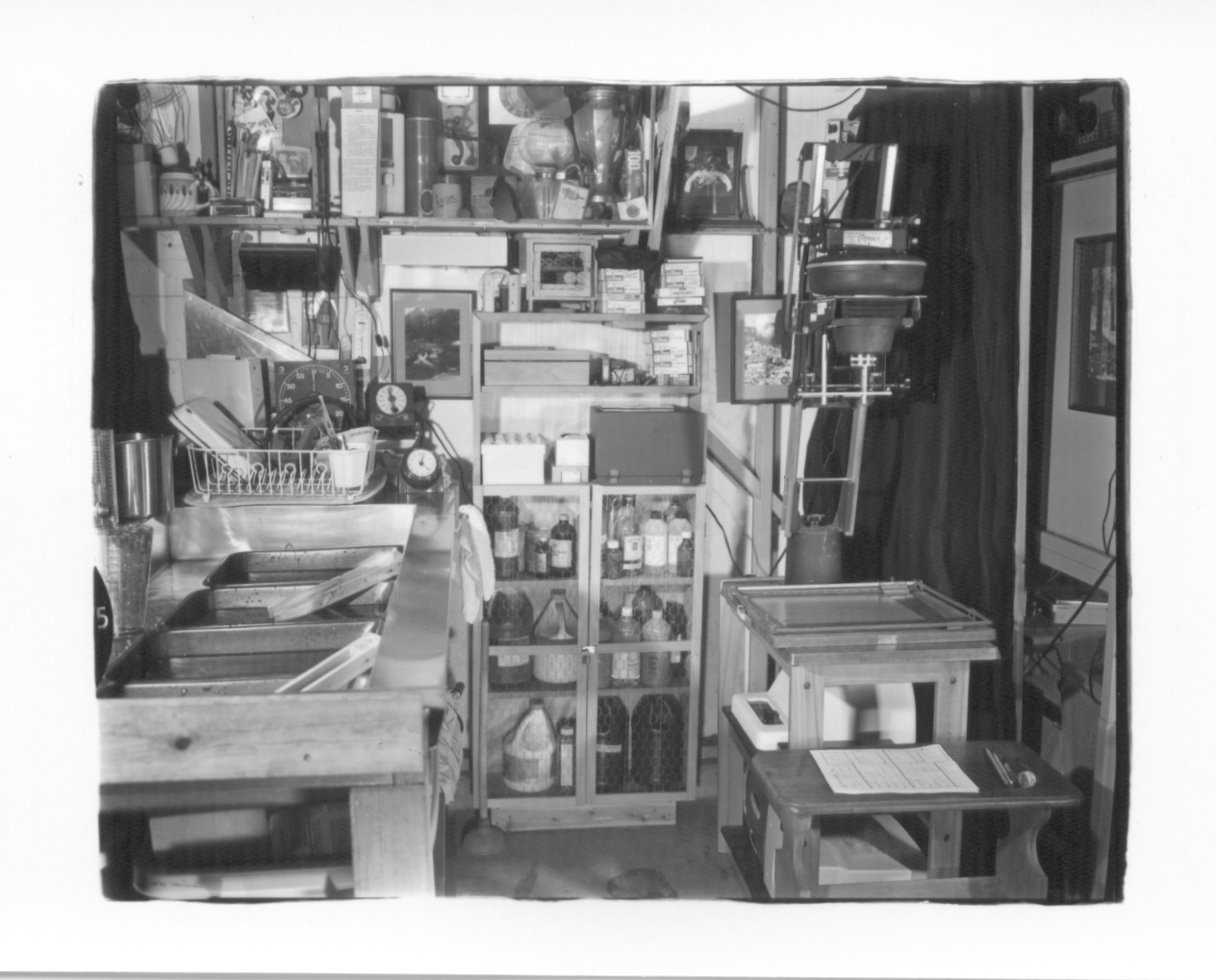

I want to show you my actual darkroom. Look at:
The dimenciones are in centimeters. I think it may be helpful.
