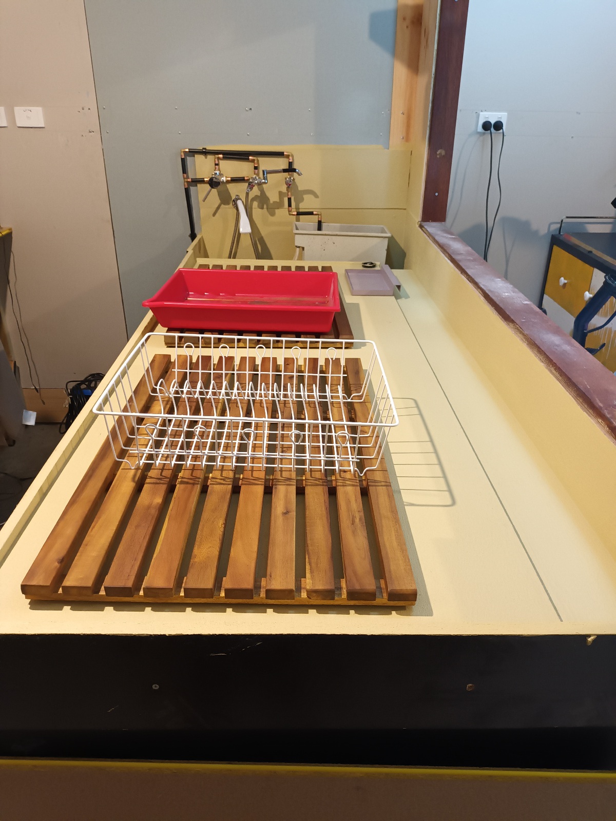

awty
Jul 24, 2016
3,700
Australia
I just finished mine, made out of form ply and painted with pond paint for water proofing. My old sink was made the same way, just needs recoating once a year. This sink is much bigger.
