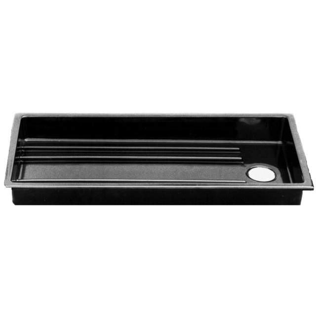

Hello everyone, I'm in the process of establishing a new darkroom in my garage after moving to a new place. I'm looking for sink ideas. I'm very poor with DIY stuff and not the handyman my wife always wants me to be. I'm willing to buy one but the only one available seems to be the plastic ones from Delta which has not very good reviews. The main feature I'm looking for is to have a sink that is large enough to accommodate my 16x20 washer along with one 20x24 tray. I'd also love some recommendation on water temp control and regulator. A nice to have is a 6 to 7 foot sink that can have multiple 20x24 trays in it (but I'm not super fixated on that as I can have the trays on a table). Another nice to have is sink side table so I can have my Jobo processor on it so draining should be easy (again, not fixated on that as well) as I can have a side table with the same height and the Jobo on top of it.
I checked out sebastiandarkroomprod.com and talked with them, price is rather steep and I'd prefer a cheaper option. I looked up hardware stores for farmer sinks without luck and checked commercial sinks online without luck.
What would you suggest?
Thanks

I used these people, who can make the plastic sink to your own spec and then just make a wooden frame to drop it in.

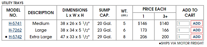

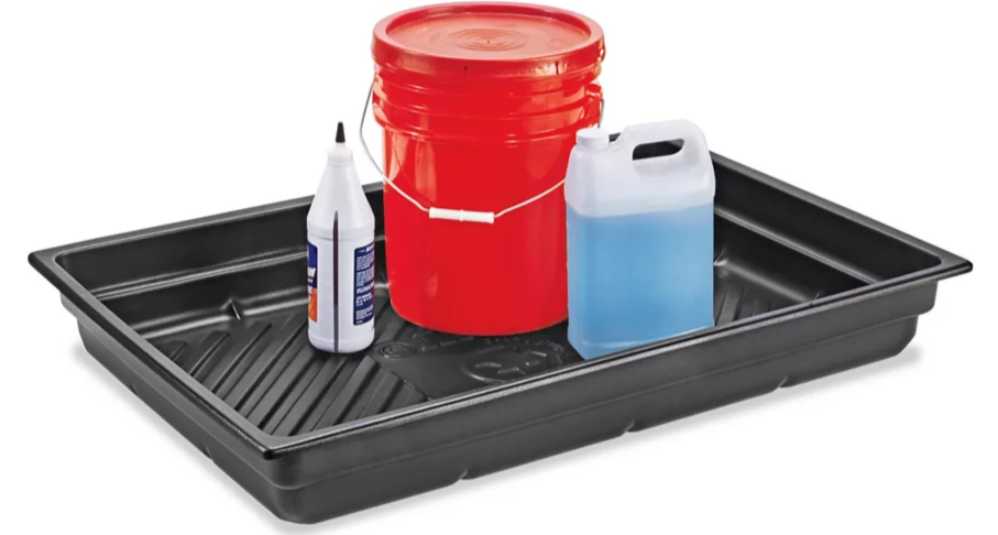

Possible option found on the U-Line USA and Canadian Sites (Prices shown here are from the Canadian site.)
