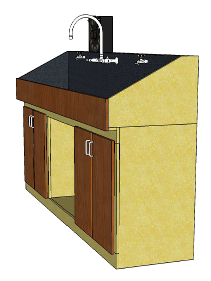

A couple of people have mentioned a toe-kick or some open space below for knee room. Instead of a traditional base cabinet design with a toe kick, I recessed the entire front face of the base 3" to accomplish both toe and knee room.
I also removed the doors from the middle cabinet bay for vertical tray storage in order to facilitate air drying.
By the way, sketchup has proven to be an especially useful tool for modeling this. The price is right (free!). The dimensions are precise and I can rotate the model and hide panels to get lots of different views. The only downside is a bit of a steep learning curve to get the hang of 3D modeling. Fortunately, there are lots of tutorial videos available.

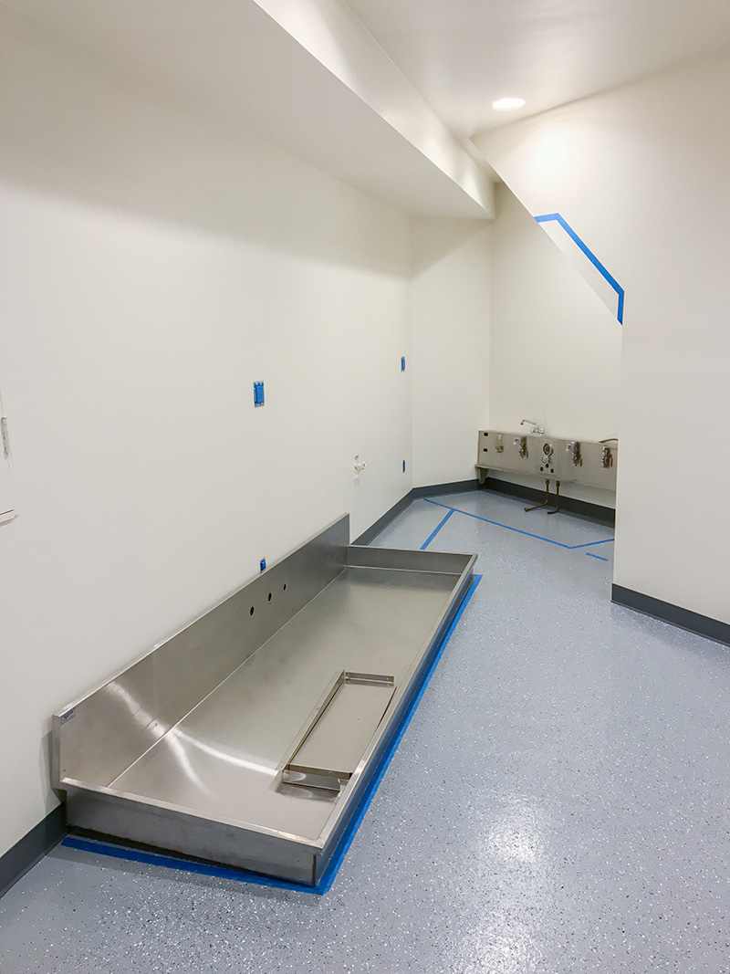

Very timely post, I am getting ready to install and build my wet side, 9 foot and 6 foot stainless steel sink plus fill in areas for things like my Jobo and a mural paper processor. Been trying to dial in the height.
