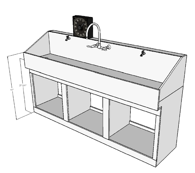

How tall are you? How high is the (inside) bottom of your darkroom sink from the floor? How high is the reach over the front? Are you happy with the height?
I'm building a sink like this (from my sketchup drawing):
The sink will be 8' long and the front panel height will be 6".
I'm 6'1" tall and I'm considering placing the sink bottom 36" high, which will put the top of the lip in front 42" high. When I mark the wall at those dimensions, it seems a bit low, however when I stand next to a table that's 32" high, it doesn't seem so low.
When I made my darkroom at my parents home, I stood on the floor, bent my elbow 90 degrees, so my forearm was level. The bottom of my forearm was the height of the front edge that I wanted.
You should make the lip 44 3/4 inches high. I'm 5 foot 9 and my sink is 41 3/4 inches... I've always felt it was perfect.
When you are standing, and resting your forearm on the lip, your arm will be slightly downhill, so water won't run up to your elbows.

I appreciate the advice. I'm leaning toward 43" lip height which puts the inside sink bottom between 37 3/4" and 38 1/2". I'm planning a 3/4" drain slope across the length of the 8' bottom, which isn't much, but should keep the puddles to a minimum.

Here's a little more sketchup work with some of the base cabinet drawn in. Still need to draw in doors and shelves, but it's coming together. Thanks for the input from everyone.
This puts the lip height at 43" and the inside base at about 38" (sloped right to left).
You still could adjust height by varying height of the the whole console.

I found a bench top in my garage 38" tall. It passes the "hands flat on the bench without bending over test." The 43" lip is a couple of inches shorter than my elbows with my forearms parallel to the ground. I'm pretty comfortable with my planned dimensions now.

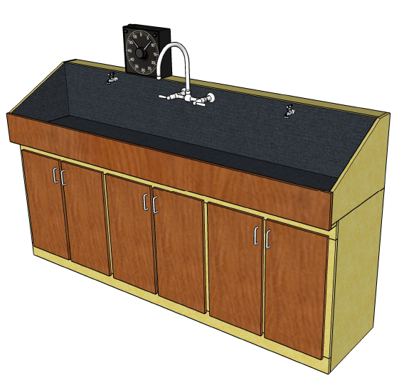

Whatever height you determine should enable you to work without bending over. So no stooping which causes back pain and tiredness. Your darkroom should be comfortable for you. As a starting point the standard counter height is 36 inches. Are you comfortable working in the kitchen? Another consideration would be will there be a thick mat or duckboards in front of the sink. This would have a part in determining the correct height.
There have been some very helpful suggestion here. I've redesigned it so the base cabinet is 36" high and the sink portion is attached above that. It puts the sink bottom about 38" high depending on the slope.
The two major pieces will fit through regular doors when disassembled.
I like the idea of some vertical shelves for tray storage. I haven't designed the shelves yet, but I'll make one of the cabinet bay shelves vertical.

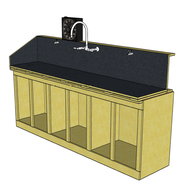

The sink sides will have a groove routed 3/4" by 1/4" deep for the sink bottom. This will add considerable strength but I'll have to create the slope at the time of the routing. I can't reasonably add slope later since I want to mount the base cabinet level.
Here's another look with some of the doors and side panels hidden. It should be plenty strong to hold the heaviest of print washers.
