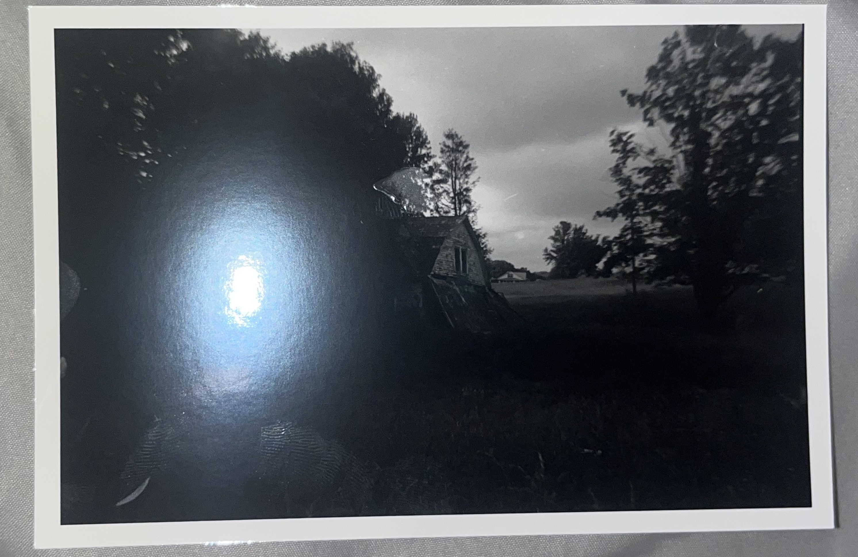

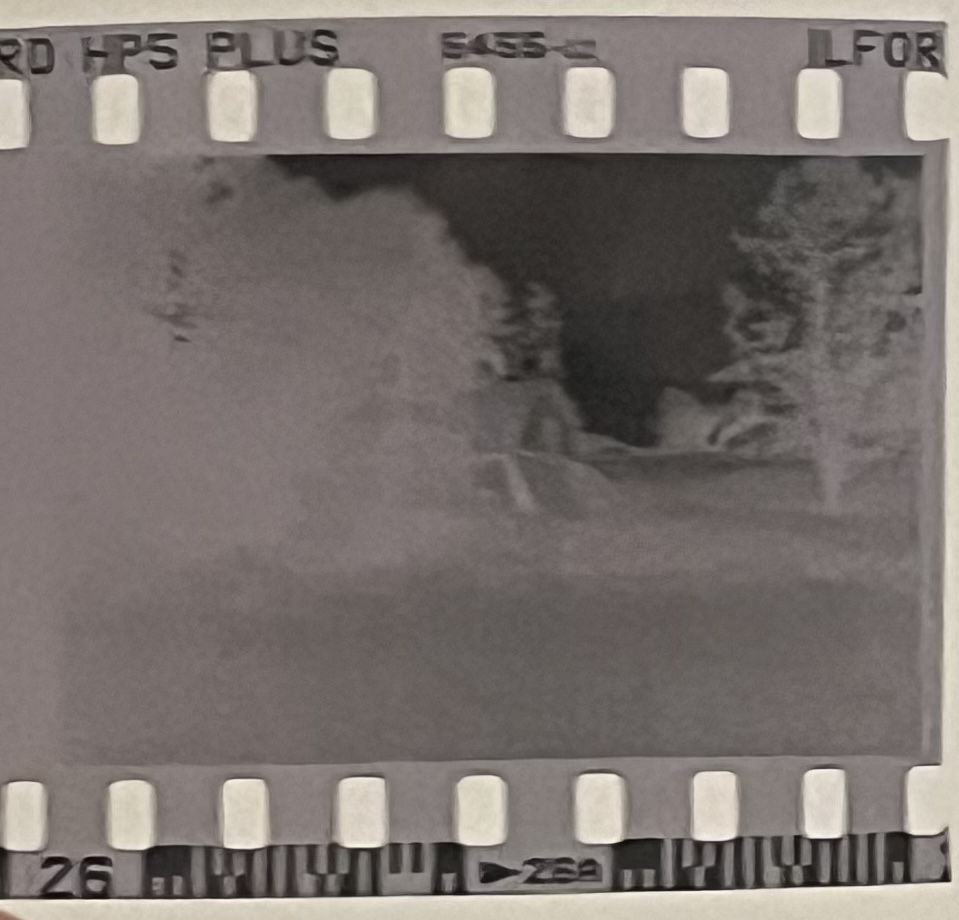

Here is a picture of the negative. It’s not the best but the best I could get. I guess it’s a pretty dark negative. That might have done it. Here is a picture of the print as well.

Also, your negative does look fairly thin in the shadows, so consequently, you'll always get a muddy and/or dark print from it. That's to be expected.
Use a higher contrast grade and try again; you might have to go to grade 4 or even 5 with this negative.

When i look at the negative my first impression is that it could have done with a bit more exposure so you get more details in your shadows. The relatively bright sky over the dark trees will probably have fooled your exposure meter. Remember that overexposing negative film hardly ever does any harm in this kind of situations and giving it one or two stops more light will making printing the shadows a lot easier, even when it means you will have to burn in the highlights a bit.
With a negative like this i would start with a filter 5 for the shadows and search for a printing time that just reaches max black in the darkest places. This would max the shadow details without leading to a muddy print. Then i would switch to a 00 filter to burn in the highlights to give the tone and detail you want there. It might take a few sheets of paper to figure out the right times and sequences. Basically this negative needs split tone printing to get decent results and you might want to do a google search on how this is exactly done.

Thanks for the neg and print pictures. As others have said it looks as if the negative is under-exposed with little of no details in the shadows and given how much of the negative is shadow area the print is bound to look dark.
This particular negative will require a rescue operation to improve it but I'd try f16 as has been suggested which allows quite a short time for exposure. If that does not make enough difference then you still have grades 0 to 1.5 to try

I wouldn't know where to start. How can you produce a negative that bad and get a print with some part of it relatively sharp?

Yeah, everything except the clouds are quite a bit underexposed on your negative, this'll yield a very dark print. I would try to find a negative that's more evenly exposed. You picked a very difficult negative to print.
