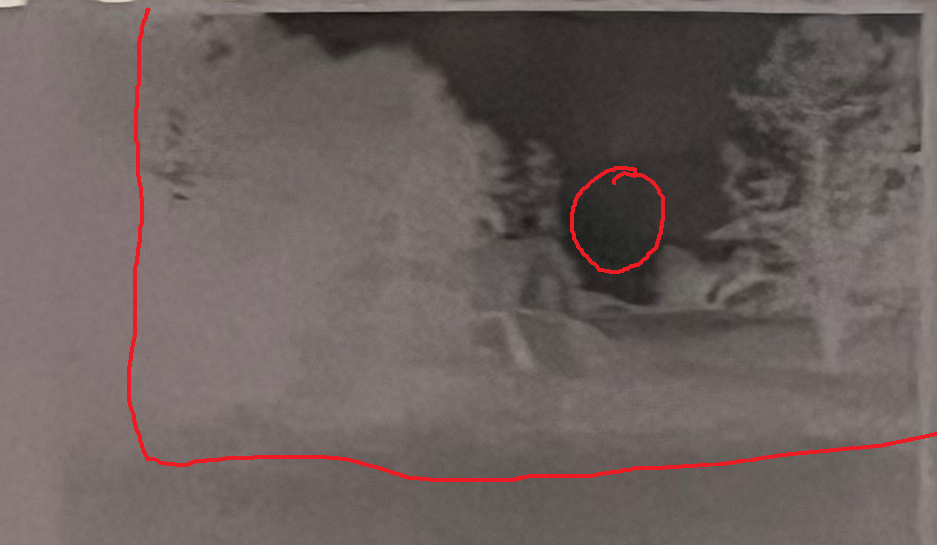

Darkroom prints too dark

As others have pointed out the negative is underexposed. You can tell by the lack of detail in the shadows. It might just be the meter in your camera is off a bit, or you don't quite know how it's working so you can make it work for you (it may have been fooled by the bright sky). For your next roll try a few shots at both 1/2 the box speed and at box speed and develop the same way. Also watch the exposure as you move the metered area around. Generally you want to give more exposure with negative film rather than less if you're unsure.
Sadly I think you can write off getting a print with detail on the left half. If you want to experiment and see what is on the film raise the enlarger head and make a crop with just the portion of the image with detail (the upper quarterish area). It might give you something you can practice printing with. My guess is your image is also a bit over developed so you may need to go down to a #1 filter or less, but it's hard to tell without seeing the actual negative.

Without going into personal film speed & normal negative development tests, and assuming you're giving your prints full development...
...are you making contact prints at max black time?
This would be the minimum exposure at normal (or a wee bit soft) printing contrast which results in the negatives clear edge printing as max black. (The resulting printing time shouldn't be too long or too short, so adjust enlarger height and aperture accordingly).
This will tell you the unvarnished truth...if your negatives are too dark, too light, or have too much, or not enough contrast. (Lots of variables here, so take that as a sweeping generalization).
There is nowhere to hide from the brutal honesty of a max black time contact print.
This won't help with the negative we're talking about, but moving forward it'll let you know if you're consistently under or overexposing your negatives, or if there might be a consistent issue somewhere else in the chain.

I'd consider cropping as shown below, but that's not important. Make a test strip such that the area inside the circle comes out almost paper-white. Then make a print (probably at grade 3 or 4) using that exposure. That should get you an idea of how to start.
