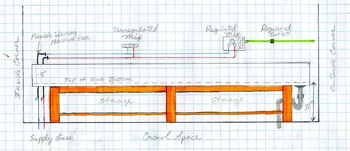

This is exactly what I'm planning-----the plumbing will be exposed on a panel that is attached to the wall behind the sink.

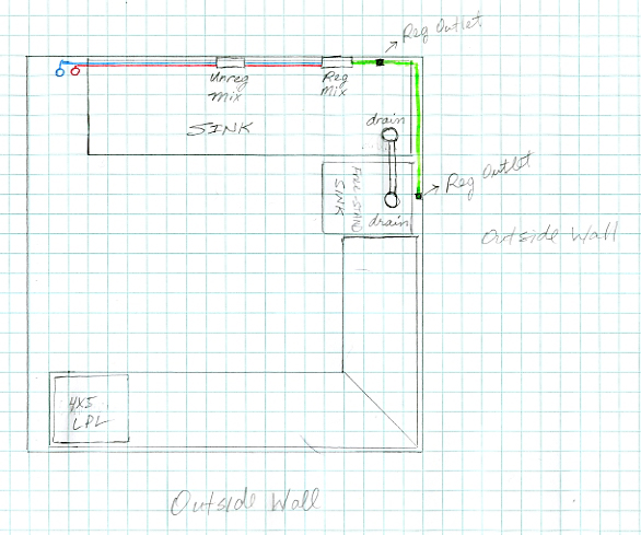

Thought I would get some of your thoughts on this plumbing layout------it's pretty basic, but any thoughts are welcome, I could be missing something. The room dimensions are 10 x 10---the adjacent room opposite the long sink is a bathroom where I can tie into the drainage and hot and cold lines. I'm thinking of adding an additional smaller stand-alone sink as seen.
Consider ball-valves between you darkroom plumbing and the rest of the house. If you spring a leak in the darkroom it will be much easier to fix if you can just shut off the darkroom, and not have to shut off the whole house and drain it. Also, when on vacation, you may sleep better knowing your darkroom water supply is shut off. Especially if you do the plumbing yourself.
Also, if you move and want to take your water panel with you, it will be a lot easier to do if you have the valves there.
Also, I don't think a B&W darkroom needs a tempered water supply. The only reason I installed one is that a few years ago a guy on ebay was selling a bunch these Powers Photopanels un-used for $60 a piece.
10-4 on the ball valves to isolate the darkroom plumbing----thank you. My plan is to use flexible washing machine hose from the hot and cold supply with shut-off valves as shown. I'll probably go ahead with the regulated mix, I certainly like the idea. I hope to get going on building the sink on my 4 day holiday weekend. My only concern about these plumbing plans is that I will have the drainage properly vented, I'm going to rely on the plumber for that.

I'll have to say now that I have the thermostat, I'd miss it in a new darkroom. It makes filling the Jobo very easy and its already tempered when full. I didn't use PEX but in your case the PEX may be the way to go.
I have a master shutoff (ball valves) for the entire system and it certainly is useful. I also have temperature regulated output as well as a "standard" faucet. The temp regulated water goes though a filter, then there are 2 outlets, each with it's own shutoff.
I would suggest the stainless steel braid hoses (they should be on your washing machine too).
There are drain fitting that eliminate the need for a separate vent pipe. Not sure how well they work but they would greatly simplify your plumbing.
I have no idea why you would need a separate vent pipe.
If you are going to do the hot and cold yourself then don't waste your money on a plumber for the much simpler waste pipework.
I won't be doing the plumbing in the crawl space, only once the supply lines are in the room

I should clarify. Your added drains need to be vented for proper operation. Depending on how and where the added drains connect to your existing drain pipe, you may need to add a vent those new drains (typically connecting to a single vent going through the roof).
You probably have 1 or 2 plumbing "stacks" going up through the house. If more than 1, they connect in the attic and vent through the roof (though they could each have a vent through the roof). If your new drains connect near the bottom of that stack, you'll need to connect a vent pipe to an existing vent. If they connect near the top, you'll probably be OK without a separate vent.
The fitting I mentioned is supposed to eliminate the need for adding vent pipework. It allows "one way" passage of air into the drain, essentially making the indoor air your vent. Haven't used one, so don't know how well they work.
It will be one additional drain that will have to run in the crawl space approximately 8-9 feet to tie into the where the tub drains. So, if I understand your post, since it will connect at the bottom in the crawl space near the main vent stack, then an additional vent will be needed from the new drain to the existing main stack. My home is small with only two vents, one for the kitchen drain and the one (much closer) that is the main vent stack for the tub, bathroom sink, toilet, and the washing machine.
In the UK, we generally have just one vent stack. Drains from sinks, basins, baths, etc. drain into an outside open drain with built in trap rather than going straight into the stack, although that is the usual method when adding a drain somewhere. I have never heard of anyone needing additional venting to the standard 4" stack.
An alternative to a vent stack is an air admittance valve. Do you use those in the US?
In Victorian Britain, almost every connection to a drain had a separate anti-siphon pipe installed. This didn't actually do anything of much value and hasn't been used for about 100 years.
If it's connecting in the bottom of the crawl space, with tub (and presumably toilet) above, I would think you would want that vented. You could try it without and see if plumbing drains well but I would use one of vents I mentioned (I looked and they're call "cheater vents" or "check vent").
I'm guessing they're the same as what Steve Smith called "air admittance vents".
