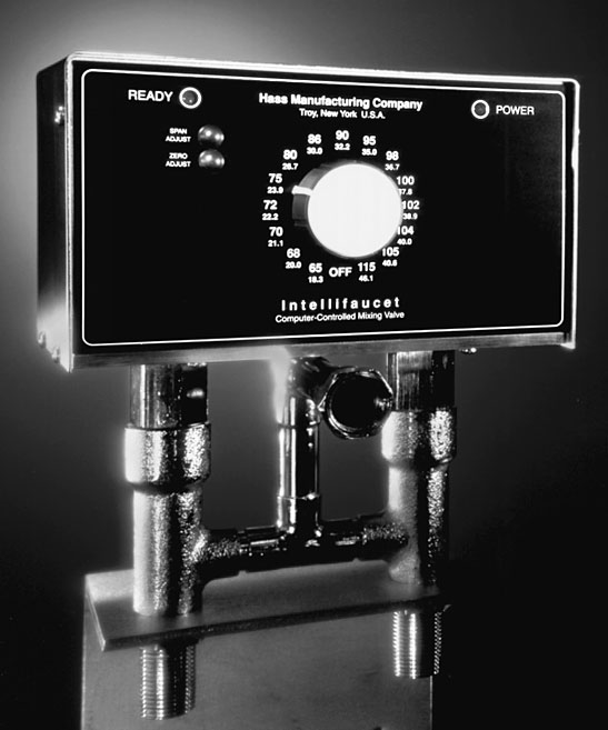

Besides having a regulated water temperature mixer in the darkroom, how many of you also planned for and installed just the basic unregulated hot/cold faucet as well, and if so, why? I'm finally able to devote some money toward getting my darkroom built and the plumbing is foremost on my mind. I've gone through the "Darkroom Portraits" thread and it seems that there are a fair amount that have both---I'm wandering if those that have both were planned that way or was the unregulated faucet already part of the room where the darkroom is? I will be turning a spare bedroom into a darkroom, and getting the hot and cold supply in will be simple enough, but from there I have some decisions to make.
Thanks in advance.
thiis what iuse and it's great!
I put in a standard tap, with hot and cold, and then also ran a pipe with multiple taps which runs tempered water in my last darkroom. I am in the process of building yet another darkroom which will be much simpler, since I live in an area with exceptionally bad water and will be mixing all of my chemicals from bottled water, and will be using running water far less. I plan on relying much more on my jobo processor to maintain temp for film processing.
