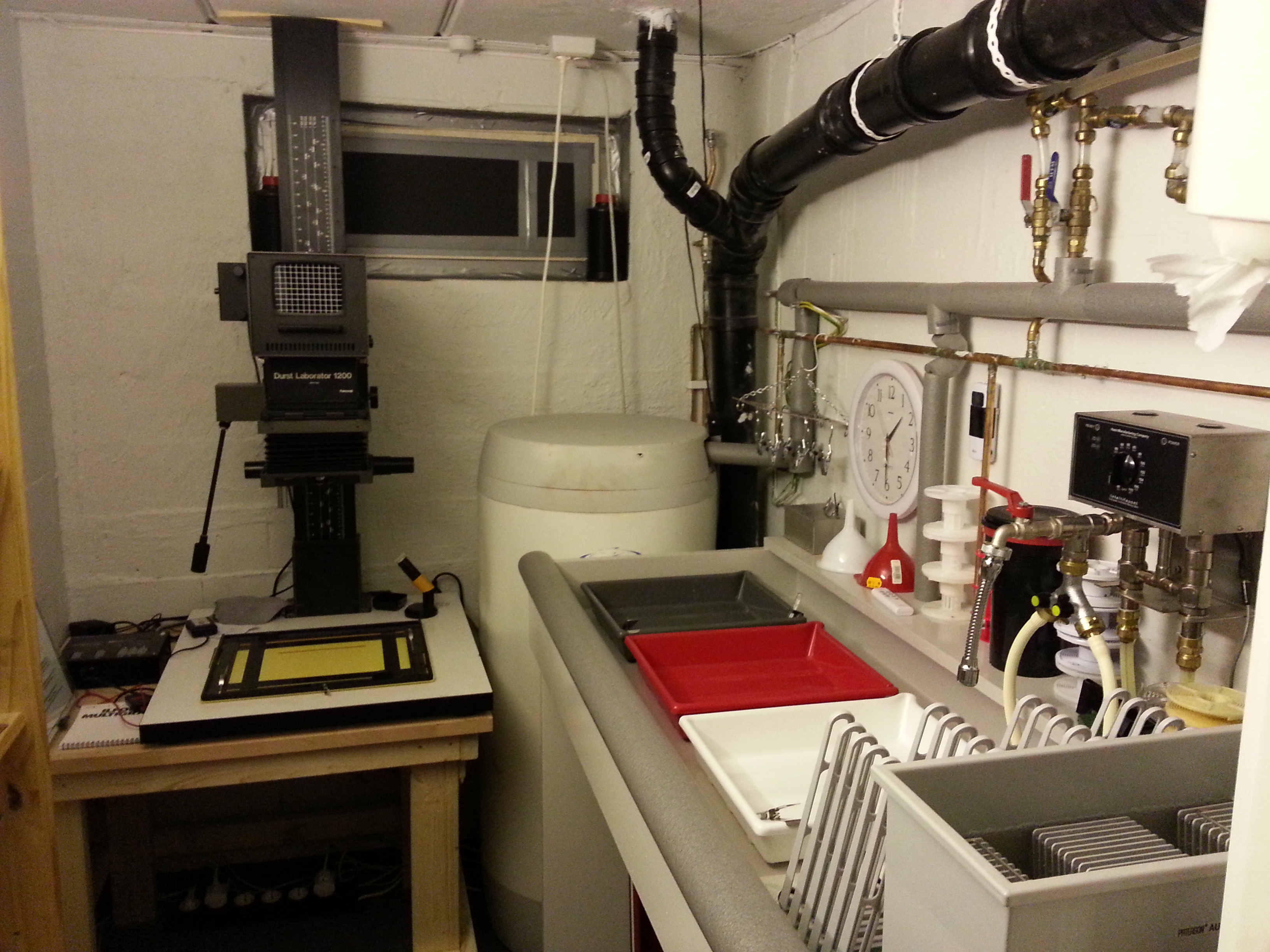

I do that, too - but I get the things pre-slit: I buy isolation material that's meant for use on water pipes. It comes in various diameters, is hollow, and is slit to let you slip it onto the pipe. You can see them in this picture of my darkroom - I've got them on the cold water pipes to avoid condensation and dripping, and then I put a larger size on the edge of the sink.
