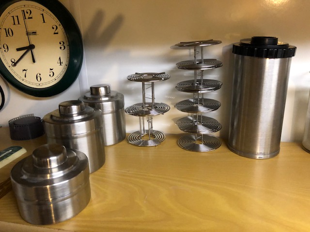

While I started off with a ratchet-type plastic reel and tank, I switched to these stainless steel tanks and reels almost 50-years ago and never had a problem with them either for 35mm or 120. Yes, there is a little bit of a learning curve in loading the film but it can be quickly mastered.
While you have to give the film a small crimp to get it started, one thing I’ve relied on to make sure that the film is loading correctly is the sound of the film going on the reel. I have to turn off the music I usually have playing in the darkroom when I am doing it to hear the “swishing” sound of the edge of the film sliding into the spirals of the reel as I rotate it.

Are these daylight tanks?
I take the definition of “daylight tank” to mean that the film has to be loaded in the dark but the processing can take place in daylight. These are then daylight tanks. There are 4 components: the tank, the reel, the lid (which has a light trap), and the cap.
Load the film on the reel in the dark and place in the tank. Place the lid on the tank. Now it is safe to turn on the lights. Remove the cap and pour the chemicals in. Put the little cap on the lid which allows the tank to be inverted during processing without spilling out the chems. Remove the cap to pour out the chems. When done processing, remove the lid and wash in the daylight.

I bought these at Freestyle many decades ago. They have no brand name on them, just an stamp on the bottom that says “Made in Japan.” I will say that the tall tank with the plastic lid does not leak when inverted. The all-metal ones tend to drip a little bit.
Looking at the Freestyle site, I think my tall tank is an Arista and if I was in the market for a tank, I’d probably go with that.
