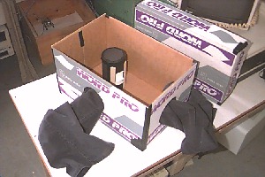

I use a changing box when I need to change film in one of my pinhole cameras in the field. It should work fine in your home as well, and cheap. Details:

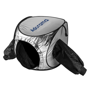

Need a larger dark bag? I use this one even for 4"x5" film.
Photoflex Changing Room | Freestyle Photo & Imaging
The Photoflex Changing Room is an upgrade from the traditional dark bag.This double walled, light-tight changing bag includes an internal frame that provides plenty of room to work and an internal, removable "trash bag" for film wrappers, boxes, and canisters!…
www.freestylephoto.biz
Thanks, Sirius. I saw this on the internet and some reviews mentioned that the position of the arms on either side worked for some and not for others. Do you have personal experience with this item?
I have this Photoflex Changing Room. It's great, with plenty of room inside to work unimpeded. I recommend it. For me, its spaciousness makes it much better than a bag.
Mark Overton
I think a changing tent or 'room' is the way to go. I have one branded by Calumet and it's the right size for loading 4x5 dark slides or loading 35mm film into five reel tanks. It can get sweaty on hot Summer days, but not nearly as uncomfortable as a changing bag, and of course your arms aren't touching the material using a tent.
I use a changing bag but I found very easiest way for me was to use it in conjunction with a film loader (or whatever they are called) and just load film onto reel directly from cartridge in the bag. Done in a minute.
Many ways to skin this cat tho
Looks very much like the Photoflex one, which costs twice as much.
Strange enough Adorama does not ship to Europe.
I've got the PhotoFlex tent/room/box. Works pretty well, although I had to air it out for the first month or two-- when folded up, it would develop this horrible chemical smell.
The arm holes are on the side-- I'm 5'11", so it's not that uncomfortable, but if I were smaller, it might be an issue.

Looks like the PhotoFlex is very popular. I think I'd pony up for that instead of the bag since it's not that expensive. I've got monkey arms so it shouldn't be a problem from that perspective, either.

I think the box is better than a bag unless there's a box in the bag as was discussed. Vince posted a cheap DIY box idea that I'd like to try if the local thrift store can cough up a pair of suitable black pants.

Did I miss something? I mean the idea of a box instead of a bag is not new and Vincent made a great design improvement.
