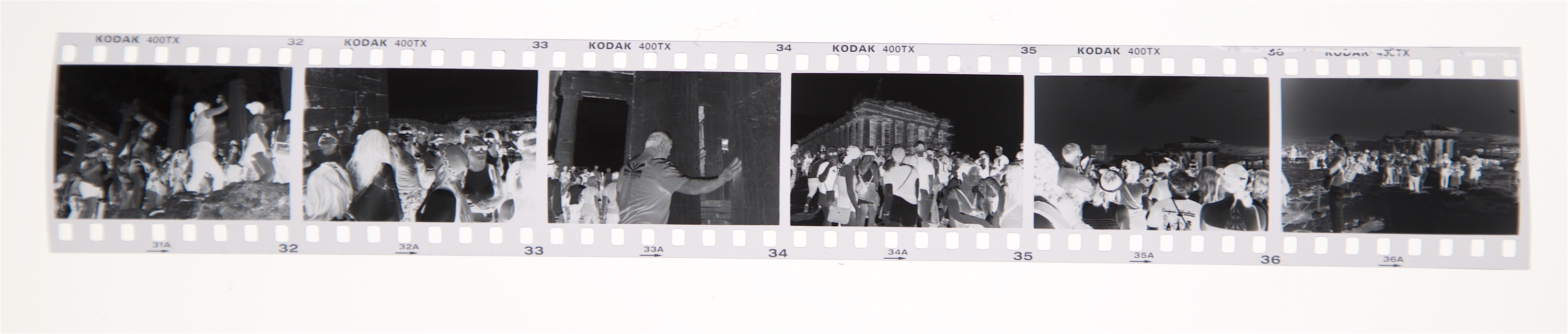

Here is one strip of the negs. It includes the photos I posted...

Thanks for posting this Phil. Those are really dense negatives! It doesn't surprise me that the scans you posted early look as strange as they do.
This article about assessing negatives may give you an idea about how negatives should appear: https://www.ephotozine.com/article/assessing-negatives-4682
Those are indeed overdeveloped. Without the 'feedback' of printing negatives, it is hard to judge what a good negative should look like. A good negative is much less contrasty than that.
