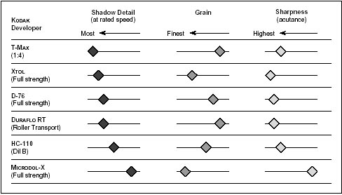

I know this graph, and it is wrong. At least for TMX in xtol 1:1 (let’s take for granted that xtol 1:1 is the same as Xtol full strength). In my experience, there is no grain to speak of. This, of course, translates into Absolutely NO acutance. Just the opposite of what the graph is trying to tell us.

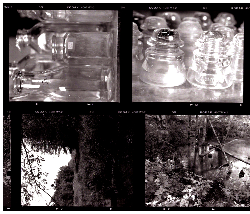

TMY-2 in X-Tol:

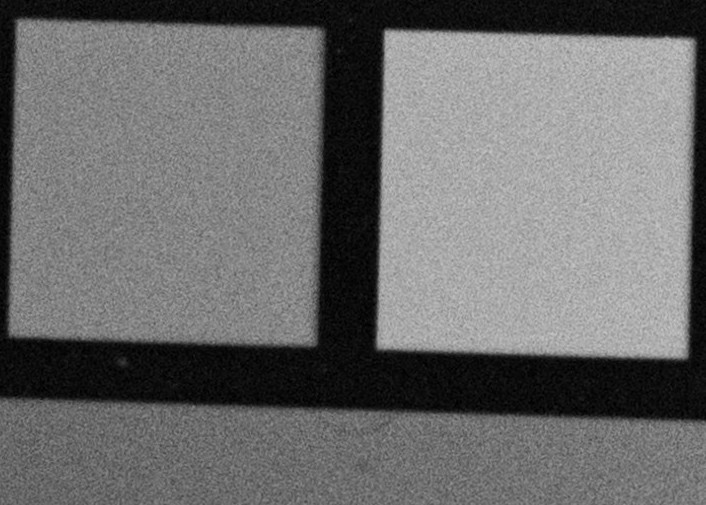

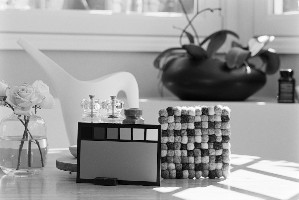

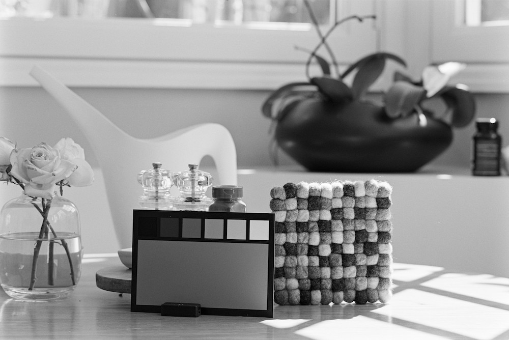

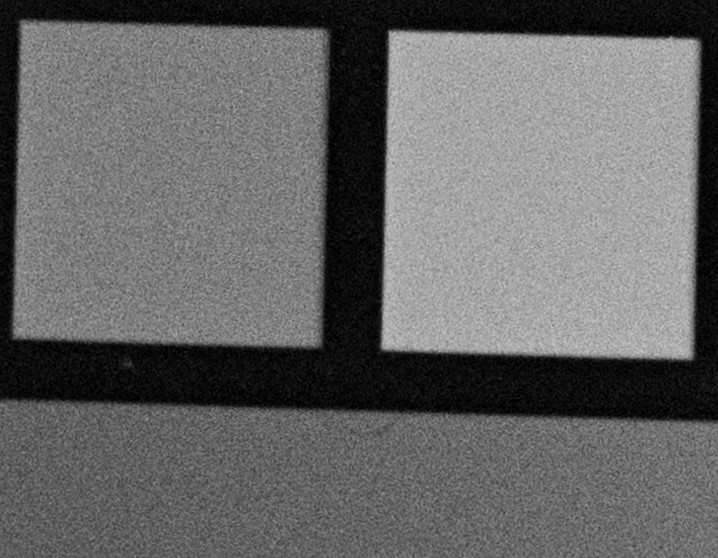

Since we're sharing samples. Here's the same TMax 400 exposure, from the same roll, developed in D76 and in replenished Xtol (100% identical scanning procedure - same gamma, white & black points)
D76
Xtol-R
If you're looking to compare the grain structure, here are 100% crops (the original images are 8,300x5,500px):
ID-11
Xtol-R
Make your own conclusions. For my purposes the differences are microscopic. I have the same scene done with all films I use, and developed in several developers, and I am in the camp of "chemistry hardly matters".
BTW, the difference between full strength Xtol, Xtol 1+1 and replenished are much smaller than D76 vs Xtol, that's why I find some of the heated archived debates on "replenishing for better tonality" completely silly.
P.S. Some disclaimers: I use automatic, repeatable agitation. The datasheet times are used for D76. The development time for Xtol-R was derived by measuring density vs D76 with a densitometer. Scanning is done with a Sony 60MP camera with gamma 1, then the same adjustment layers applied to all scans.
When you use a new film and developer combination, you test and print, it sounds like you didn't.

Are those 120 or 35mm? What are your times and contrast indexes?
McDiesel
Mar 24, 2022
322
USA
Analog
@Bill Burk This was T-Max 400 in 35mm format. ID-11 was 7min @20C, which is taken from Ilford ID-11 datasheet, with promised Gbar of 0.62.
Xtol-R was 7min @24C, the time which I arrived at by measuring densities in the target and comparing it against the ID-11 negative, in other words I tuned my XTol-R times to be simlar to stock ID-11.

Graphs are a really stupid and bias way of expressing anything. If you elongate or contract the X or Y axis, you can make anything look bad or good.
