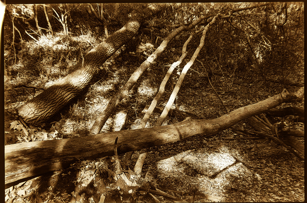

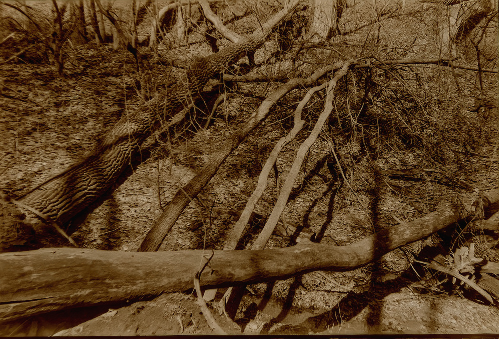

D76 vs Thornton's 2 Bath HD developer, Ilford Delta 100 in 4x5

I do see a slight difference when I switch back and forth between the two. I see it in the contrast of the belfry shutters and the shadows under the shrubs, but both pictures are very, very close for sure.
not enough difference for me to deal with a two-bath developer.
