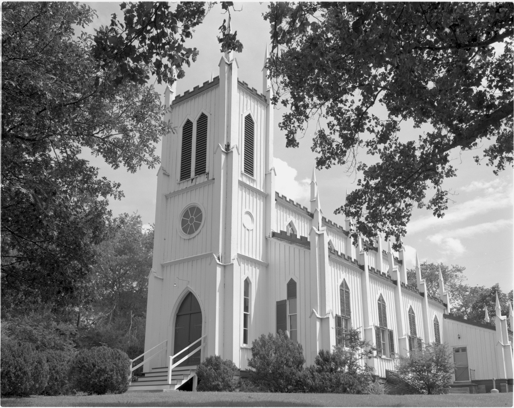

I typically take 2 shots of any subject to experiment with various development times. I was satisfied with my initial D76 1:1 @ 20c/68f for 6 minutes, so I neglected the 2nd negative until I decided to try Thornton’s 2 Bath HD developer just to see how it would handle the same exposure.
Shot #1 D76
Now, these are scans and not matched the best in curve placement, but good enough to see the differences between the developers.

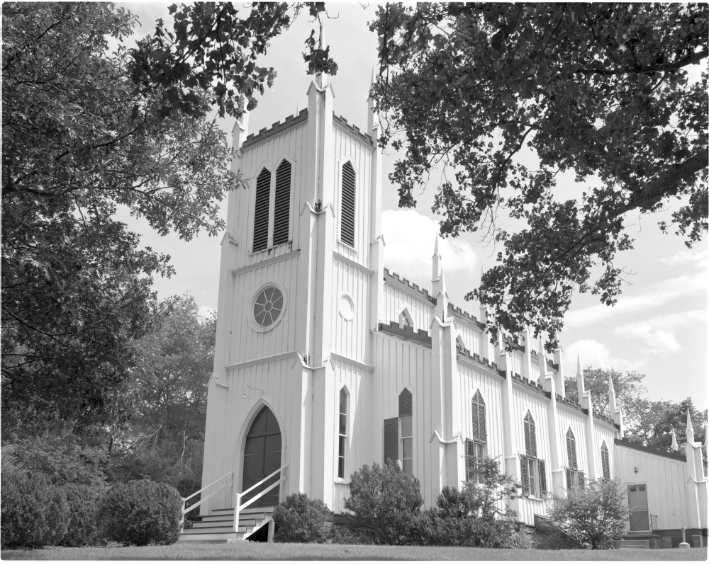

In the 2 bath, I gave baths A&B equal time at 4:30 @ 20c/68f with a water stop and TF5 fix for 4 minutes.
Shot #2 Thornton's
Since I print with a condenser enlarger, the Thornton’s neg might be easier to print closer to grade 2 than the D76 negative, which in my experience, must be printed at 1 or 1.5; maybe even lower than that.
Wonder how the negative in D76 would print split grade. Somewhat surprised that Thorton's did not separate the clouds more, , was under the impression that it was highly compensating. Nice shot though.
I do see a slight difference when I switch back and forth between the two. I see it in the contrast of the belfry shutters and the shadows under the shrubs, but both pictures are very, very close for sure.

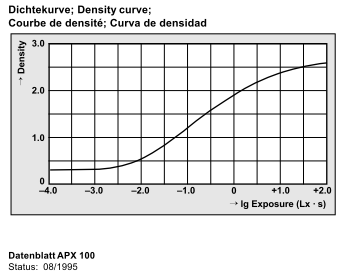

Sure, a compensating developer avoids the highlights recording as too high densities, but that is achieved by a decreased slope. Example from the datasheet of APX100 (original)

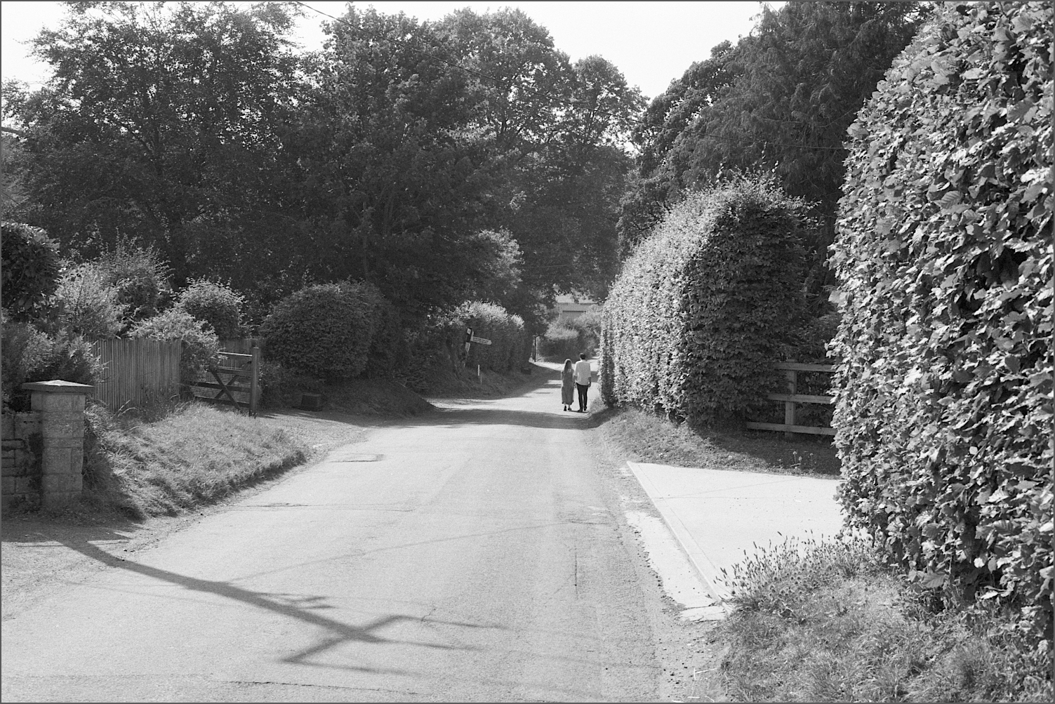

For me, BT2B has several appealing characteristics, including economy, self-sufficiency, keeping properties, and making the best of a variety of shots in different light conditions. Ease of printing is one other attraction, but I sure do appreciate not having to burn in highlights individually! This is a scan from the 35mm negative, but the detail in both the sunlit tent and the tent interior is complete in a straight print on G2.

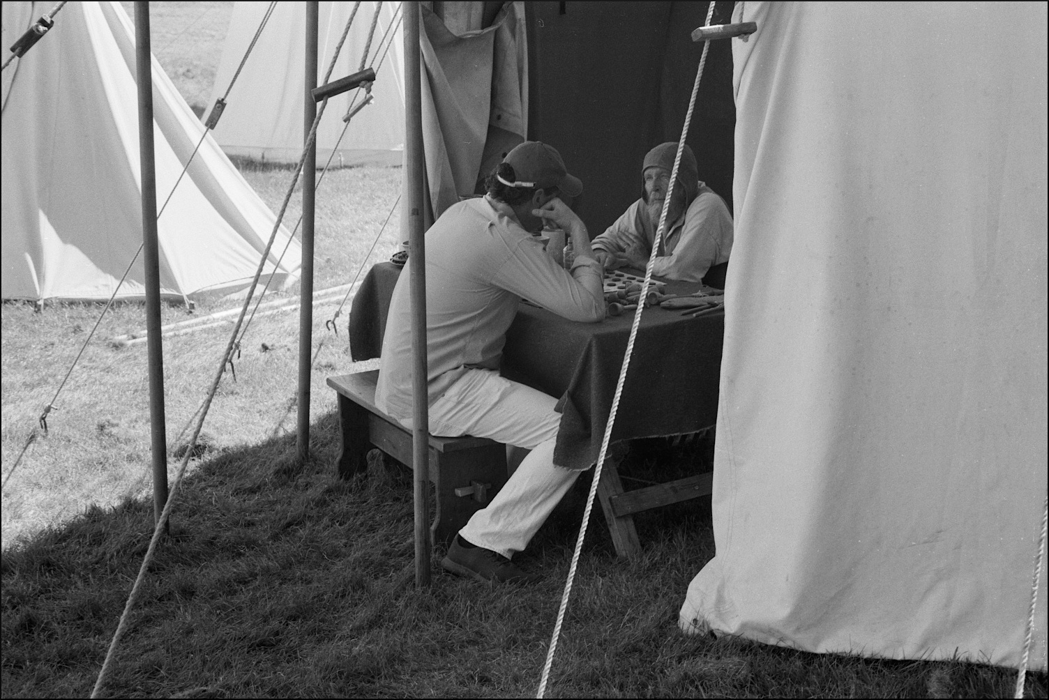

Here's another example (this is my 'Walk to Paradise Garden'!)
There's one more, fully contre-jour, example that I posted recently in another thread.
I use only BT2B now, with various film types, and for the most part I am happy with the tonality I get. I've seen other comparisons here, including curves that seem to belie the whole compensation thing, but honestly I see no downside compared with other developers. Could I achieve the same or better results with other developers? I honestly don't know. From experience with my older negatives, I believe it would involve a lot more fussing over the print.
