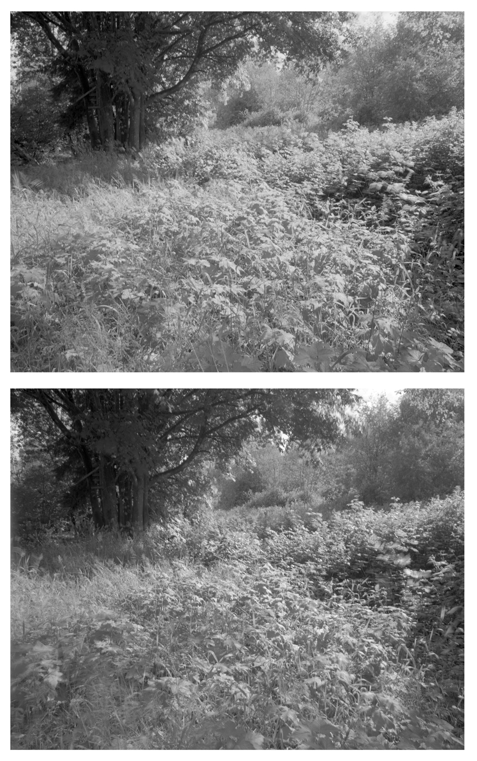

I was bored yesterday, so I thought I would revisit D-23 since I have quite a bit of sodium sulfite and metol in my darkroom. I wanted to compare it to my main developer, Pyrocat-HD. D-23 was a developer that I some experience with back in the 90's. I went out back behind my house and shot an identical scene on two sheets of 4x5 HP5. One for development in D-23 1+3, and the other for my main developer, Pyrocat-HD. It was a bright sunny afternoon (and breezy)... quite contrasty... about 7 stops between the darkest shadows and bright grass and weeds. The D-23 image is at the top. Both negatives were scanned with black and white points adjusted. I won't tell you which one I prefer... Which do you prefer?

I prefer the second one. Tonality seems more natural. The first ones highlights seem to bloom and loose detail while the second one holds the detail and doesn't blow out. Just mho.

I prefer the second one, too. Much more feeling of the light in the second vs the first.

I kind of like the top one better, because I think it favours the mid-tones very slightly. And as Andrew might recall, I am usually drawn to the mid-tones.
I'm concerned though that what I may be seeing may be due more to the combination of the scans and the Photrio uploader than the nature of the negatives themselves.

I agree that the second one has better contrast, but might this be due to the dilution of the D-23? I normally use D-23 at 1+1 which I think might have performed better here in comparison with the Pyrocat.

Can't really tale a difference, have to scroll to view each sep. It would be easier if pics were side by side to compare.

They look, if not identical, very similar. It strengthens my belief that the choice of developer has nothing to do with making a good picture.

There's more contrast in the first, better detail in the second. My experience is that's a quality of Pyrocat HD, you're far less likely to get blocked up highlights.
It's definitely a factor in helping to make good prints, but it's equally as important to have nailed the correct EI and development time regardless of developer. There are subtle differences between developers, and also film/developer combinations, it's finding what works best for you.

Comparing D-23 1+3 to pyrocat is a bit of comparing apple and oranges. D-23 is a high sulfite developer which reduces grain whereas pyrocat does the opposite.
I get excellent fine grain with Pyrocat HD, Pyrocatechin is a fine grain developing agent, I use it for all formats these days 35mm through to 10x8..
Xtol gives finer grain than ID-11/D76 or D23 and I get similar fine grain with Pyrocat HD, you wouldn't be able to tel the difference even with 16x12" prints and larger side by side, so it's only the opposite in being exteremely low in sulphite not end results. Xtol and Pyrocat HD also give sharper negatives because the Sulphite level is actually yoo high in ID-11/D76 and D23, you get better grain structure and an increase in speed and sharpness if you drop the Sulphite level to 75-80g per litre with an MQ or Metol Sulphite developer, examples are Adox Borax MQ, Agfa 44 (Agfa Ansco 17).
But at 1+3 the sulfite is at 25g/l, which is at least half the optimal concentration of 50-80g/l for solvent action surely?
(I may be misremembering of course, but I'm pretty sure I got that number from a post of Gerald's :smile:)

I find both very unsatisfactory but that may well be due to the scanning process
I would be very much interested how they actually print on conventional paper.
I suspect that's the scan and resizing, but something I've notice when adding images here and another forum that the images showing in a page are not as sharp as the same image viewed on it's own - that's with an image hosted elsewhere and linked to, this one's an attachment so uploaded to here, there have been comments about this in the past. It's something linked to the forum software.
My experience is that Pyrocat HD negatives scan easily and also print easily in the darkroom. I've been scanning negatives recently that go back over the past 30 years and there is a correlation between ease of analog printing and scanning with all the film/developer combinations I've used in that time. A friend who's an ex Ilford engineer uses a hybrid work flow, me makes negatives a touch softer than I would for darkroom printing, he's probably doing the equivalent of my N-1 development.
