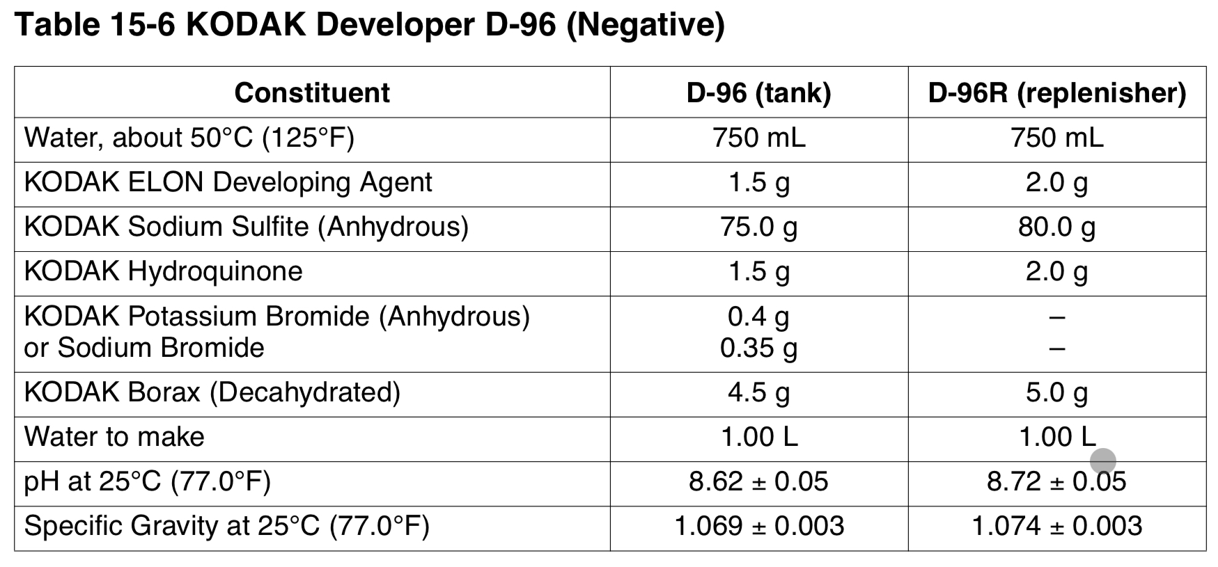

Io use the normal D.96 for develop Cinestill 200, IT work well but I would like to know if using the replenisher guarantees consistency in the result.
D96 is… not expansive. I use it one shot and mix it as I go.
Getting Hydroquinone shipped is impossible in the 50th state, so it would be very helpful if 'CineStill' could offer the replenisher alongside their packaged D 96. You may not prefer using it replenished but I do.
Excuse my ignorance: why is it impossible?

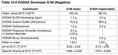

Here is the replenishment formula.
It is because of the stupid shipping regulations meant to prevent stupid people from using it as a skin lightening cosmetic treatment, so actual users of standard photographic chemistry cannot have it shipped. If its in a sealed package of D 96, sure, no problem. The same stuff packaged by itself, nope.
