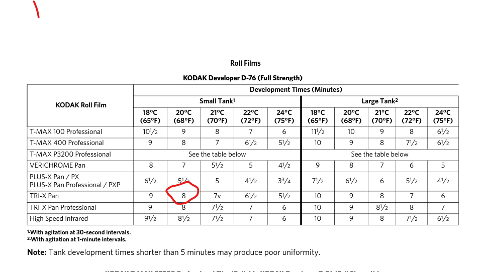

The official Kodak development times using D-76 in stock/full strength are different between the Kodak tech data sheets.
D-76 data sheet (J-78, December 2017) says 8 minutes at 20C.
Tri-X data sheet (F-4017, December 2016) says 6 3/4 minutes at 20C.
Is it correct to assume, that the D-76 data sheet of 8 minutes is for the older version of Tri-X?

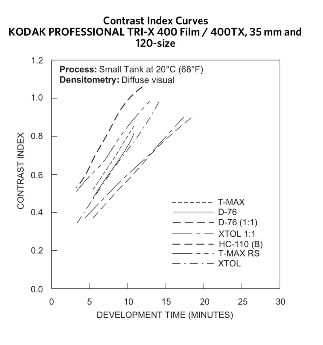

If you look at the contrast index graphs on the Tri-X datasheet, you will notice that they provide data for a number of different contrast indices. It may be the case that the tables in the two datasheets are referenced to different contrast indexes.

The time-contrast curve tells you what you can expect from different processing times without the narrative.

From the most current 2017 datasheet for D-76:
Matt, the entire point of this thread was to talk about the discrepancy between the time stated in that data sheet (which needs to be updated to say 6.75) and Kodak's own TriX data sheet (which already says 6.75 - as opposed to the old one, from the previous version of the film, which said 8).
In other words, that data sheet is wrong.

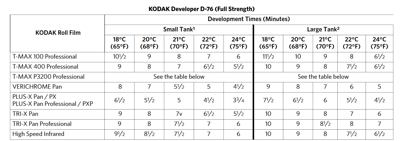

Ontario
Ok, so the data sheet is all screwed up. The time given for Tmax 100 is significantly different (2.5 minutes longer) from the time given in that film's data sheet. The time for Tmax 400 is a mere 30 seconds longer than given in that film's data sheet. And the time given for Plus-X is exactly the same.
Tell me how a "different target contrast index" explains that one.

Kodak's d76 sheet:
Kodak's Tmax 100 sheet:
Kodak's Tmax 400 sheet:
Kodak's PlusX sheet:
Kodak's TriX sheet:
Kodak's 1981 TriX sheet:

If it is different contrast indices (CI's), as MattKing suggests, I would like to think that Kodak would include this information in both data sheets. I can only find a suggested CI of 0.56 in the current Tri-X data sheet Processing section:
The following starting-point recommendations are
intended to produce a contrast index of 0.56. Make tests to
determine the best development time for your application.
I'm not knowledgable about which CI Kodak would suggest for Tri-X in 1981, hopefully that would also be 0.56, making it consistent. I'd like to believe that Kodak has the same base CI as target for different films to make comparison easier. But this may not be the case.
