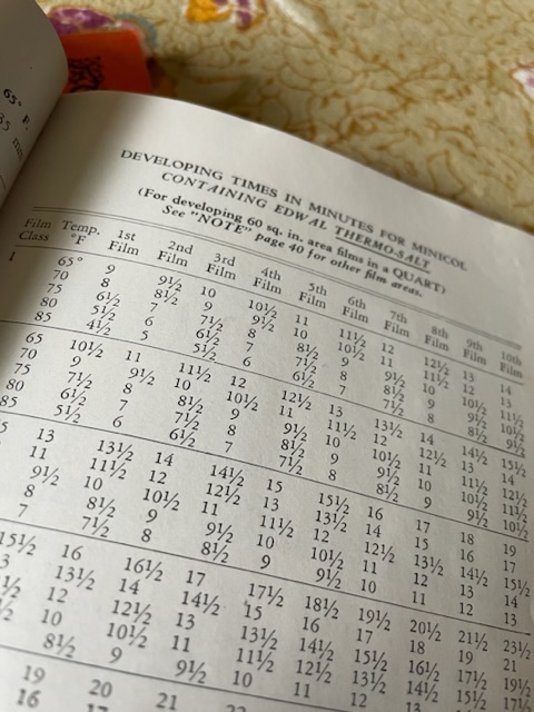

I would propose testing D-76 1:1 as fresh, 24 hours, 48 hours and a week. I don’t know if I want to do 1:2 and 1:3 and I am sure DocW already developed his film…
You know, Edwal published development times by film class, temperature and count of film put through a batch.
It seems ridiculous to me to try to predict what would happen by the tenth film, but they did it anyway.

MattKing
Apr 24, 2005
54,733
Delta, BC Canada
Bill,
Both Kodak and Ilford give recommendations for extending development as the roll count mounts for stock developers - like D-76.
Re-use of stock developer seems much less problematic than unusual use of developers that are used at much higher dilutions than are recommended.
As may be obvious, some developers are designed to be diluted - sometimes significantly and over a wide variety of dilutions - while others are designed to be used at or near a standard dilution. Some developers are quite robust when highly diluted while others deteriorate quickly when diluted. HC-110 is an example of the former and, I would suggest, D-76 is an example of the latter.
