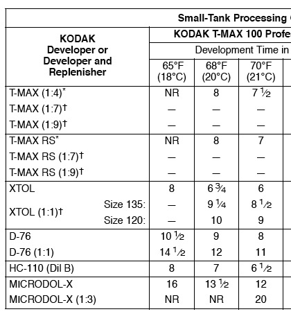

I see it that way too, but unfortunately, that's not the way Kodak sees it. See attached clip from their tech-pub F32, listing D76 and D76 1:1 separately, so apparently, not the same thing to them.
Unfortunately Kodak have used both ways over the years which is rather misleading and so they are technically wrong. In older publications they were much more precise and correct specifying 1 part D76 + 1 part water etc.
1:10 means 1 part made up to 10, Ilford make it clearer by saying 1+9, 1+19 etc. In science and medicine 1:100 means dilute 1 part to 100 total, so there's no such thing as 1:1, its FS.
