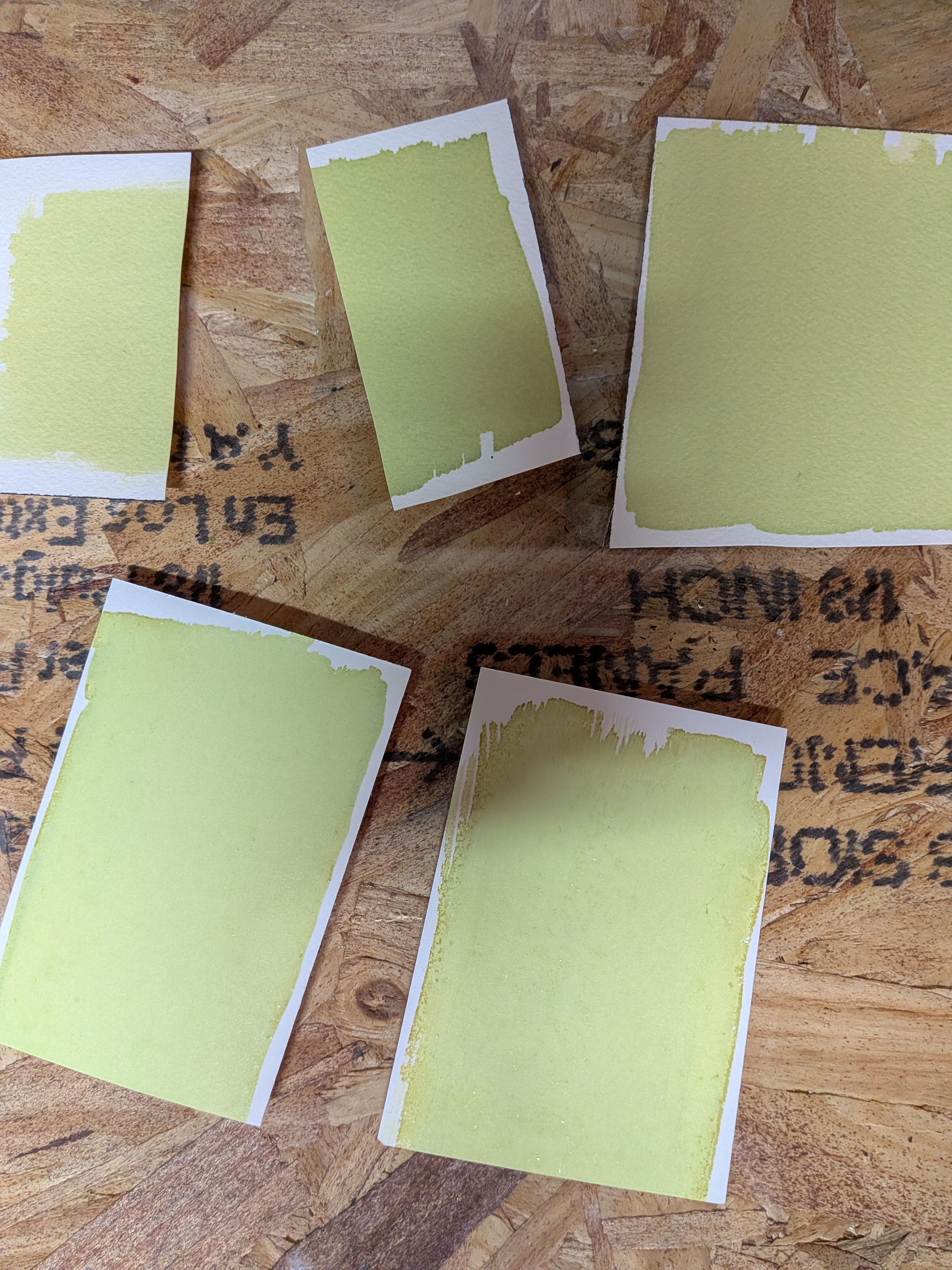

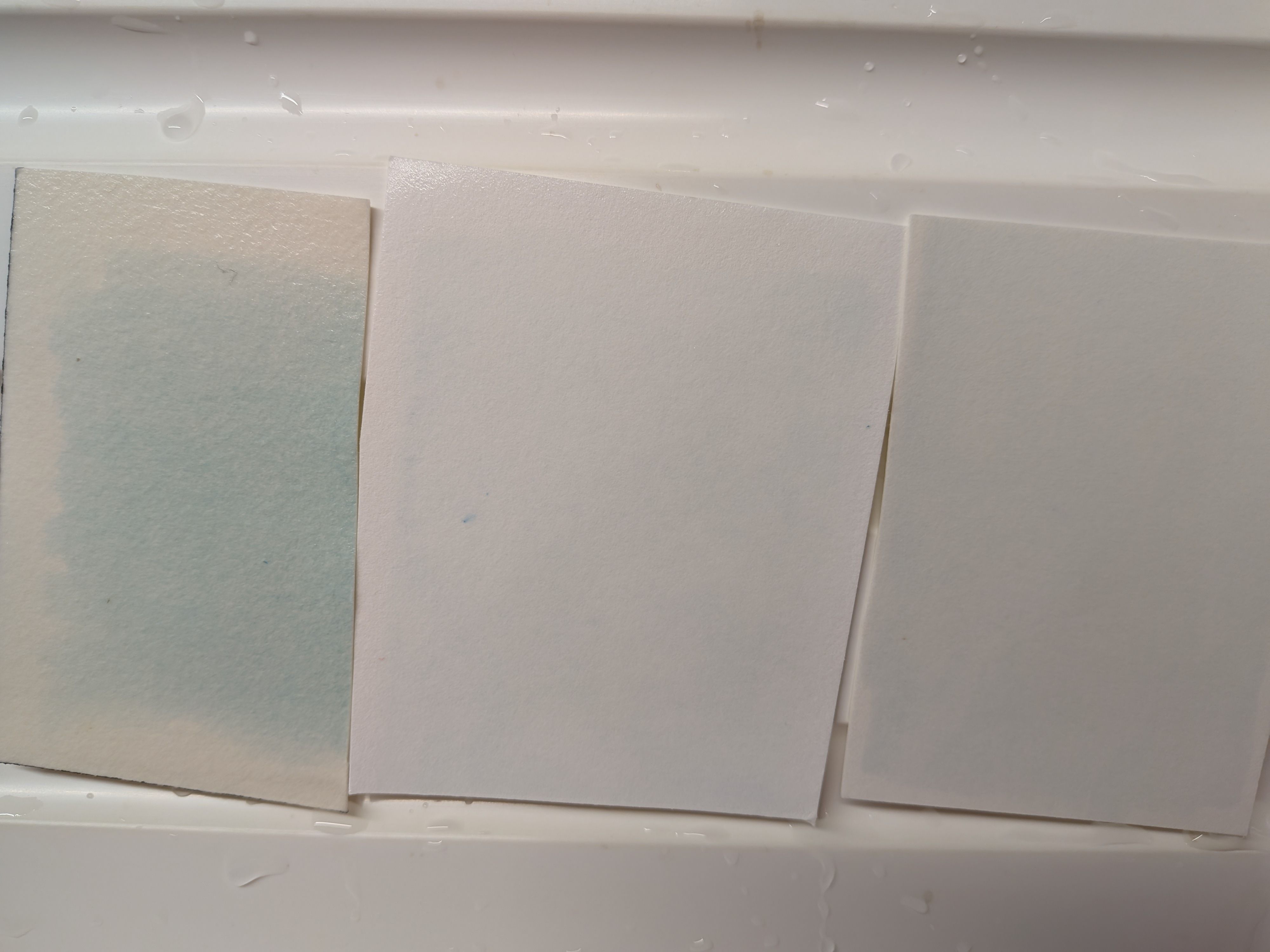

I'm using Mike Ware's cyanotype formula and mixed it per his instructions. I am omitting the dichromate from the formula.
I've been careful to mix the solution under an incandescent bug light to prevent fogging of the solution and I'm using distilled water.
My solution is emerald green in the bottle and my coated paper is a strong yellow-green color. This is at odds with Mike Ware's description of lemon yellow when coated on the paper.
If I coat the paper then attempt to clear it immediately upon drying with no exposure to blue or UV light, I still get some blue in the paper that does not completely clear out.
I've gotten this result with Arches Aquarelle cold press, Hahnemühle Platinum Rag, and Legion Revere Platinum. The Arches Aquarelle is the worst of the three. I've added a drop of 40% citric acid per milliliter of solution per Christina Anderson's Cyanotype book. This does not seem to yield any change.
What could I be doing wrong here?

From look of the things, that does not bode well for the sensitizer. Somehow it might have been compromised while you were making it. I don't know if you want to mess with this or make a new batch. Potentially if there was any ferrous formed in the sensitizer, it can be reverted by addition of hydrogen peroxide.

So the new cyanotype sensitizer isn't supposed to be this green? I've watched Bill Schwab's video on youtube (link below) and I think I've mixed my solutions the same way, but with perhaps a bit more heat and precision? The way he heats the solution seems a bit loose.
This is actually my second batch I've made. I thought the same thing, thinking I messed something up since I used tap water and some brighter led lights to illuminate my work space. The second bath I used distilled water and mixed the solutions under an incandescent bug light to ensure it wasn't tap water contamination or my lights exposing the solution. From my testing both the first and second batch appear to be the same.
I'm not really sure how I can mix it any better than I have. I'm using clean beakers and a hot plate. My thermometer is probably not the most suitable, but I figured it should be close enough. At lease closer than how Bill Schwab was doing it.
Still assuming that something is going wrong if even HPR is fogging a little bit.

I don't know what your sensitizer looks like, but what I see mostly is what might be a healthy sensitizer applied to a paper that's just not suitable (without neutralization) for this process.
I'd strongly suggest setting New Cyanotype aside as it's just unnecessarily fussy and problematic. That's just my private opinion though.
Hahnemuhle PR should work right out of the package, with no pre-acidifying required. I abandoned the New Cyanotype, and went back to traditional formula. It was just too finicky. Mix some up and try it. If it works, then there is something wrong with your mixture of New Cyanotype.
Okay, see how that goes. Don't forget what I said about the rinse after exposure. Citric acid etc. is not sufficient for this in my experience. Try dilute hydrochloric acid.

So I think I might have found the problem. I'm still waiting on some paper to dry to further validate, but I think it might be my coffee filters causing issues. Per Mike Ware's instructions I filtered the solution through a coffee filter to remove any crystals. Through some more testing and trying to perform more filtering of the solution I noticed that the filter paper was turning blue and after a few passes through the filters that the solution now has a blue hue to it.
Remember I made two batches of this stuff, the one that went through extra filtration is most definitely a different color now when compared to the other.

Well I just mixed up another bath. It's cooling now and needs to rest for a few hours. I'm going to just carefully decant this one and bypass using the coffee filter.
At this point I'm somewhat confident that the filters were part of the problem. Again the solution I filtered several times started turning a blue-green rather than yellow-green. But I'll report back with my findings!

Update: It was the coffee filters...
Something about the composition of the coffee filters I have is chemically disagreeable with the new cyanotype formula. It seems to be producing prussian blue when coming into contact with the filter and that is getting into the solution. The more I use those filters, the more contaminated it gets.
So just decanting the solution instead of filtering it has solved that problem. I now get NO blue stain when using HPR after a thorough washing.
