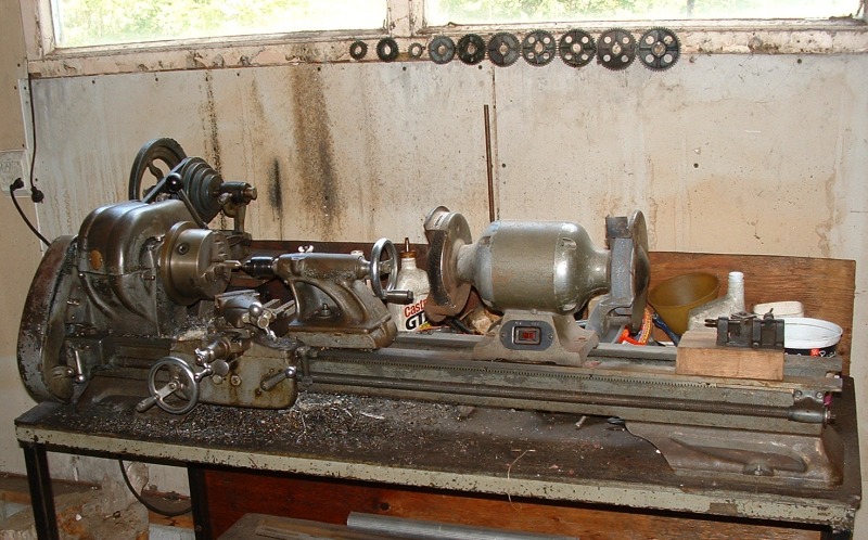

You men like this one :tongue: ? : ( I don't like cutting wood on it - too messy with sawdust sticking to the oil and grease)
If you mount your grinder on the cross slide, you can also do external cylindrical grinding.:smile:
