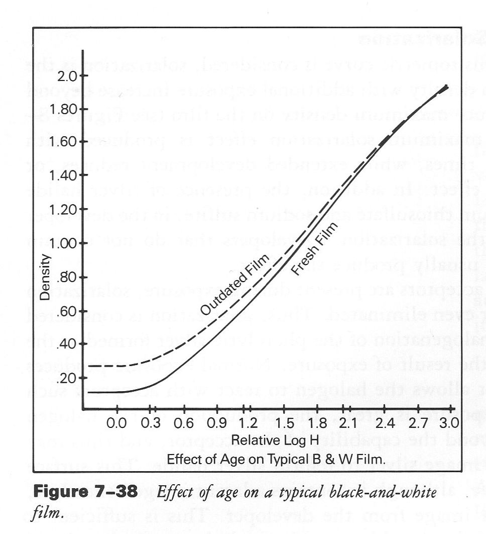

I have found this plot of the curve. It's a theoretical curve but it shows the general effect (Photographic Materials and Processes, Stroebel, Compton, Current, Zakia, Focal Press, 1986, p. 282).
aparat,
Your chart shows the effect of age fogging on film, and rather generally at that. The difference in the curves at the low end is attributable to fogging, not latent image degradation, which is a different thing entirely.

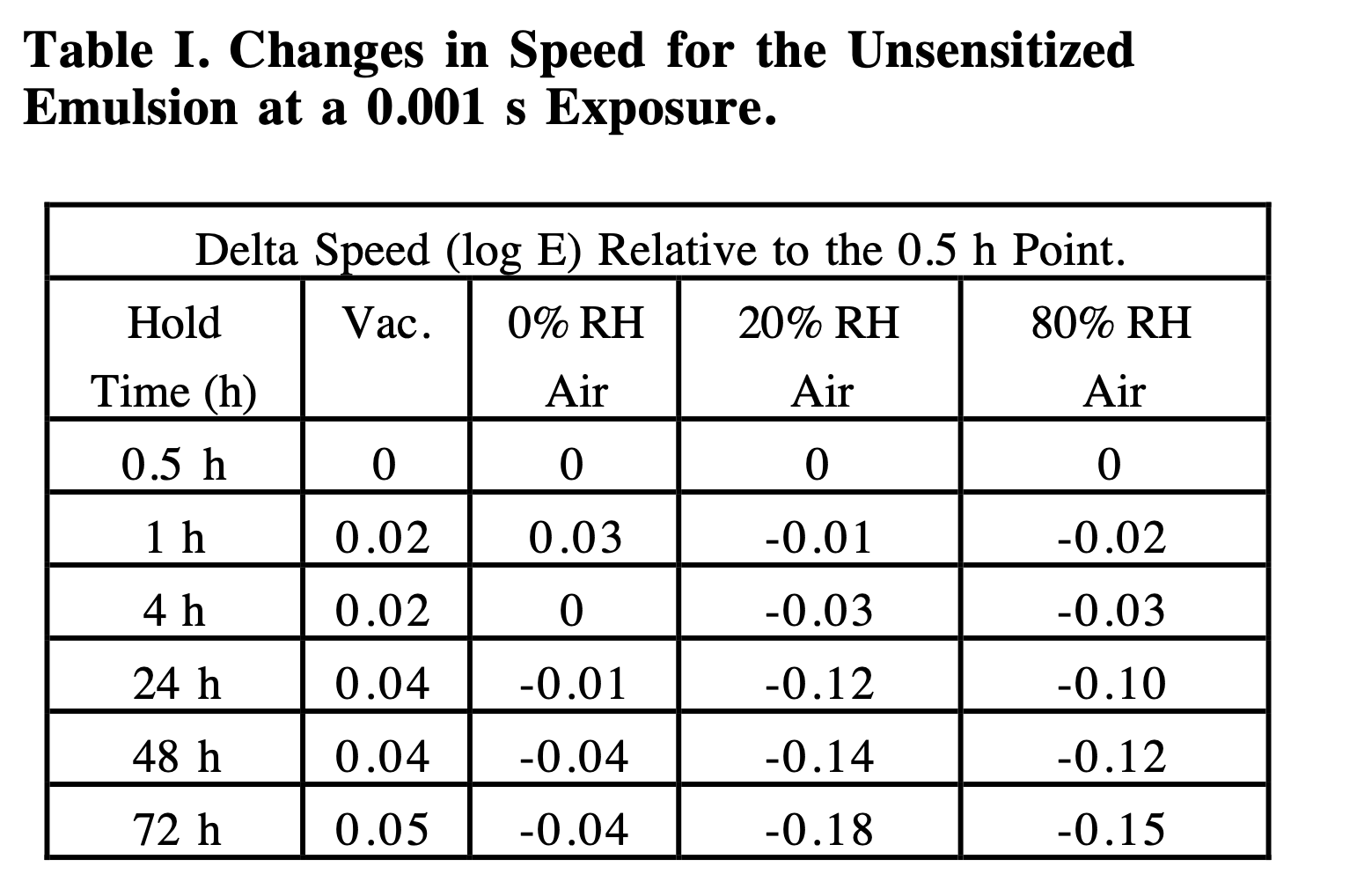

I don't have a curve, per say, but you could make one from this data:
The table shows, for example, a mid value (0.5 h Point) can lose one-half stop (0.15 log E) if held in an 80% humid 20% oxygen/70% nitrogen environment for 72 hours.
Likewise, film held in a vacuum for 72 hours can gain 1/6 stop (0.05 Log E).
IS&T’s 1999 PICS Conference
The Effect of Environment on Latent Image Formation and Stability
Sean W. P. O’Toole Eastman Kodak Company Rochester New Y ork
It is labeled in such a way that it can be misleading. As I mentioned, the curve is theoretical and only shows the "gross" effect for comparison's sake. Here's the quote that accompanies the plot:
"Since the latent image consists of a cluster of silver atoms, the loss of only a few atoms may render a silver halide grain undevelopable, An atom of silver can combine with an atom of bromine, for example, to form a molecule of silver bromide - reversing the effect of exposure. After long periods of time the image, when developed, may have less contrast and be less distinct due to the spontaneous development of a large number of unexposed silver halide grains. As this type of development fog increases, a point is reached where the developed latent image can no longer be detected. A small amount of development fog, however, can produce the effect of increasing the speed of photographic emulsion and the density of the developed latent image in the same manner as latensification."​
Hi, I don't know if you have a copy of the full paper for this, but if not, it's worth pointing out that the table you are using was for a hand-made emulsion that was specifically not sensitized. So it's very unlikely to behave like a real-world emulsion.
In fact, in the Abstract the authors say, "The unsensitized emulsion was the most sensitive to environment while the sulfur-plus-gold-sennsitized was not."
As a long-time on and off member of the IS&T I learned that one has to be careful interpreting these papers.
I don't think your plot is on latent image regression put on film age. To compel the required by the OP it will take a lot of film in a lot of time; not sure anybody would invest there knowing that development should be done as soon as possible.
No, it's not. As I explained later in the thread, the authors of the book used that plot to illustrate the general effect of the reduction of contrast and build up of fog. The labeling is unfortunate, I agree. I also agree that to test current emulsions in current developers would take a lot of work.

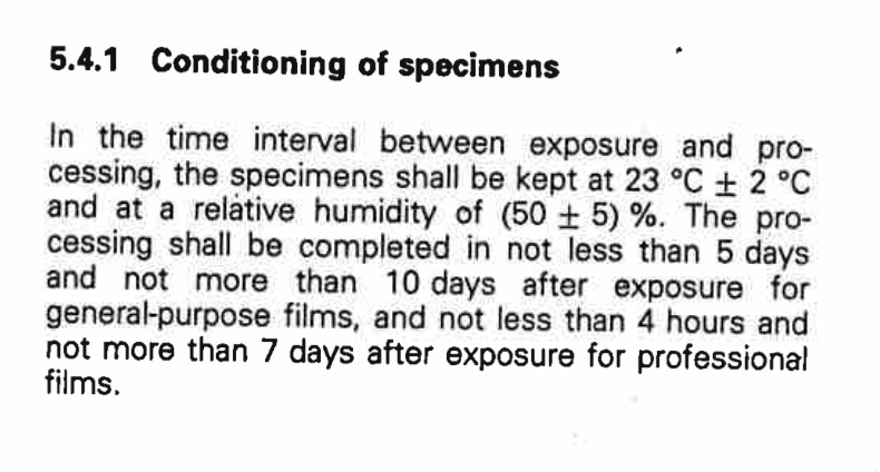

ISO 6 changed the hold time from greater than one hour and less than two to not less than 5 days and not more than 10 days after exposure for general purpose films and not less than four hours and not more than 7 days for professional films. Anybody remember seeing anything about hold time with Zone System testing?

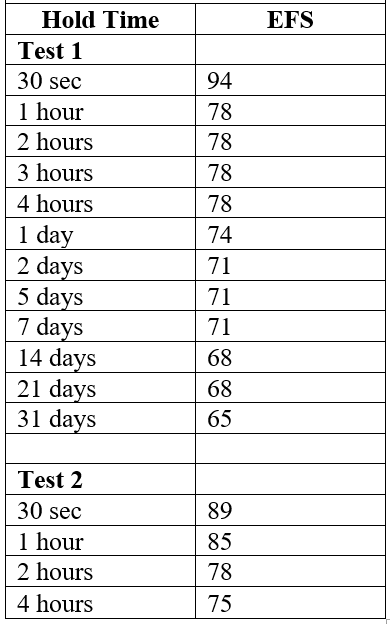

I did a latent image test and then repeated it to confirm. These are the resulting times and speeds with 35mm TMX processed in seasoned T-Max R/S with a Refrema dip & dunk. Exposed using a calibrated EG&G Sensitometer and read on a MacBeth densitometer. For this type of test, I believe, the equipment needs to be more precise.
Why would film get faster by simply being stored in a vacuum after exposure‽
First I ever heard of this effect.
Lots of interesting thoughts and ideas here guys. Thanks.
Please keep going if you see fit.
Half a stop is nothing to sneeze at. And fast development can be used accumulatively with other methods to gain extra speed if need be.
One conclusion is that the vacuum removes oxygen from the emulsion. With less oxygen, less degradation of latent image and greater speed.
The highlighted portion in the text you posted above describes age fogging due to "spontaneous development of a large number of unexposed silver halide grains." That really has nothing to do with latent image degradation, which is described in the first sentence. The graph itself shows age fog degradation, i.e., a boosting of the shadow values due to the fogging. Latent image degradation would affect the highlights proportionally more. This is not shown on the graph.
It looks like the difference in film speeds at both ends amounts to about 2/3 stop. Less if one considers that film is rarely (if ever) processed within 30 seconds of exposure in practice. The difference between one hour and 31 days is about 1/3 stop. Not a lot of incentive to rush to develop the film, especially if one gives an extra 1/3 stop exposure when making the negative.
That said, I believe there are other films that show more latent image degradation than the one you tested, e.g., Ilford Pan-F.
